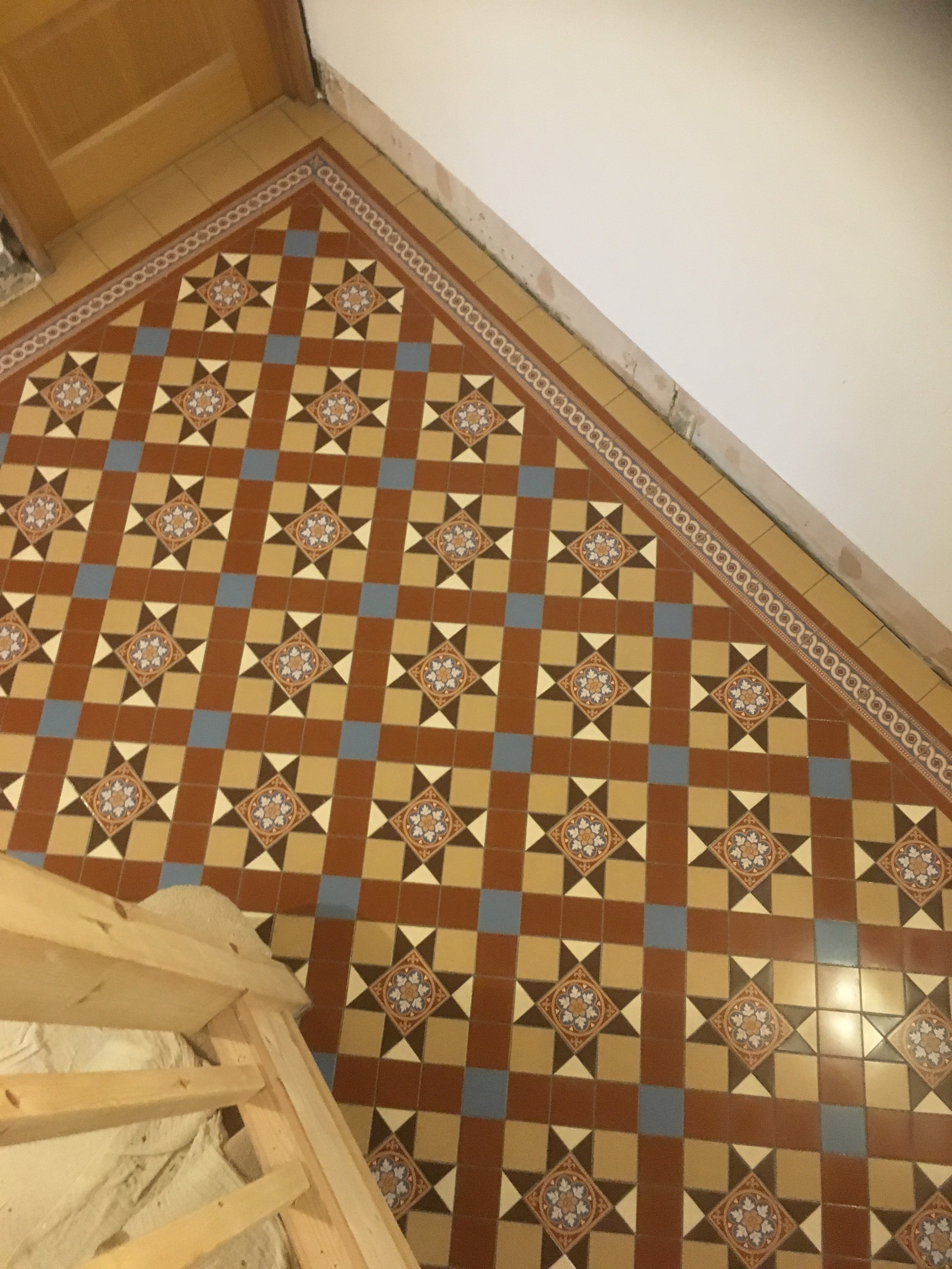

58423366-DF68-4104-B799-6C4B5DEE1ECB.jpeg Grouted in Tilemaster 3000 natural grey.
