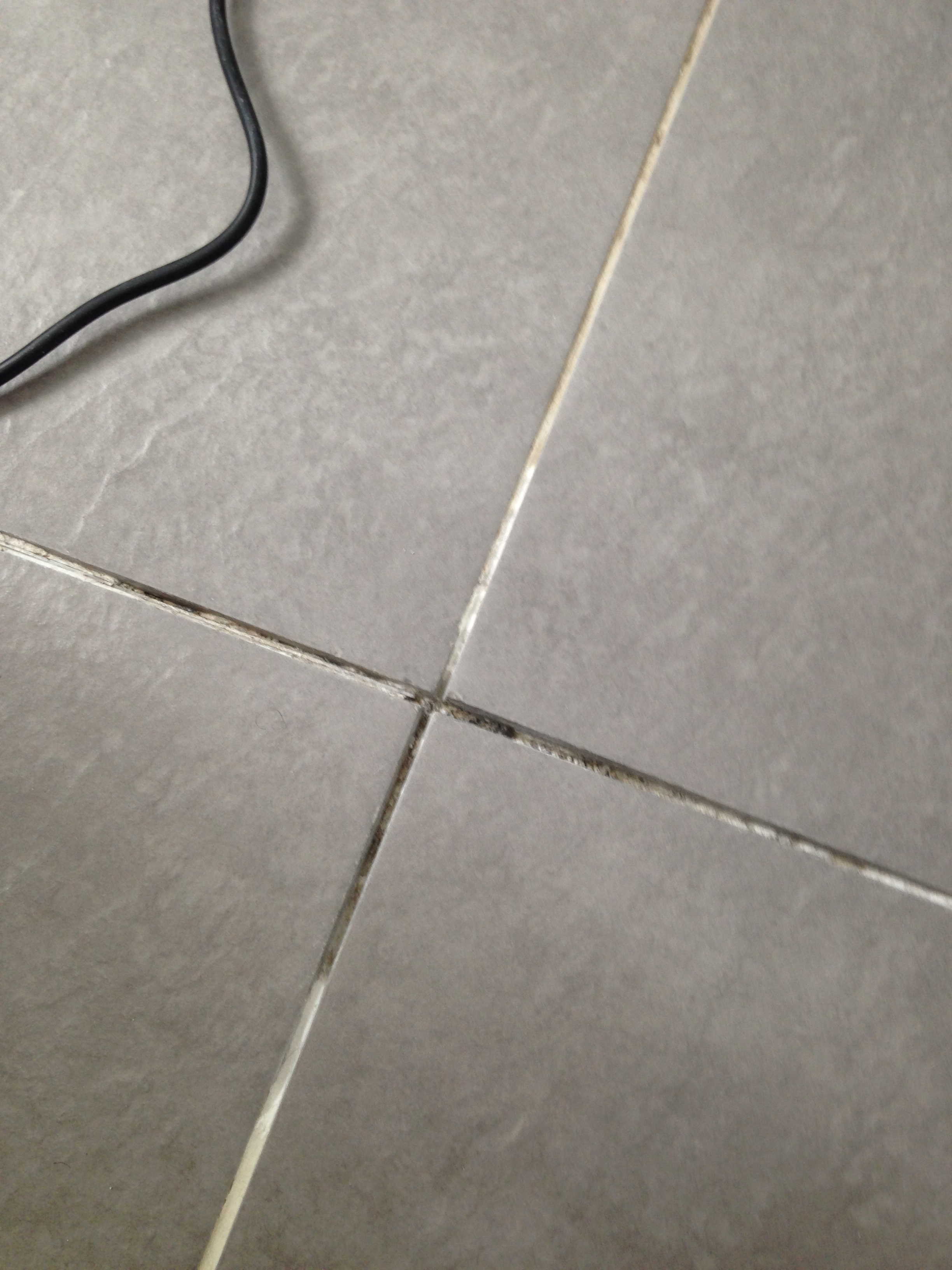

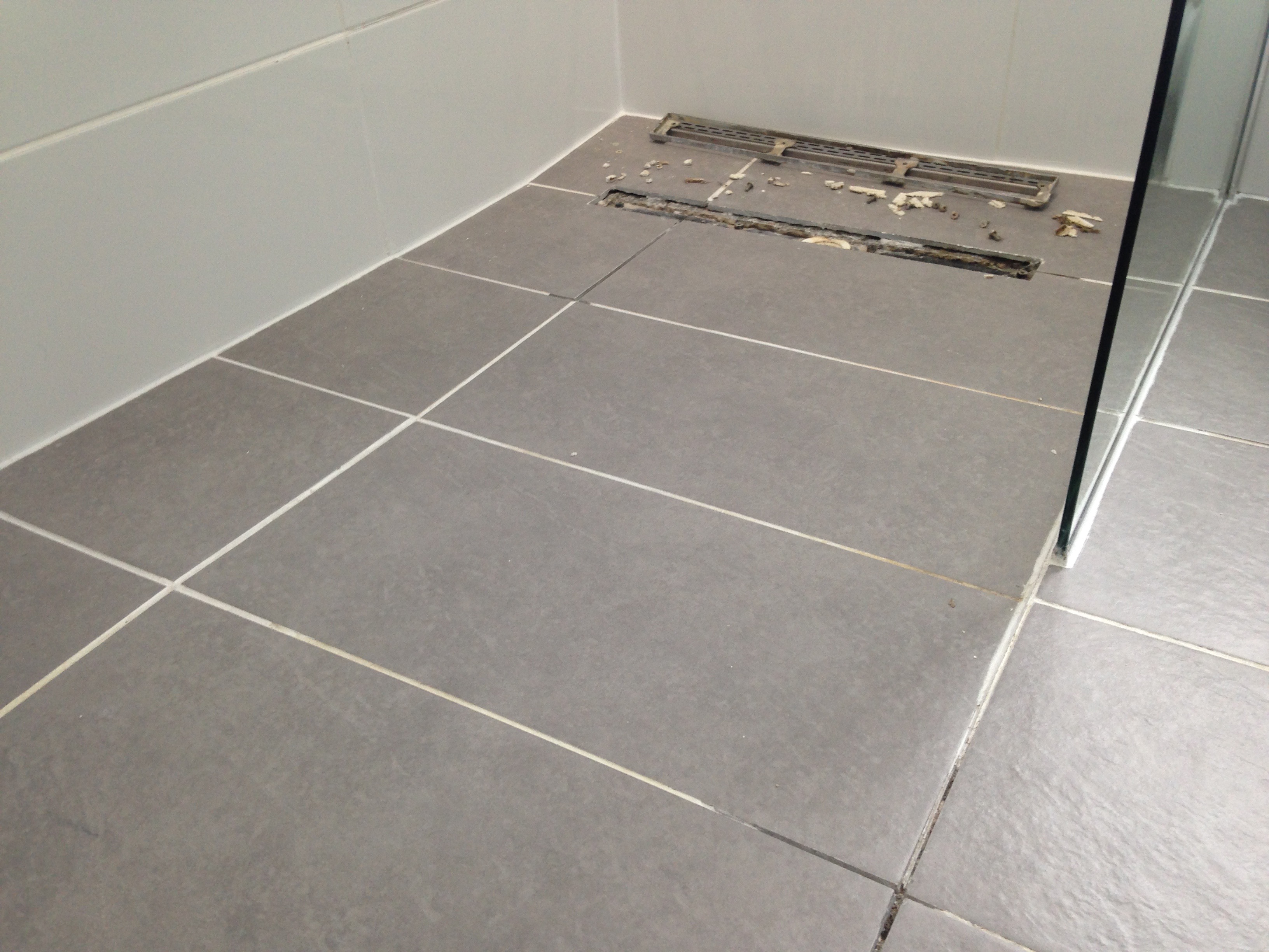

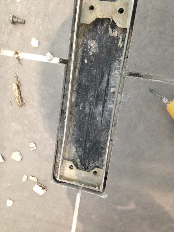

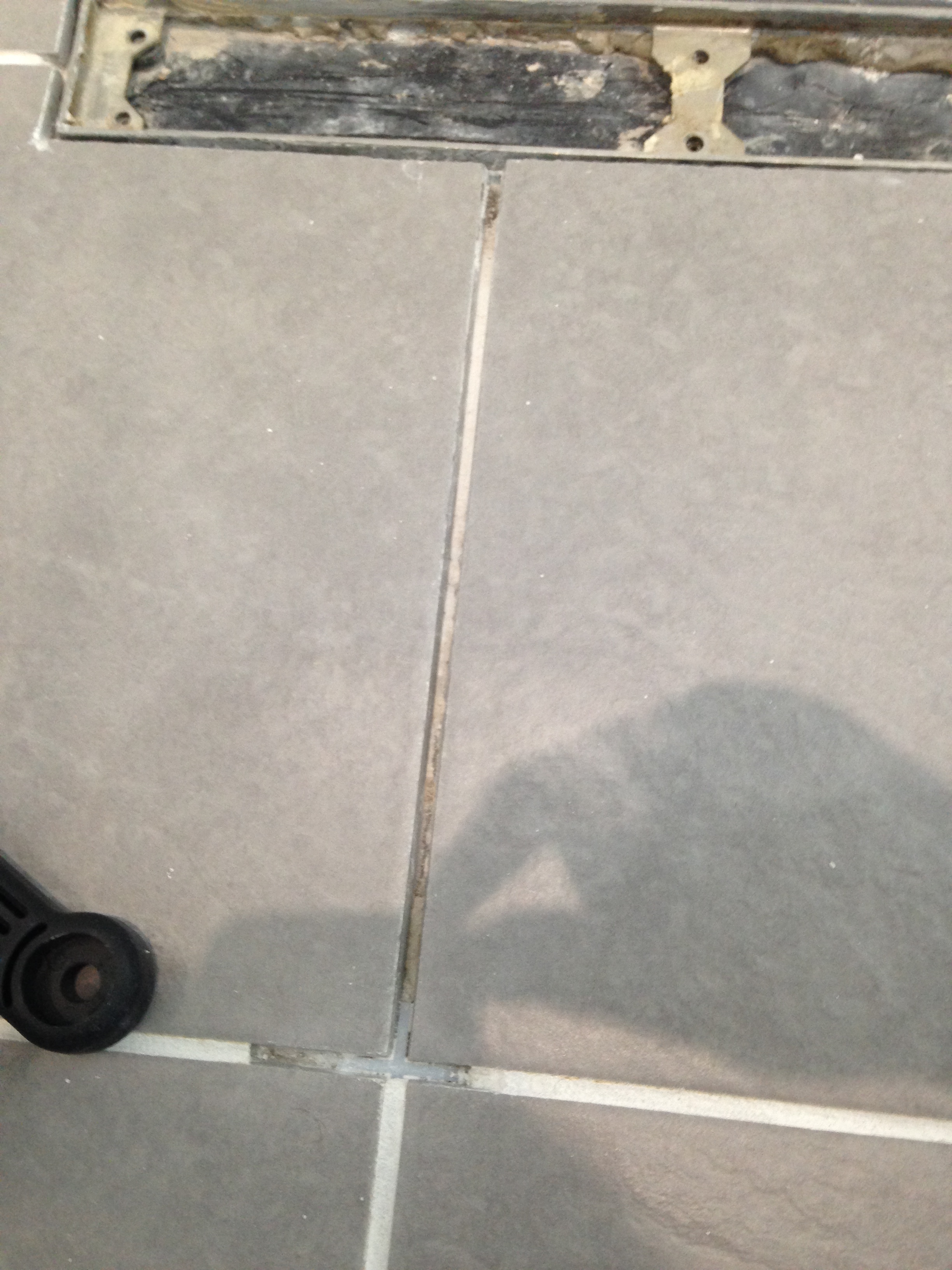

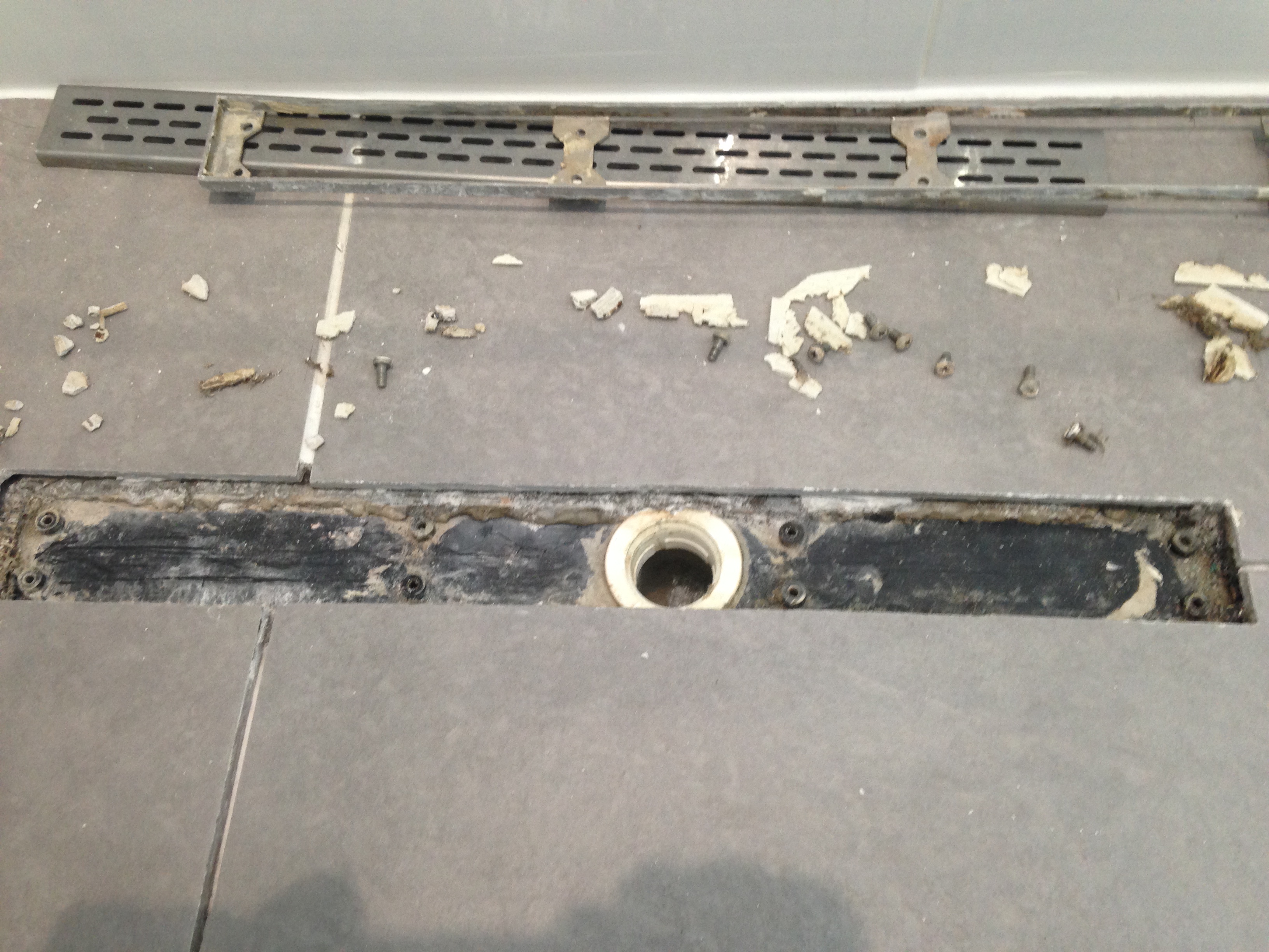

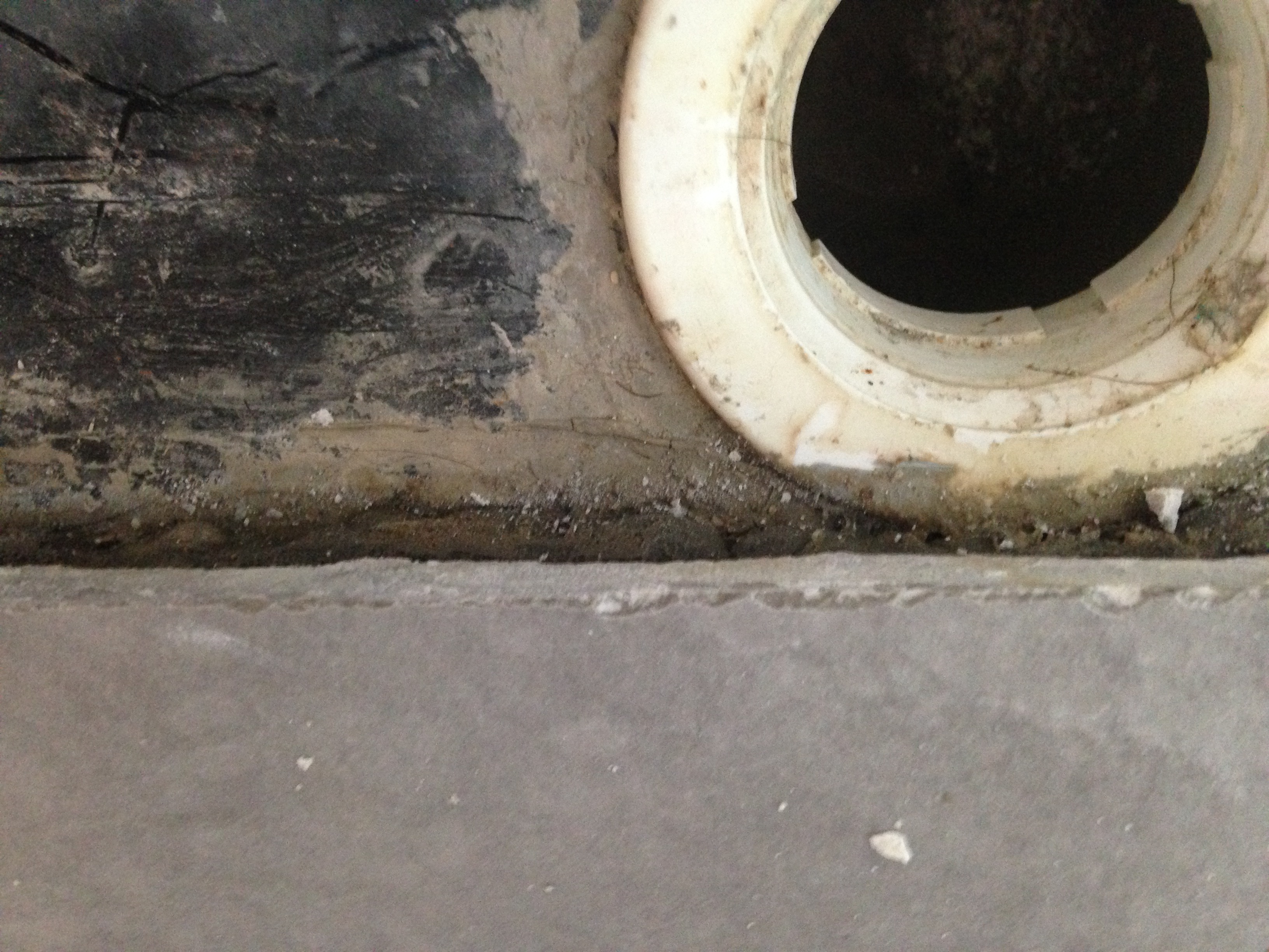

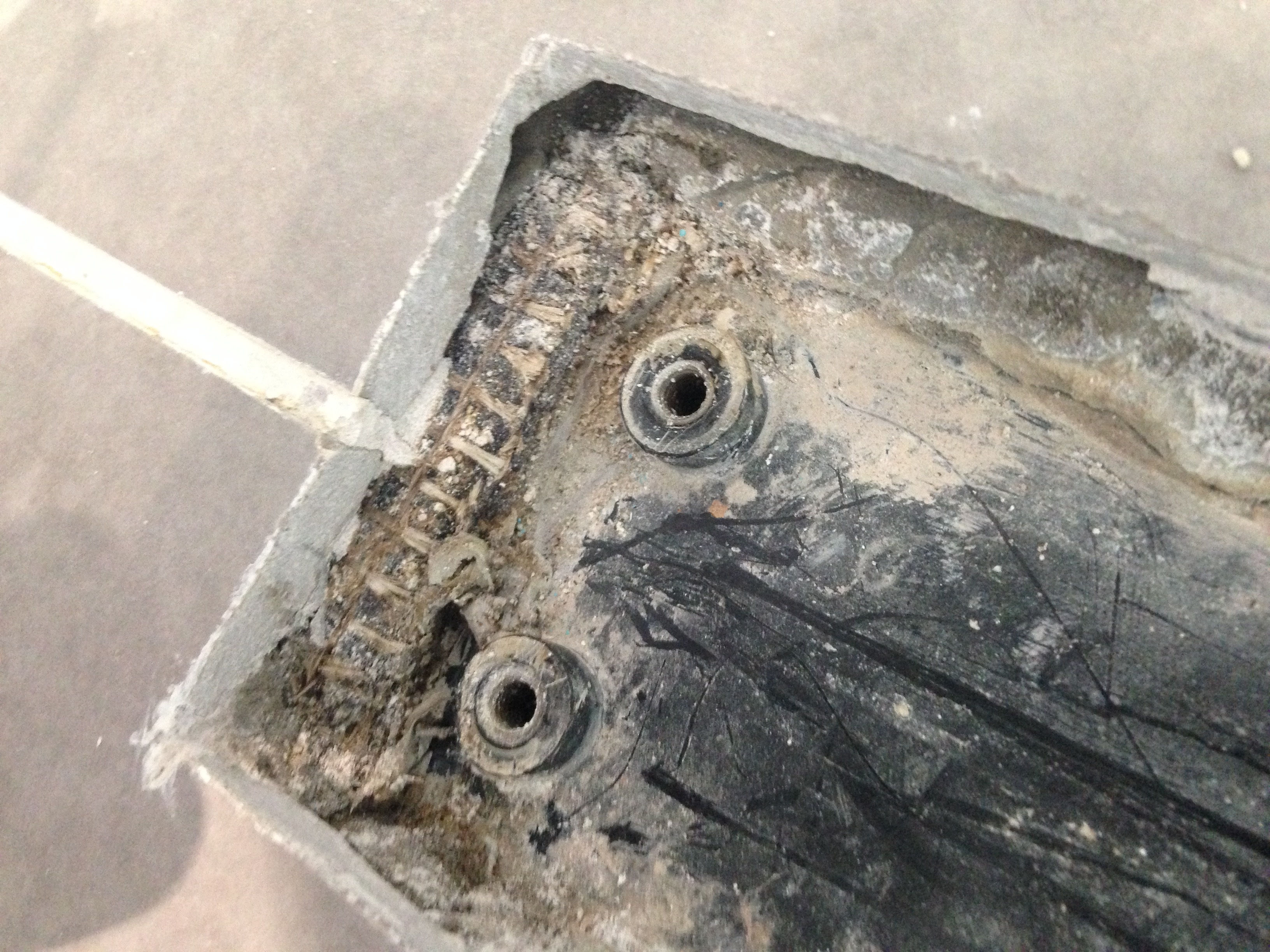

Sure, here are some pictures - Sunday morning is DIY morning 🙂
around the drain there was cracked grout so i removed the metal insert (held in place in the screw holes) then the grout came off easily. One of the close up pictures shows there appears to be some sort of membrane under the tiles but also some gaps, should i push some grout in there first to fill the gap? Should any of this 'tray' be sealed first?
The other pictures are of the other areas where there was cracked grout, should be straight forward to just push thick grout into.
Advice much appreciated!
Phil
View attachment 76894 View attachment 76895 View attachment 76896 View attachment 76897 View attachment 76898 View attachment 76899
Get a tiler round Phil Looks like there may be some movement
Thanks, can u do couple to show the room pls and where things relate to each other.
Close ups are good tho

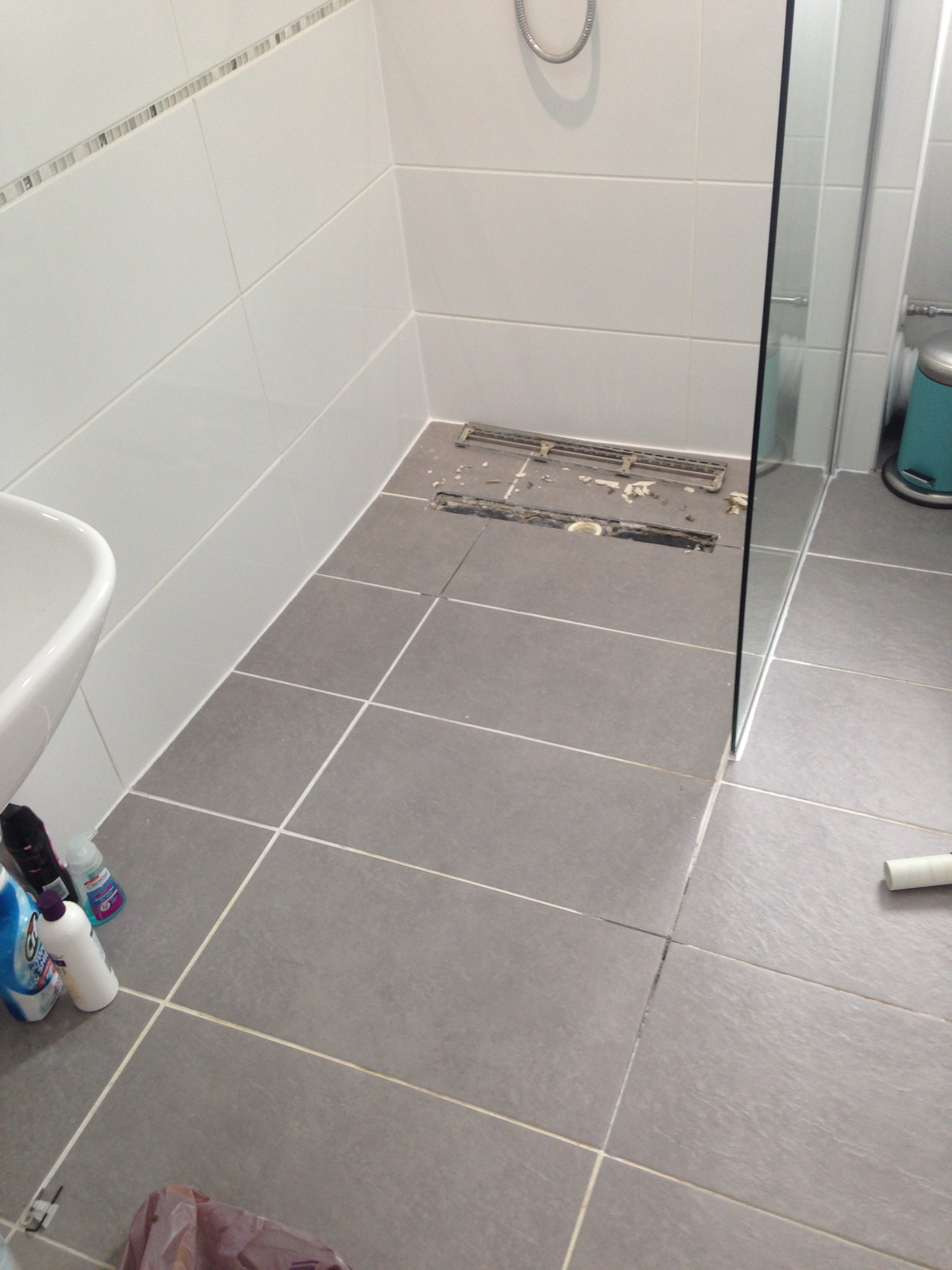

here are two photos of the room. The shower has a slight decline towards the drain, starting from just before the glass window starts.
It looks like there's movement on the former tray to floor transition by the screen.
If that was my shower floor it'd be screen out, and 5 tiles on that screen line and the cut tile to left would be straight out.
Inspect former and drainage for damage and if poss re tank and re tile.
Well if it's a recurring problem I'd go for movement. Drain not looking it's best and missing grout just in front.
The bit on the floor tray to floor transition was where I've raked out, but it was cracking there though.
Looks like a Novallini shower former.
Its a foam tray with cement faces. Needs proper support underneath and on the transitions to the rest of the floor. Tray looks to be a 1200mm x 900mm where after that the grout looks sound. I would be with the others in saying it is movement.
