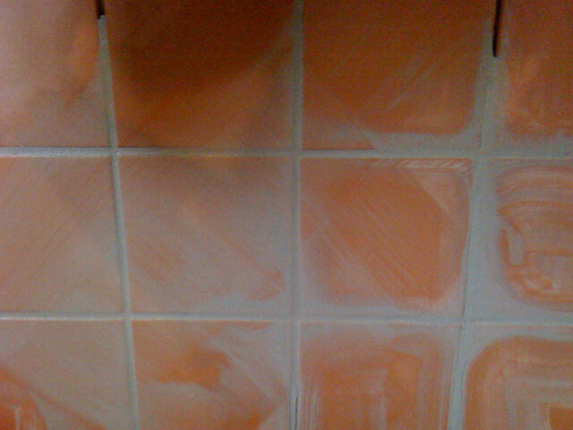

Hi folks, I hope you can help me as I've spent the last 3 months digging out and replacing my kitchen floor with an insulated concrete slab, dpm and tiling it, all myself, only to fall at the last hurdle... grouting.
I'm using these tiles which Wickes claim to be porcelain. I've laid them using BAL rapidset and am attempting to grout them using BAL Superflex Wide Joint GREY powdered grout, which I'm mixing up using a scale to get the proportions spot on, so here's the crack:
1. It's seriously runny. No need to 'push' into the joints, it just runs in to them. Is this right? I've done two test areas so far with the same results.
2. The tiles have a matt, slightly grainy finish which seems to catch and grab on to the grout so I can't get them very clean with the grout float.
3. It's taking an age to set... I can't sponge them after 10 or 15 minutes. I waited over an hour to sponge them for the first time and it was still just smearing more grout over the tiles. I don't want to overwork or over-wet the grout (this pulls the latex or polymers up to the surface yes?), nor pull it all out of the joints so after a second unsatisfactory sponge an hour later I just had to leave it.
4. 24 hours later, it's set but looking a bit light in colour to me; first though, I have to clean the tiles. Water's not shifting it, so I'm using Fila grout residue remove at 1:10 which seems to clean the tiles ok but my grey grout now seems even lighter and a bit patchy now too...
All I want is a nice mid grey grout between my tiles... Can anyone please help me?!?! I'm running out of test areas, and have read that darker grouts are difficult to work with, though I'm not sure I should need one anyway; the stuff just doesn't seem to behave as it says on the bag or as I've read in this and other forums!
Cheers.
Some pictures, as I know how much you love them:
First one after removing excess with the grout float. It realy clings to the tiles.
Next, after a second sponge down nearly two hours later - one wipe with a spotlessly clean sponge is enough to smear it (i'm using two buckets etc)
Third, next day, cleaned the tiles, but should the grout be this light? it's patchy too, though the photo's too small to show it.

Two test areas so far, same runny grout in both and both very light. The difference was that I over sponged the first one while it was wet, which I thought might be why it went so light. The next one I bought some grout residue remover so I could leave it messy and avoid over sponging it, then clean up the next day. It may be slightly darker than the first, but there's not much in it, and it's had a day less to dry out too.
If over wet grout causes it to dry too light then that would explain both patches, but as I said, I did follow the instructions on the bag. Both times.

i've used the superflex grey and it does dry light, almost as light as cement probably. sometimes the grout in the joint takes a while to go off due to absorbancies in the tile and substrate but goes off quick on the surface of the tile and this can be hard to clean off. a washboy makes this easier
Thanks Mike, that's helpful.
Porcelain tiles, which I'd applied a stain protector to would be very non-absorbent causing the joints to set slowly while the thin smear on the surface would still go off. And maybe the grey is just lighter than I'd prefer. I wish they'd make a proper mid-grey then as there's nothing between that and the charcoal/ebony end of the scale which is all but black. Maybe that dries lighter too though?
Still a bit miffed by the runny consistency at recommended ratios but at least I know now.

you might want to mix up the grout then wait ten minutes, check how stiff it is , it should be quite firm like butter, dont worry just mix it up again dont add anything and you will find that it will soften enough to press into the joints.
Try a technique to wash off I have used for many years....once grouted, sponge over the tiles making sure to get the joints nice and full and evenly smoothed off. Dont be too fussy about getting all the grout off the tiles. then get another bucket of clean water rip a towel in half dip the towel into the water and just run it through your hands to get most of the water out. Then grab two corners and drape the towel onto the tiles and slowly walk back dragging the towel over the tiles. you might have to experiment a couple of times to get the right moisture content in the towel. When you have you will have a strip of very clean freshly grouted tiles the width of half a towel. Then repeat a few sq.metres at a time. This technique will cut your washing time by 2/3s and you will get a better finish than a sponge.
Just make sure the grout is quite firm in the joints before sponging and washing off. :thumbsup:
Oh and the patches of light grout will have to be scratched out and grout the whole floor with the one batch of grout. Start the grout mix dry and firm and just add a little bit of water until its like toothpaste then wait and remix as per above.
