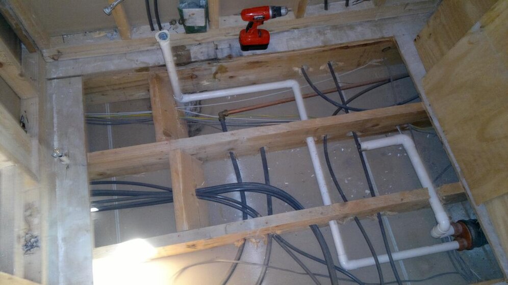

Pictures attached ,have a few walls boarded just waiting on Brother in law to wire up for power shower.

make sure the 18mm ply is well screwed down before putting the 9mm on top. im talking every 6 inches along the joists then when screwing 9mm down fix it every 6 inches over the whole area if you get what i mean. definitely prime the front, back and sides of the 9mm ply. two part adhesive would be the best job for the floor but a its a bit more expensive. any problems just ask mate.
