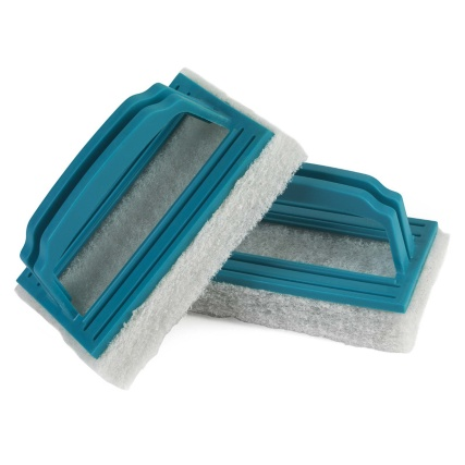

You can get these white pads from B&M £2.99 for 2:View attachment 109751
