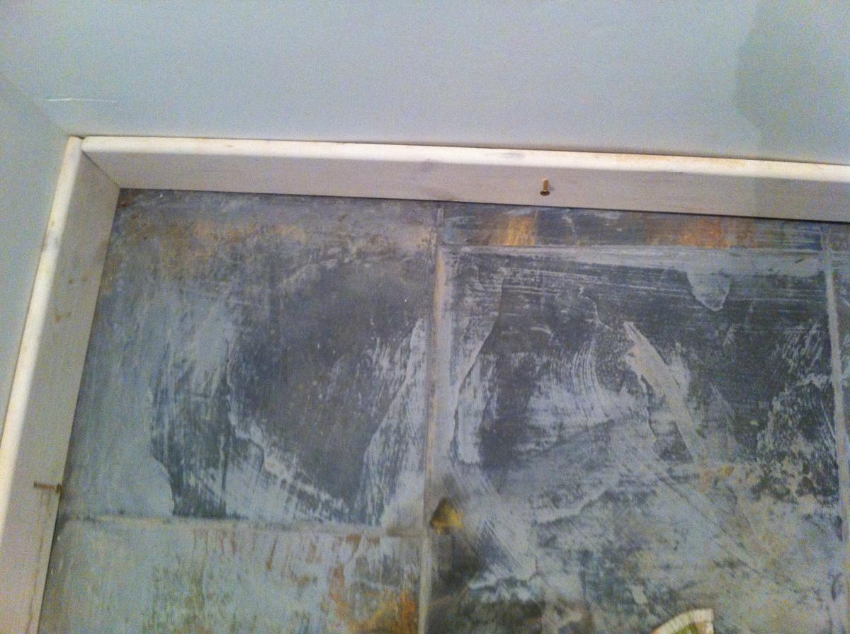

Good evening and thanks very much for your further questions. The builder has not been paid for laying the tiles yet. The builder was supplied with the tiles, the correct adhesive, (which he later told us was no good, see above) and also a can of 2.5 litre of 'primer' - the supplier hasnt listed the brand name on his invoice. As far as we know the primer had been used, but we didnt see it going down and we didnt see the tiles being laid. Here is a photo of a section of the tiling. I am trying to upload picture. will do so ASAP. thank you. tiled floor 1.jpg

Hi everyone. Many thanks for your help thus far and sorry for delay in responding. Type of tile is as mentioned above Porcelonosa (forgive spelling) UNICOM rustic (60 x 40) - this is the tile used over most of the floor, the other tile is Porcelonosa ALMERA (60 X 60). I'm afraid to say I dont know the screed type, although it had been down for at least a month before the tiles were laid. The adhesive that the builder used (having rejected ours, due to it being quote 'a dodgy batch') he has described as 'EVO porcelain and Stone adhesive' - I would imagine this is EVOSTIK?
As a further update, a tile will be lifted next week, by a tiler from the area who has been recommended, so that he can tell us what he thinks. I will take a picture at that time, In the meantime, here is my 'map' of one of the rooms - where I have tapped the tiles to see what is underneath them - the black areas are voids. The tiles with a dot on them appear to be ok. The hatched area is a wall. dining room tiles map.jpg

Are you sure that it's adhesive on the tile, as it looks more like grout to me.
Hi John. Yes, the picture does show a lot of grout, but there is also a lot of adhesive dried onto the tiles (picture doesn't really do it justice). What is your opinion on the voids, as per my drawn plan? Looking forward to receiving more advice, kind regards, Jodie.

id be worried about you joiner as well !
skirtings at internals are butted not scribed
get a tile taken up jodie,then people can see how they have been laid,the cleaning of them is the easy part :thumbsup:
can you not take photos of the whole floor,you can tell a lot about tradesmans work by just looking at it

This isn't looking too good is it. Screaming of inexperience by the fitter if you ask me. Adhesive doesn't go off "too quick" if your mixing it correctly. I presume you were supplied rapid set adhesive initially?
Widler makes a valid point of the skirting too, they're also not countersinking the screws prior. if there isn't enough room to put some filler in there it'll show when it comes to painting. I'm sure there's a way to avoid such a small cut as well maybe?
Anyway, that sketch looks awlful. Not in an artistic critique way but they amount of hollows. IMHO from what you've said and showed so far it's a rip out job. Think your screed has no worries about staying intact though ;)
