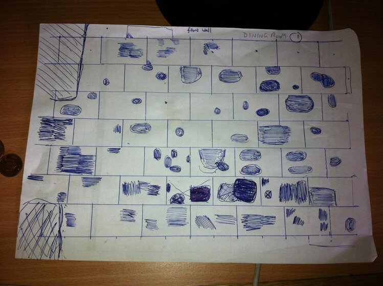

As a further update, a tile will be lifted next week, by a tiler from the area who has been recommended, so that he can tell us what he thinks. I will take a picture at that time, In the meantime, here is my 'map' of one of the rooms - where I have tapped the tiles to see what is underneath them - the black areas are voids. The tiles with a dot on them appear to be ok. The hatched area is a wall. dining room tiles map.jpg

Hi John. Yes, the picture does show a lot of grout, but there is also a lot of adhesive dried onto the tiles (picture doesn't really do it justice). What is your opinion on the voids, as per my drawn plan? Looking forward to receiving more advice, kind regards, Jodie.

Anyway, that sketch looks awlful. Not in an artistic critique way but they amount of hollows. IMHO from what you've said and showed so far it's a rip out job. Think your screed has no worries about staying intact though 😉

It is difficult to qualify if they are voids until the tile is lifted so that would be a given that tiles must come up to see how much adhesive is actually under the tiles.
