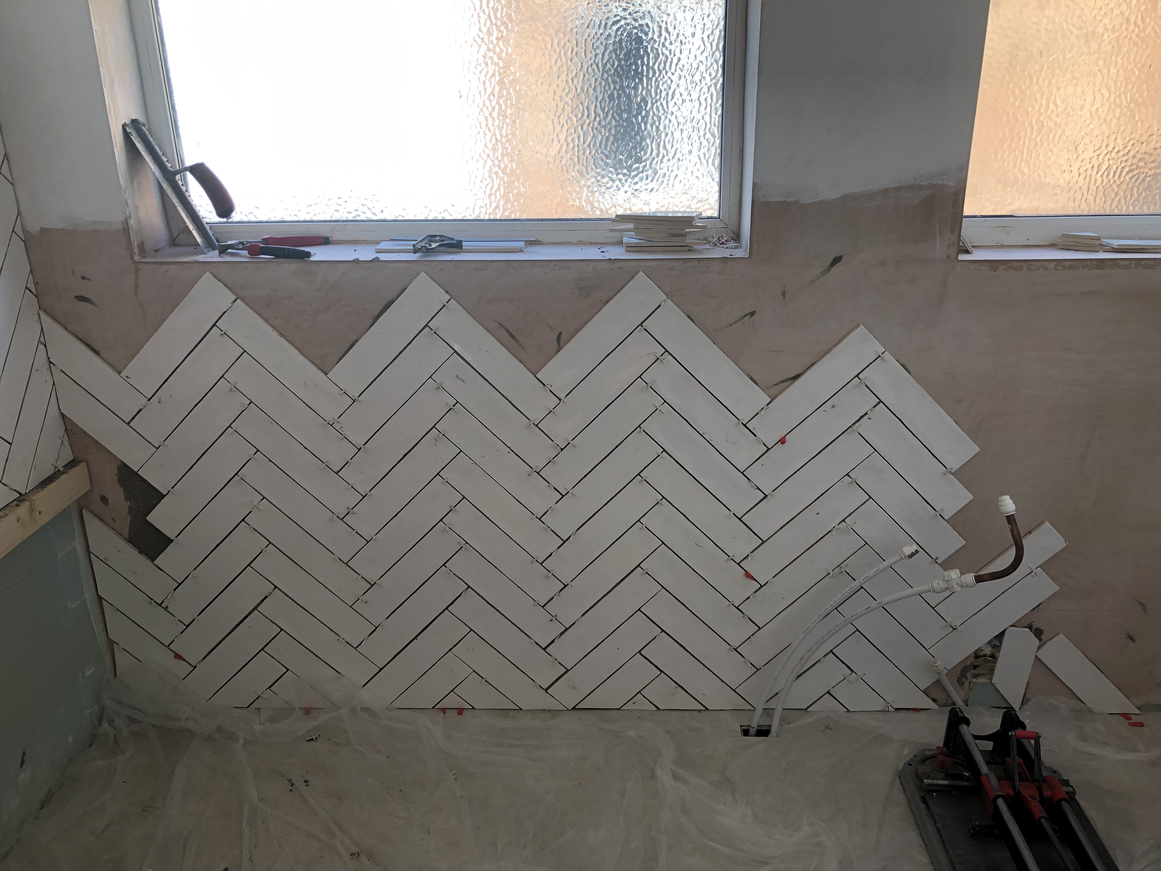

We’re doing this at the moment

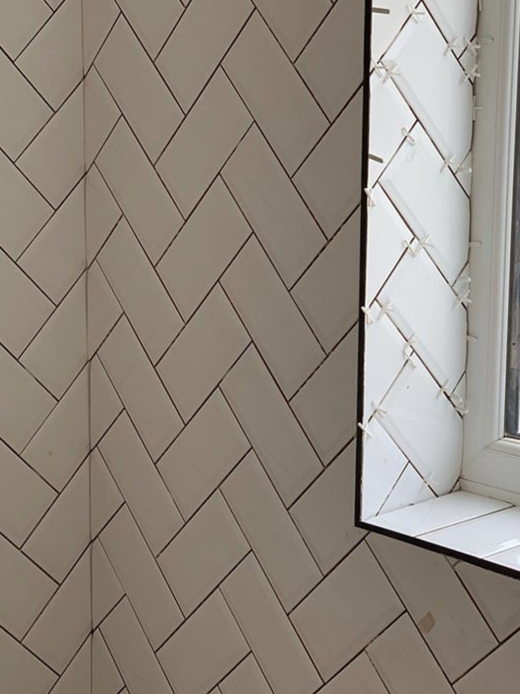

Lovely work👍What about the sill..was it not possible to continue the Herringbone onto it. Only reason I ask is because I mocked up a wall with a shower niche over christmas and had a play but when it came to wrapping around the internals of the niche I had to give up as was on it for days but just couldn't get the grout lines to match up.

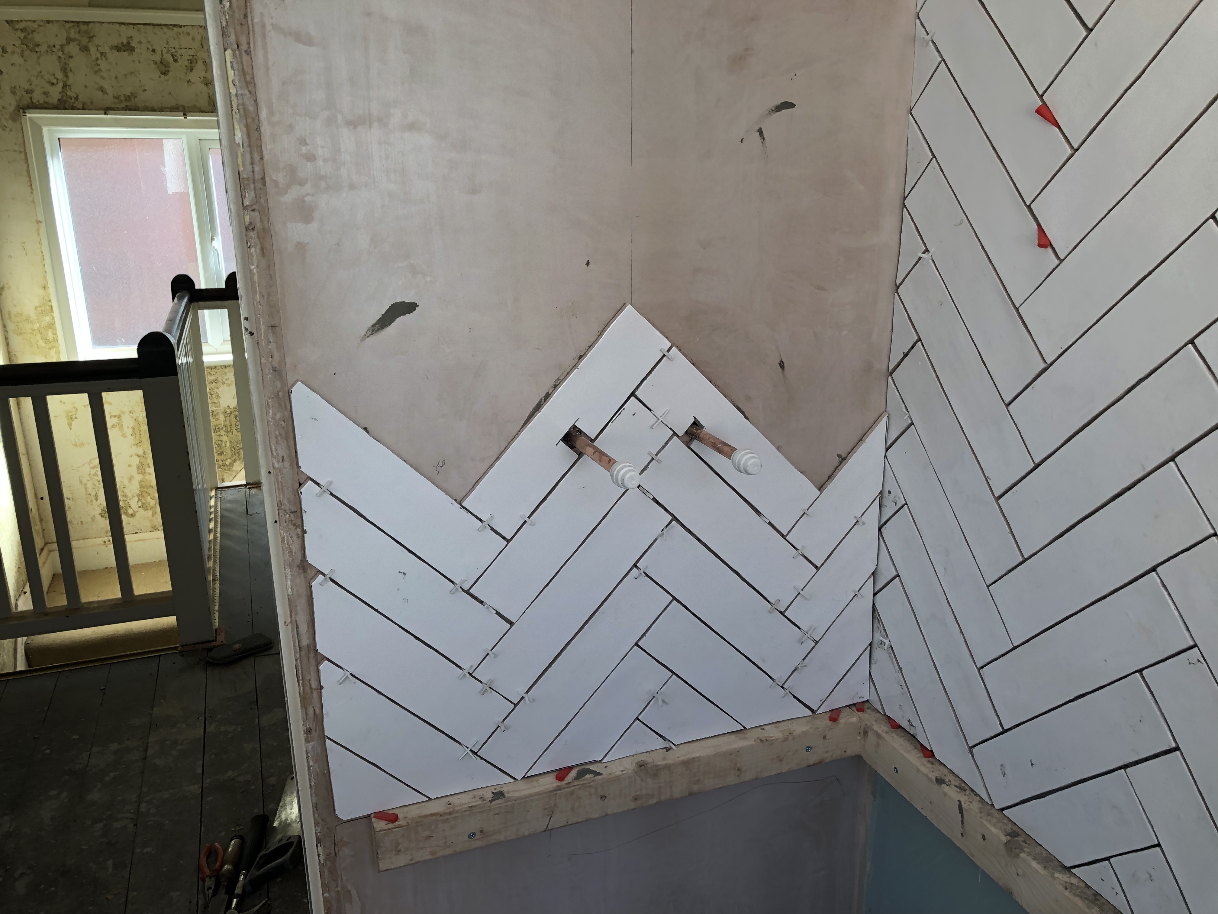

Hi, we are having a herringbone pattern in our bathroom and the tiler has done one wall but then when he’s gone onto the next wall and the lines don’t match. Is that right? It looks funny to me but I’m no expert! Your help would be appreciated before we waste too many tiles and time!!
Hi Lauradene, the tiles no matter what pattern is being used should look like the tiles are being "bent" around the corner. The tiles that have been fixed thus far just do not give that impression. In my professional opinion these have not been fixed right. I would ask your tiler to stop before he goes any further. The 2 parts of the tile should more or less make up one tile. This is hardly ever exact but the pattern so far is so obviously wrong. You are right to be concerned!
Tell your tiler to check out Youtube 😉 Type in herring bone tile installation. I get a lot of tips on how to do stuff the right way.
It's wrong. Did you do it yourself or the plumber/builder?
The wooden batons spell big danger. It looks a total mess.
Sorry. Rip it out and start again with a tiler from nearby you.
Always wrap herringbone around corners, always... just looks incorrect otherwise, it makes such a difference.
