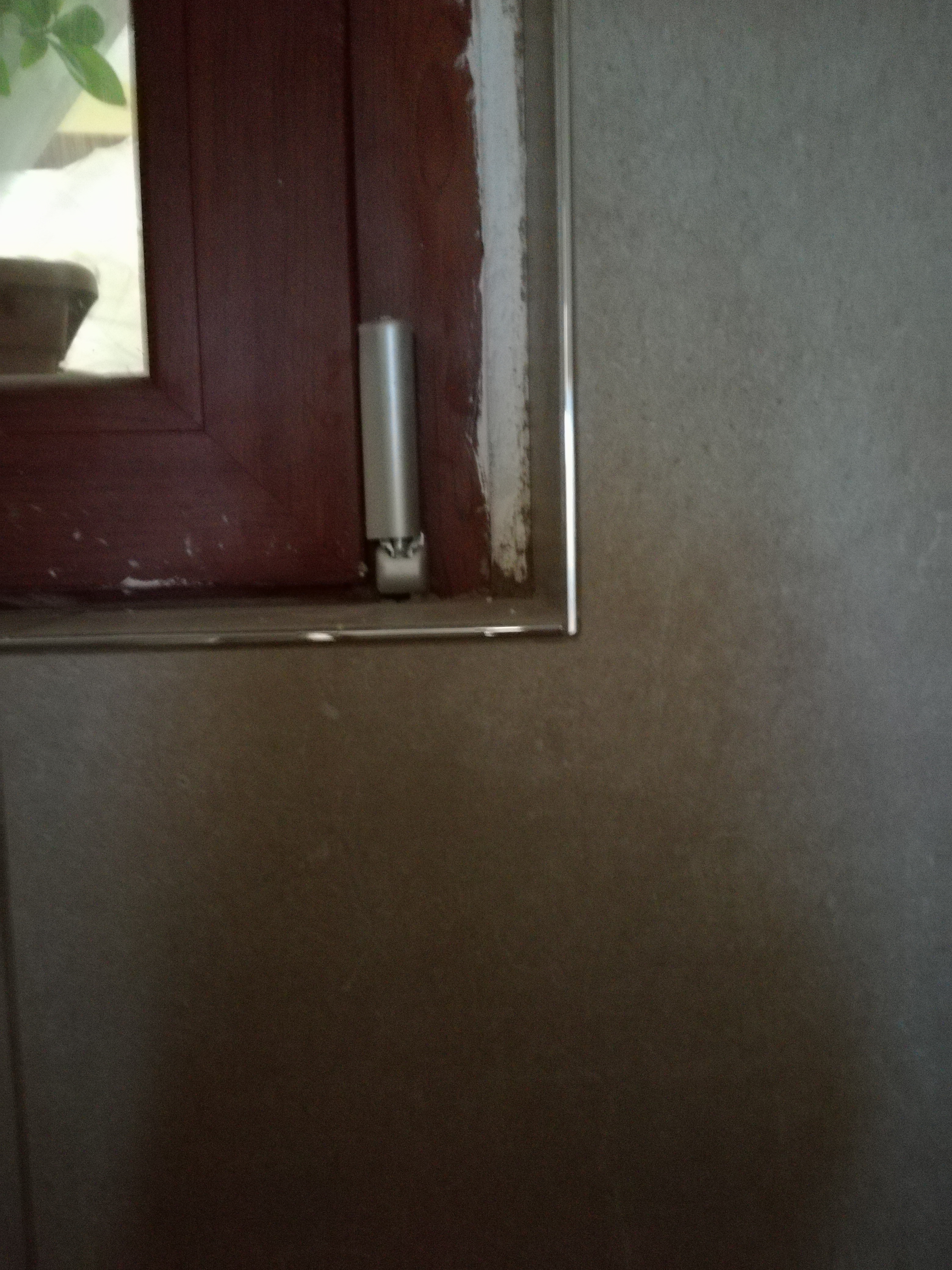

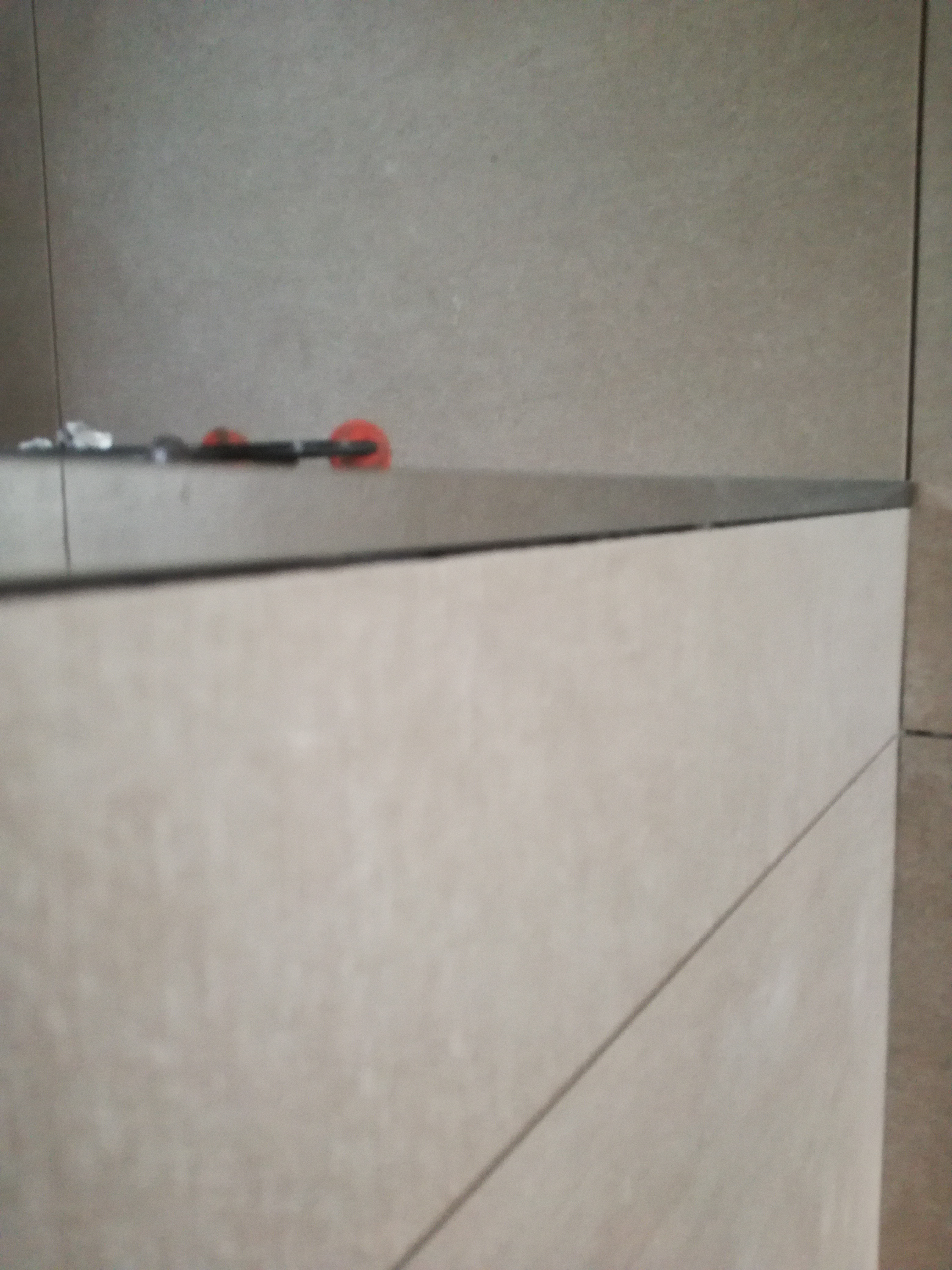

Is this an acceptable edge cut?
Matt - That is a good point. I guess it really depends whether the price paid for the tiling matches the finish.
This room is 1.6mx1.6m, tiled floor and all the way to the ceiling, and we are being billed £**** for it. Reasonable?
It is clearly bad workmanship and he has no pride in his work, if he won't/can't rectify all the issues you have raised I would get another tiler ( look on this forum for nearest tiler to you as you will be getting expert advice and workmanship)to give you a quote on price to rectify it and deduct that off the bill.

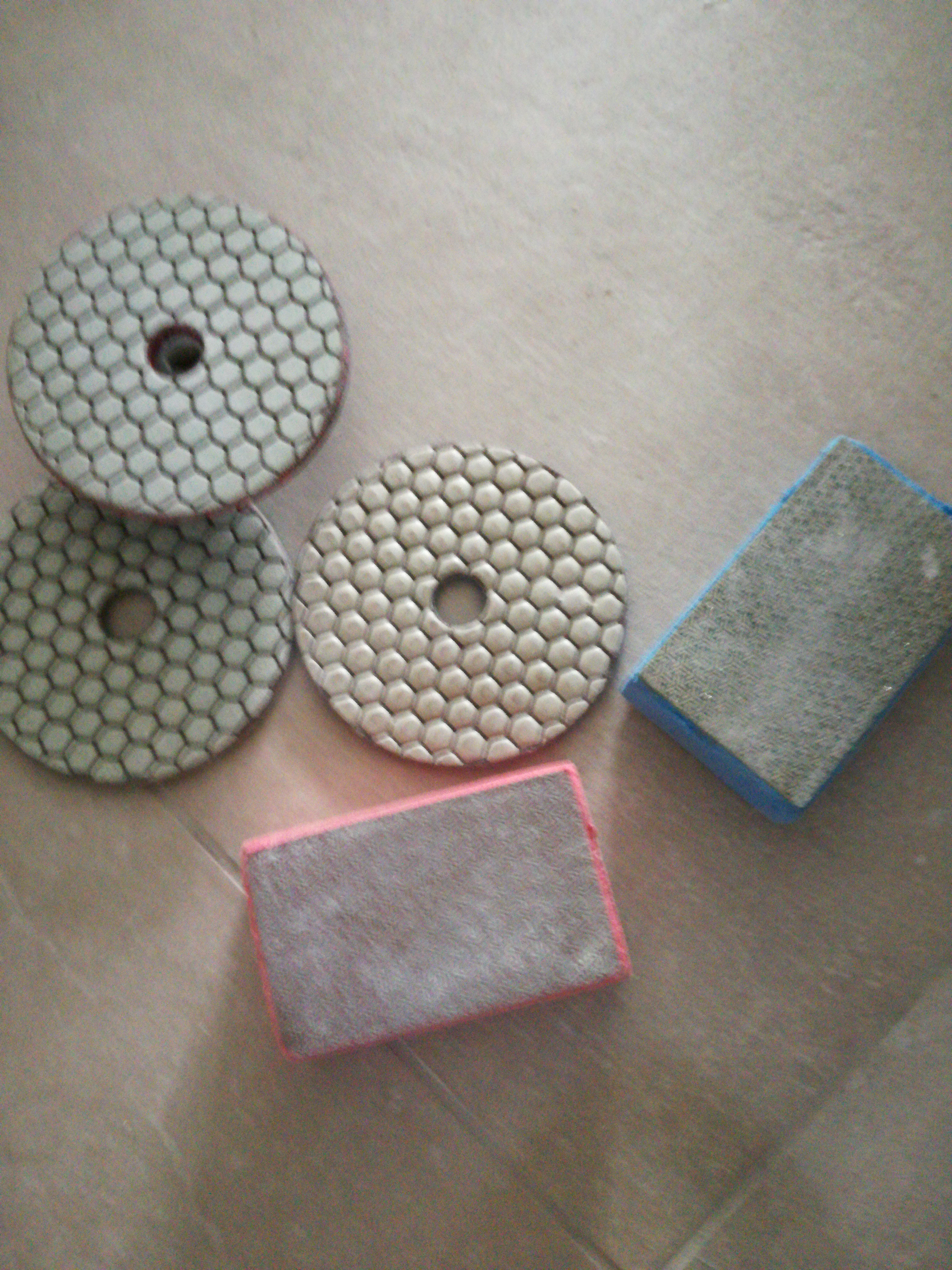

Today I spent about 4hrs mitreing and polishing porcelthin, and I've probably another 12 hrs worth of the same.
I could have put a 5mm trim on and the customer would be happy enough...
