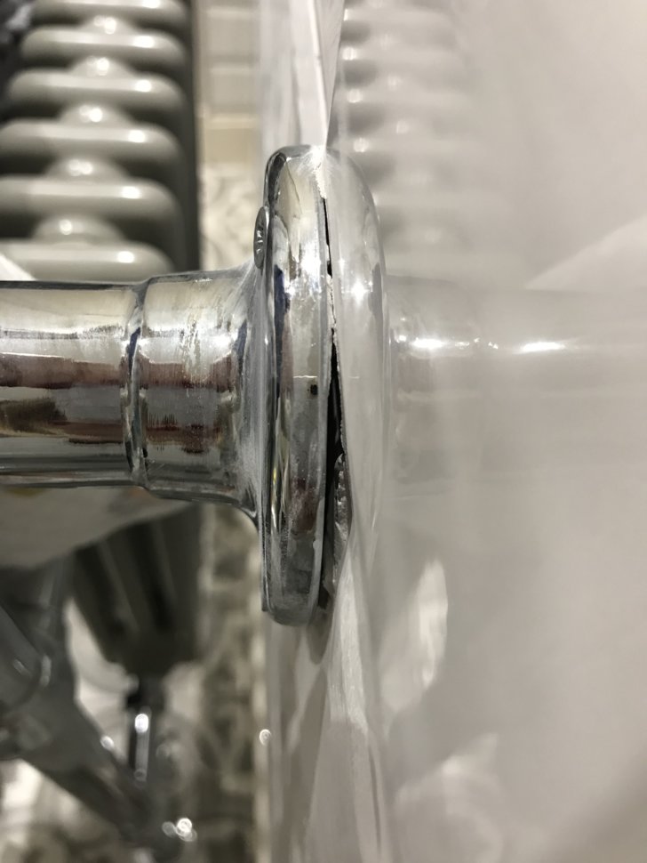

Thanks for the message. We are having the family bathroom done at the moment by new fitters. The floor was 16mm out and they have totally levelled it by ripping it all up and basically re-doing it. The walls are also being sorted with plasterboard. Such a thorough job by comparison. We also discovered last night that this has happened....this radiator has been on the walll less than a week.

To be fair with those pictures, the setting out needed to be better, or the radiator considered during the setting out at least.
The fixing of it has married up with where the tile bevels. There would be no way around that other than to create a wooden fixing perhaps, painted white maybe, to take on the shape of the tile, and then sit flush with the radiator fixing.
Otherwise they're having to stick a flat fixing, onto a V-shaped backing (tile). There is no way on earth they could have gotten around that without adding something to marry the two up properly.
Ooorrr move the tile setting out so that the fixing site in the middle of a tile, and then carefully drill through the tile rather than going for the grout joint.
Not sure if that type of radiator you could have perhaps moved the fixings to where the centre of the tile meets a bar on the towel rail? Perhaps there was some leeway there. Not sure.
A good professional tiler would have gotten around that by way of sorting a better fixing out, moving the tile setting out, or at least fixing a proper plug into the wall and not leaving the weight of the radiator on the tile.
So the choice of your fitter wasn't a good one. IMO.
