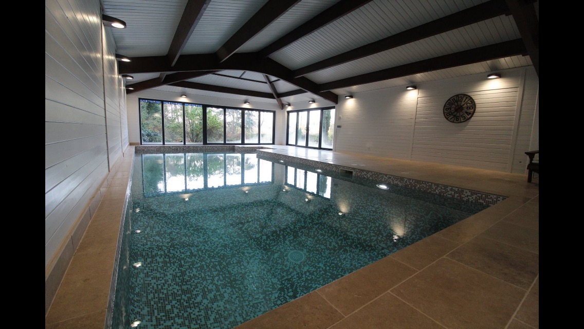

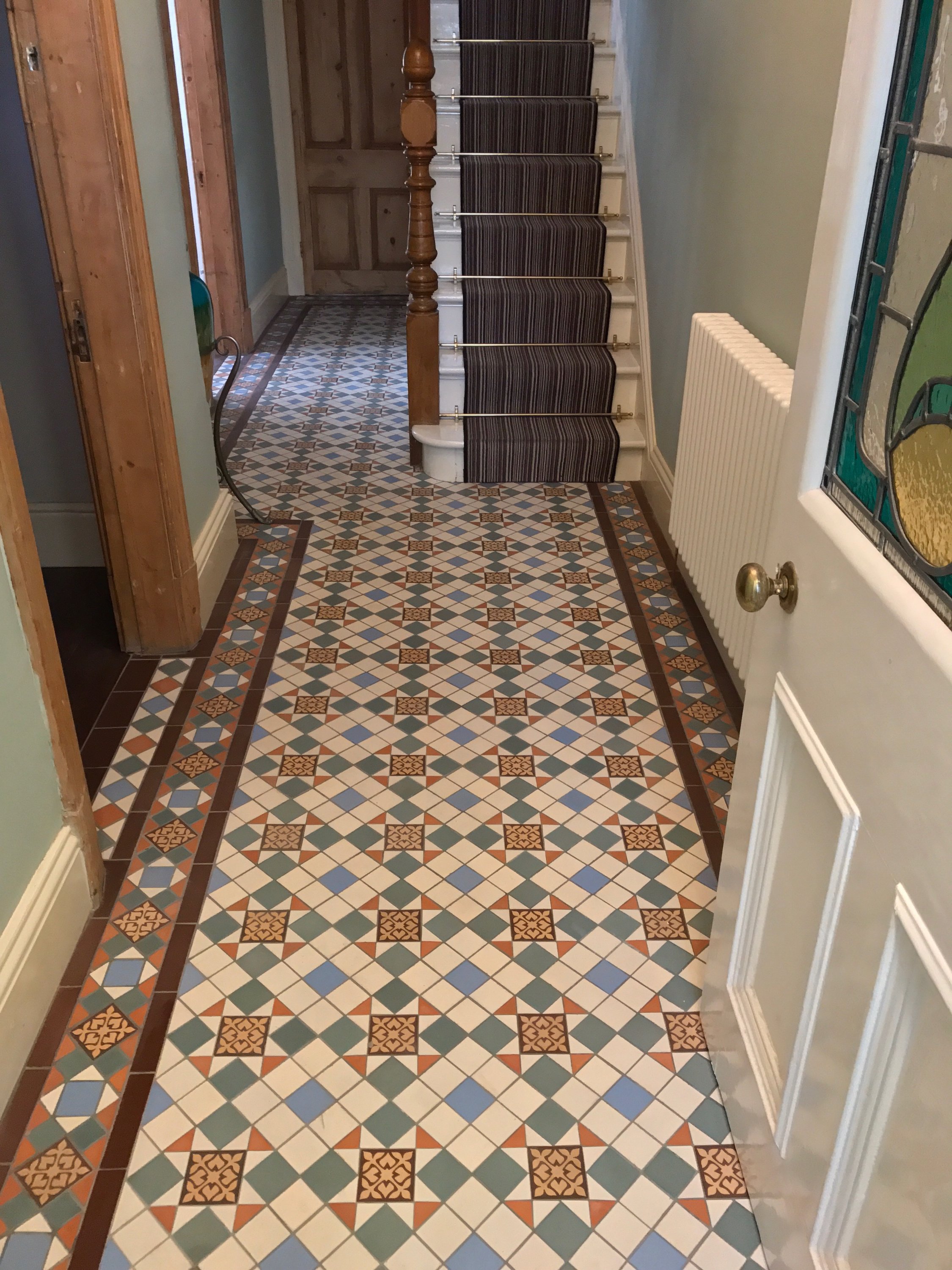

F1167F1E-ADE3-4777-9BD3-FA916283BB05.jpeg 207D1830-AB79-4D79-A715-E2B938CAD49A.jpeg
I don’t think I have worked in a house in Middlesbrough where I thought that is good quality tiling. That’s why I done mine myself.
(I live in Middlesbrough too)
