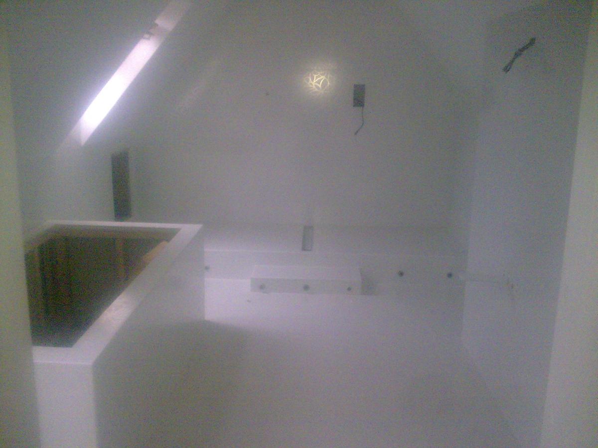

Pipes and wires are on show most of the time. , wanna know if using a drill before laying the tiles is faster than what i do now ?
I coudnt imagine drilling a tile that isnt fixed , without REMOVED up the tile.
, iv never used a drill on tiles at all ...
