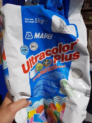

I don't know if this is relevant or not, on checking dome of the rubbish that's been left behind. The adhesive that appears to have been used on 60cm x 60cm floor tiles, is Mape Grip D1. wall tile adhesive? (Could this be a major factor in the movement?)

If it had been used to fix the tiles it is a complete disaster. However it looks from the photos like your tiler has used the ready mixed adhesive bucket to mix up the grout (alot of us do similar). If it has been used to fix the tiles it will result in a failed floor sooner or later and yes, could well have helped cause your issues.

Thanks for that, there's 2 empty tubs, of the same stuff (One as you say appears to have been used to mix the grout in, but not the other, which only confirms my suspicions, that's what he's used, given it was only a floor that was being tiled (no walls)
Again he could of used it to mix floor adhesive . We all used to do it years ago when we also did a lot more small wall tiling . Tilers very rarely bought buckets,Now any time I need one I have to buy one .
Possibly, a bit odd you'd take away the floor adhesive tubs and leave 2 empty wall tile adhesive tubs on a job with no wall tiles
Floor adhesive doesn’t come in tubs. It comes in bags and has to be mixed in buckets...... hence the wall tile adhesive buckets......
