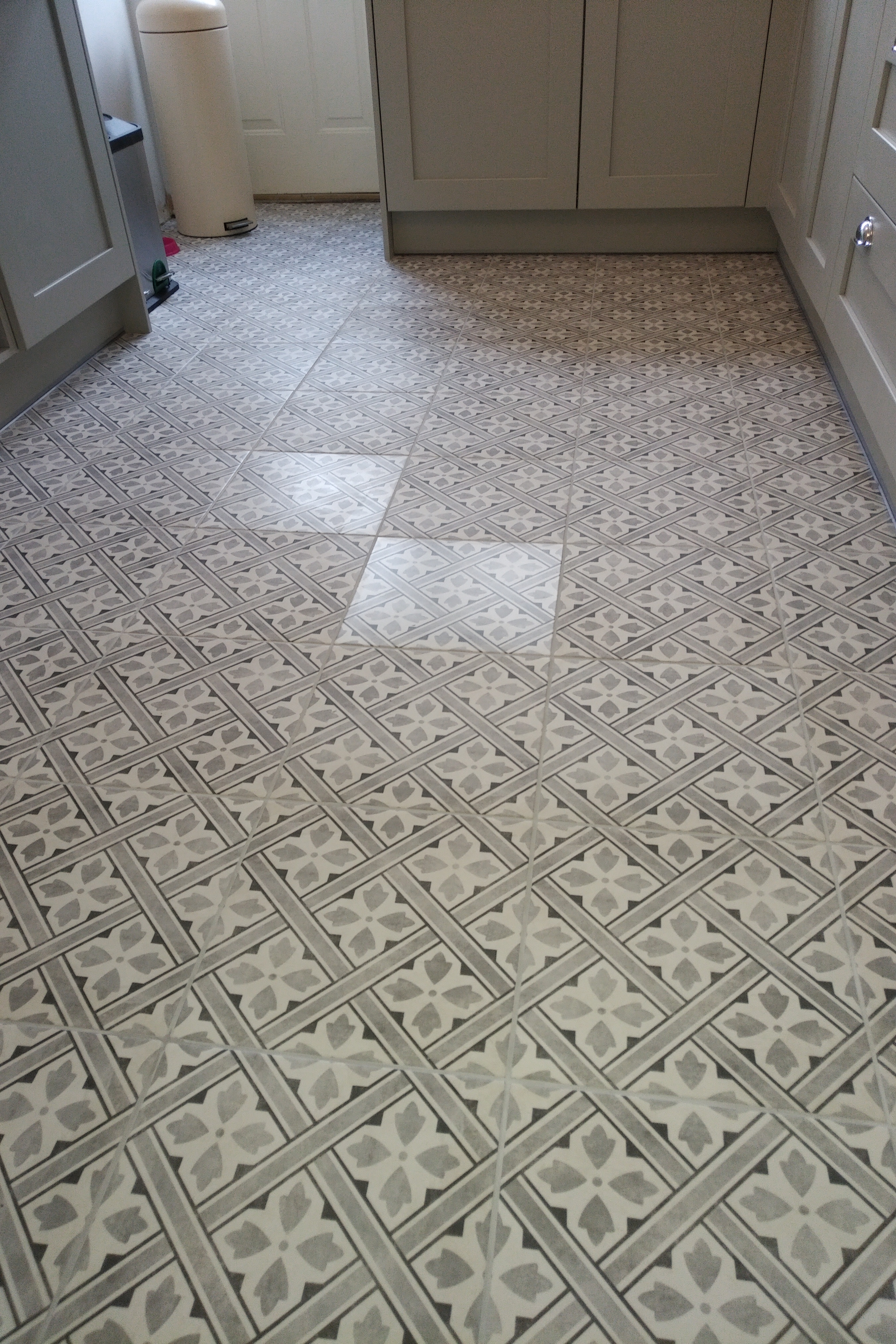

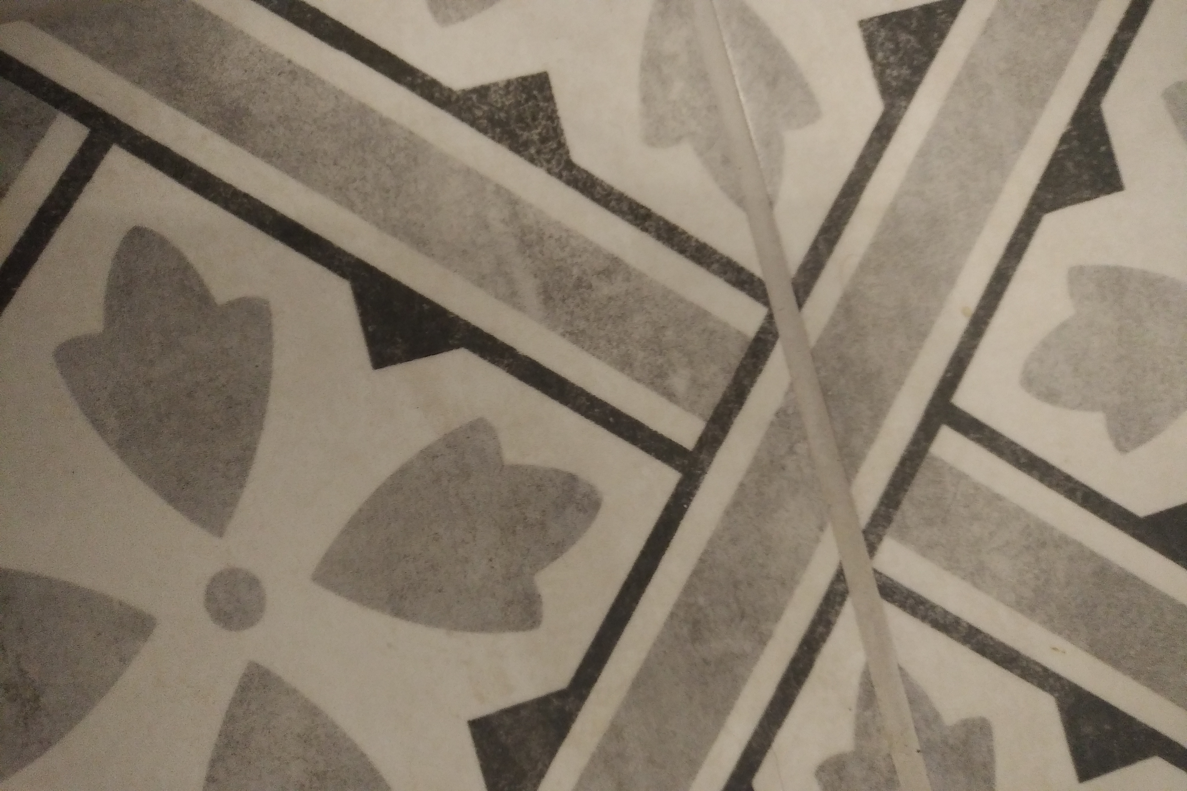

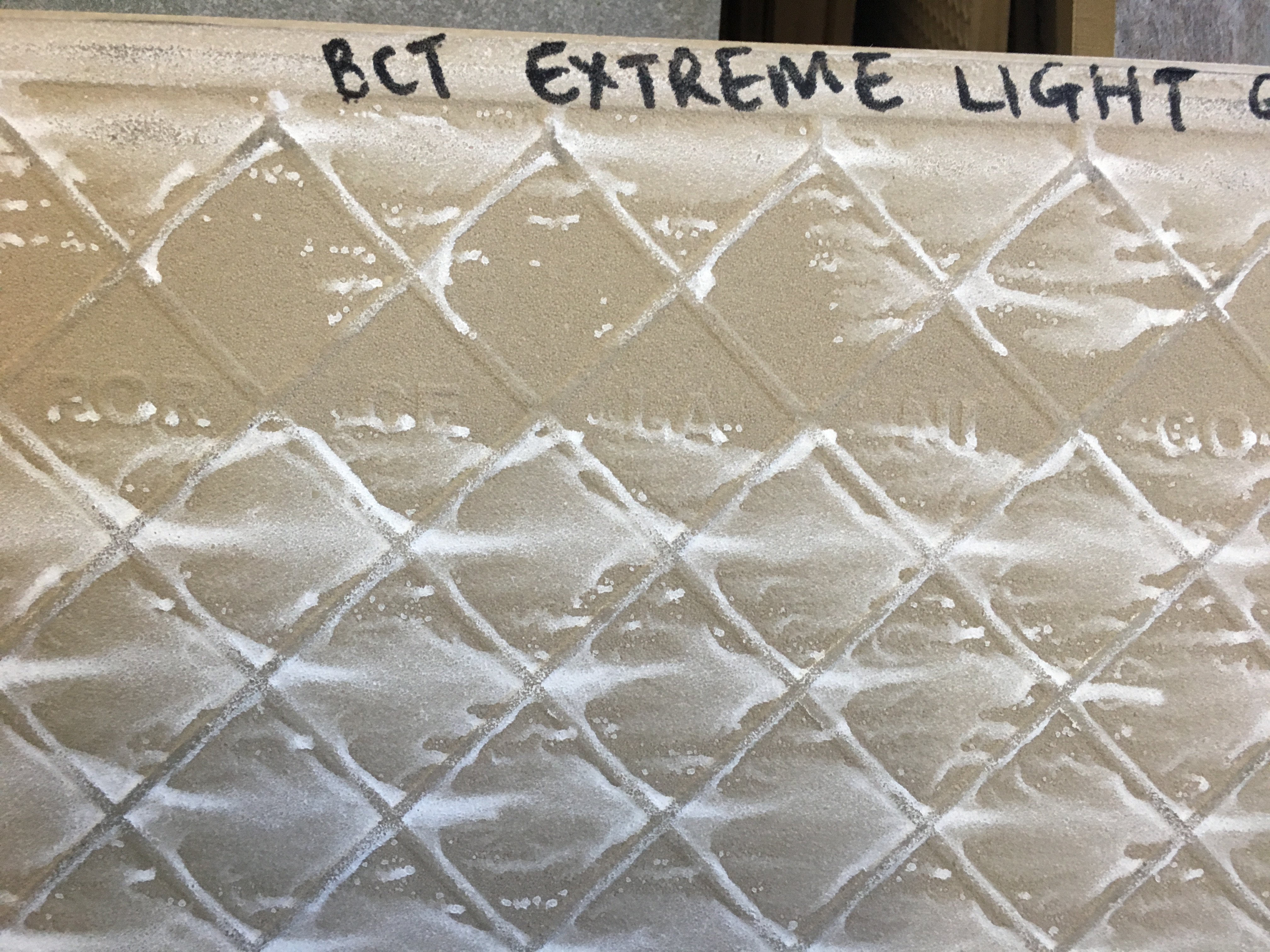

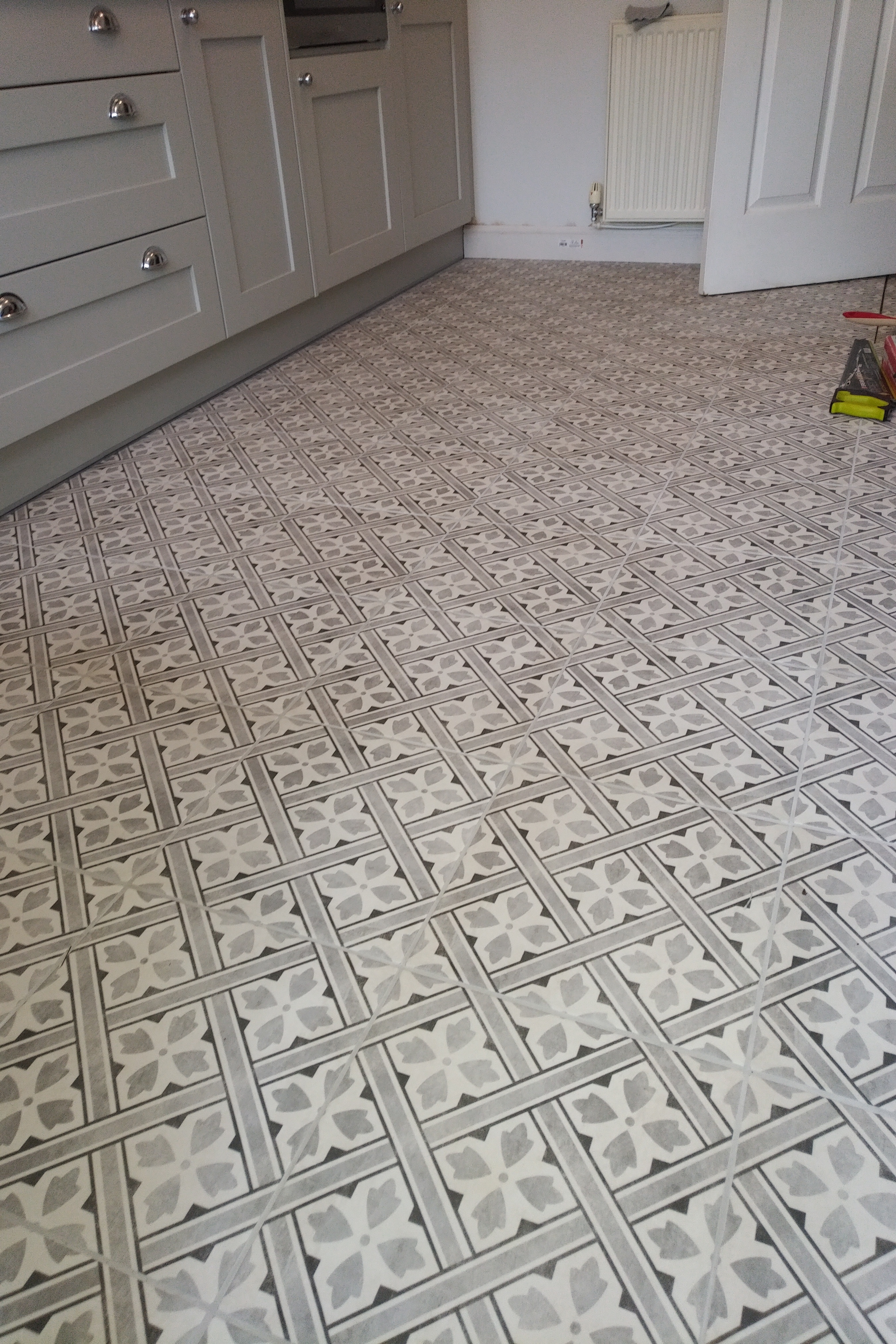

Thanks for replying. Batch now same. They just seem to look stained in areas and I am worried it's going to get worse. So upsetting I assumed anything associated with Laura Ashley would be good quality. I shall have to contact them directly.
Just wondered if anyone else had problems with this particular tile and if they resolved it.

Not the greatest of tiles but this is not a normal quality issue. Its an actual fault. Who is your supplier? Send them pictures and they should get BCT involved. BCT had glazing issues on a production run and have confirmed 20-30% of the batch are faulty. We've had a couple of cases raised and BCT covered all the tile and fixing costs to get them all replaced.
