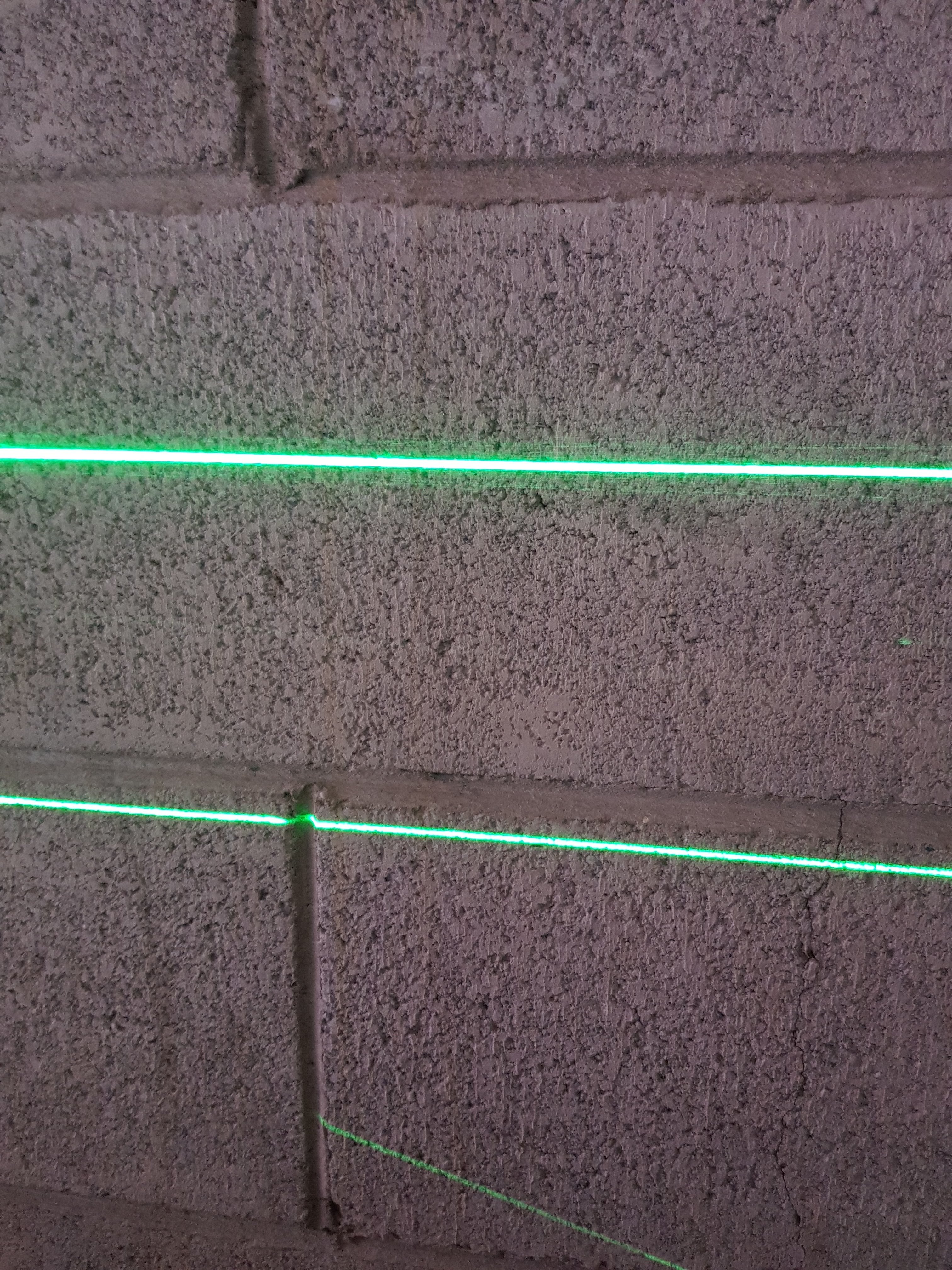

the thinnest green I've seen is the bosch gll3 80 green.
3 visibility settings.
this is the difference between the bosch with the second light setting
and one stabila, distant 50cm from the wall
