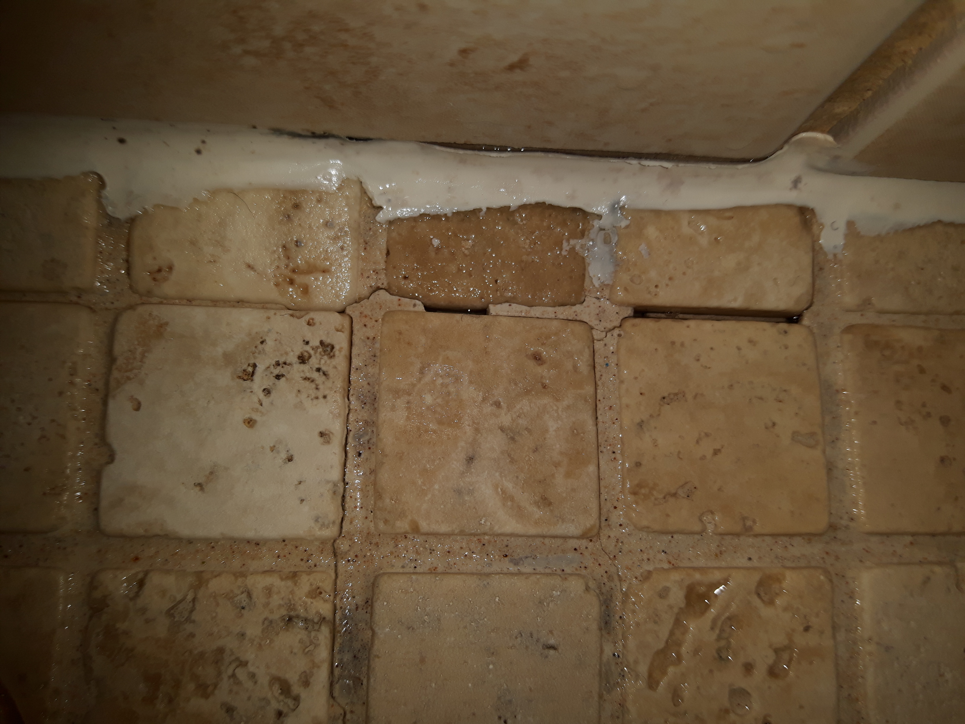

Recently, I have noticed that water appears to rise through the grouting in the dry area when you put exaggerated foot pressure on certain areas of the floor. Also, water has entered through cracks in the mosaic grouting (water rises up through the grout when standing in certain positions in the wet area). This is usually in the opposite side to where the shower head is.
In addition, one of the wall tiles in the corner below the shower sounds hollow when tapped and it is evident that there is a gap around the grouting.

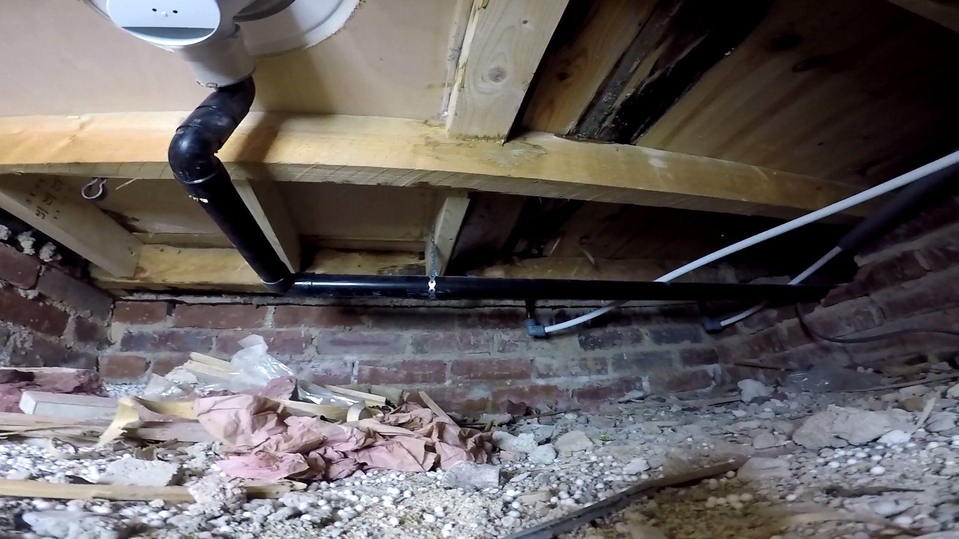

An under floor inspection shows some of the support noggins are wet with fungal growth. This is the noggin supporting the floor directly underneath the shower. However, one of the floorboards running the length of the floor in the "dry" area is also black and mouldy.

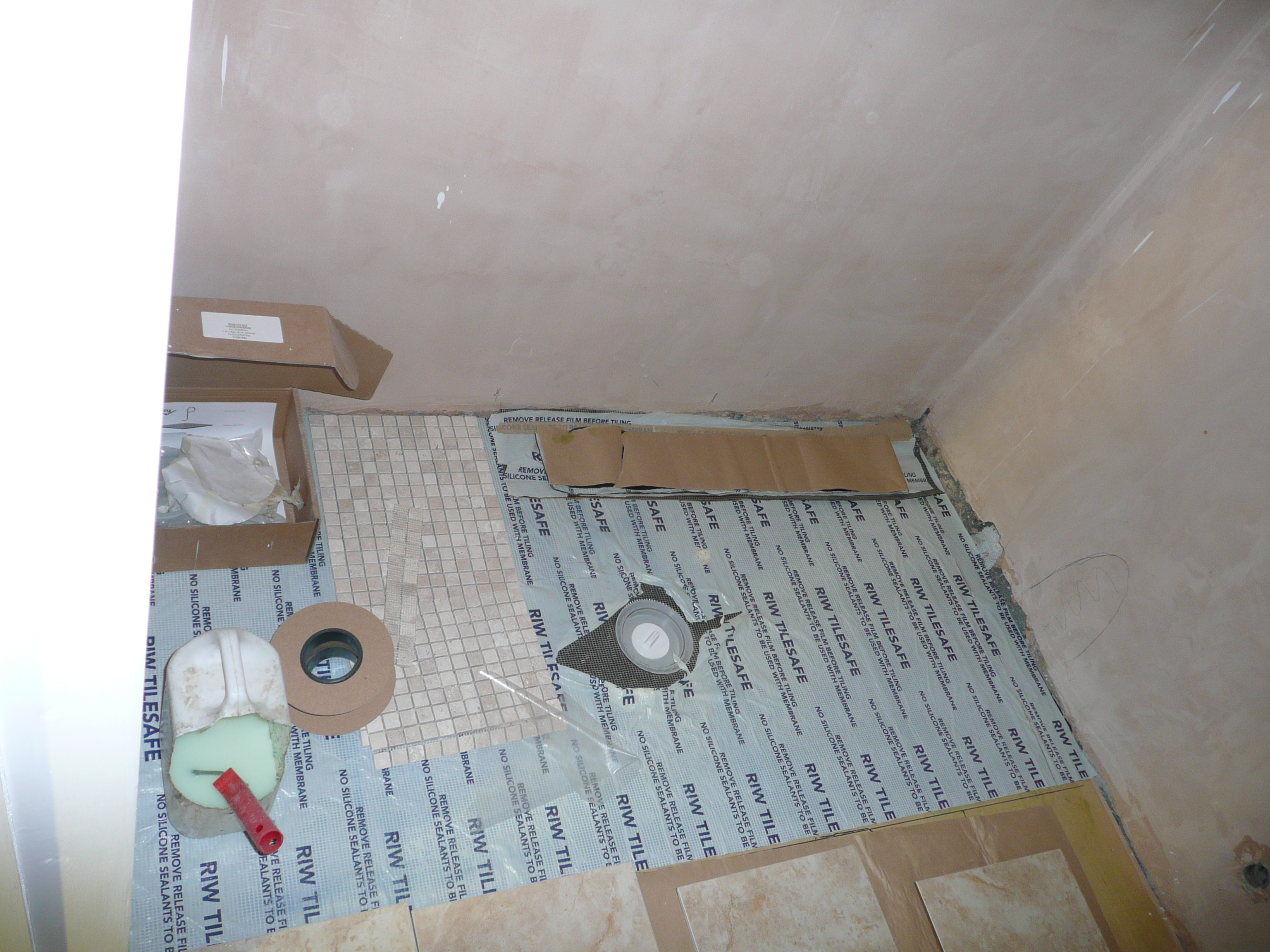

The photo showing the Tilesafe membrane, has the junction between tanked and non tanked area corresponding with the line of this damp floorboard.
There is ingress of water from the corner wall tile, but also through all the cracked grouting in the mosaics. It appears, that no tanking was laid up the first course of wall tiles.

It's not just the floor, the wall should have been tanked as well. Also the floor joists look a bit lightweight to me so you may be suffering some deflection ( bounce ) which would cause the grout to crack.
Hopefully one of the guys on here can sort it out for you.
All out, walls included is the only way to ensure this doesn't happen again, the job was not right from the start unfortunately.
Thank you all for your replies.
When you say walls, do you mean the bottom 3 inches as shown on the installation videos of Tilesafe or are we talking about up to the ceiling?
Also, the joists are the original build from 1974, a bungalow. Will only the aquadec former need support timbers or are you indicating that the whole bathroom floor needs strengthening?
The floor needs not to have any bounce in it so you may have to put noggins between joists . ( short timber running at 90degrees to direction if joists ) or possibly pair up the joists ( attach another joist along side existing joists) to strengthen the joists . Also good practice to tank wall to ceiling . Another thing the other impey membrane is easier to use than the bitumous one . I think it is called impey Waterguard
