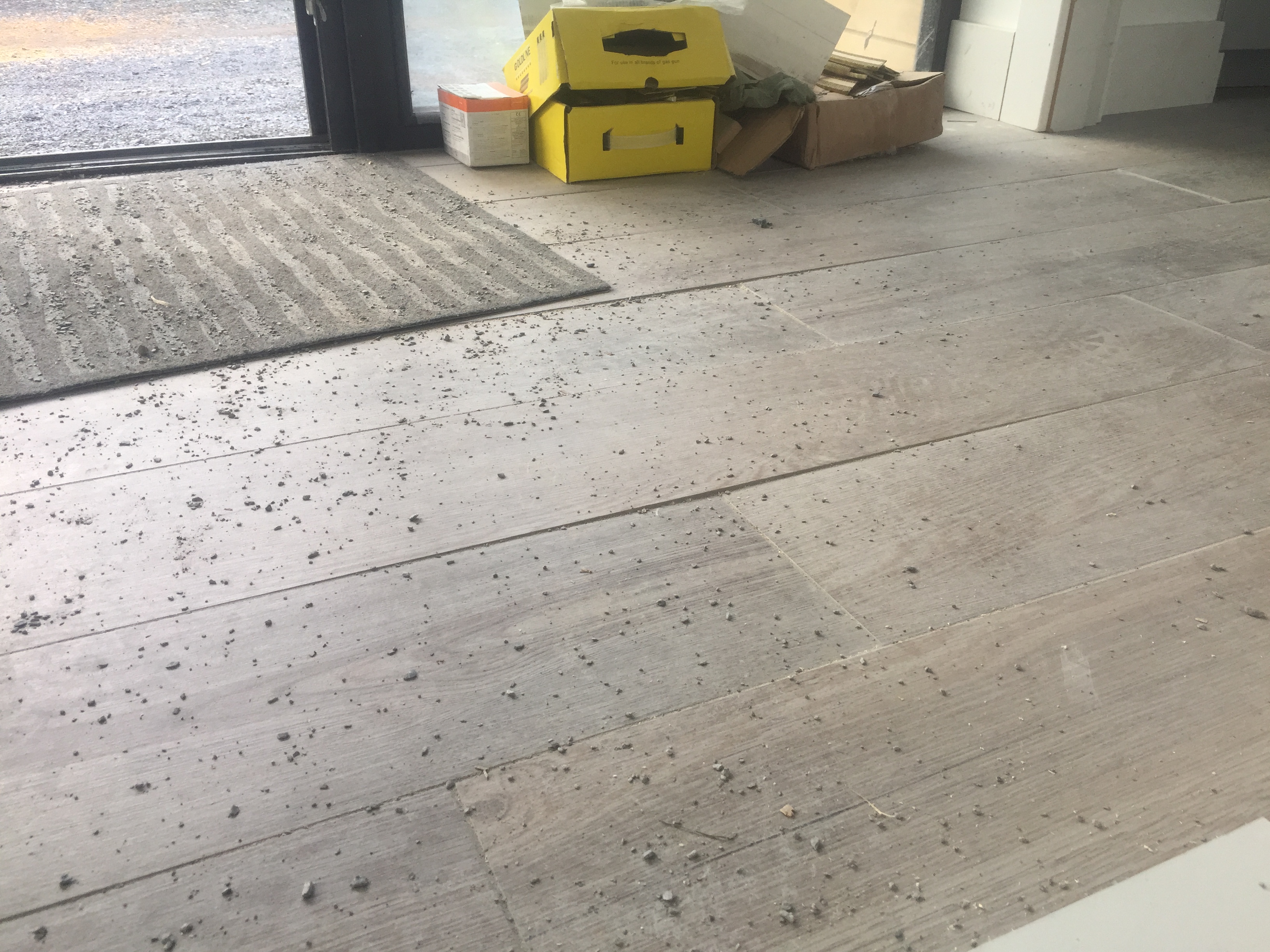

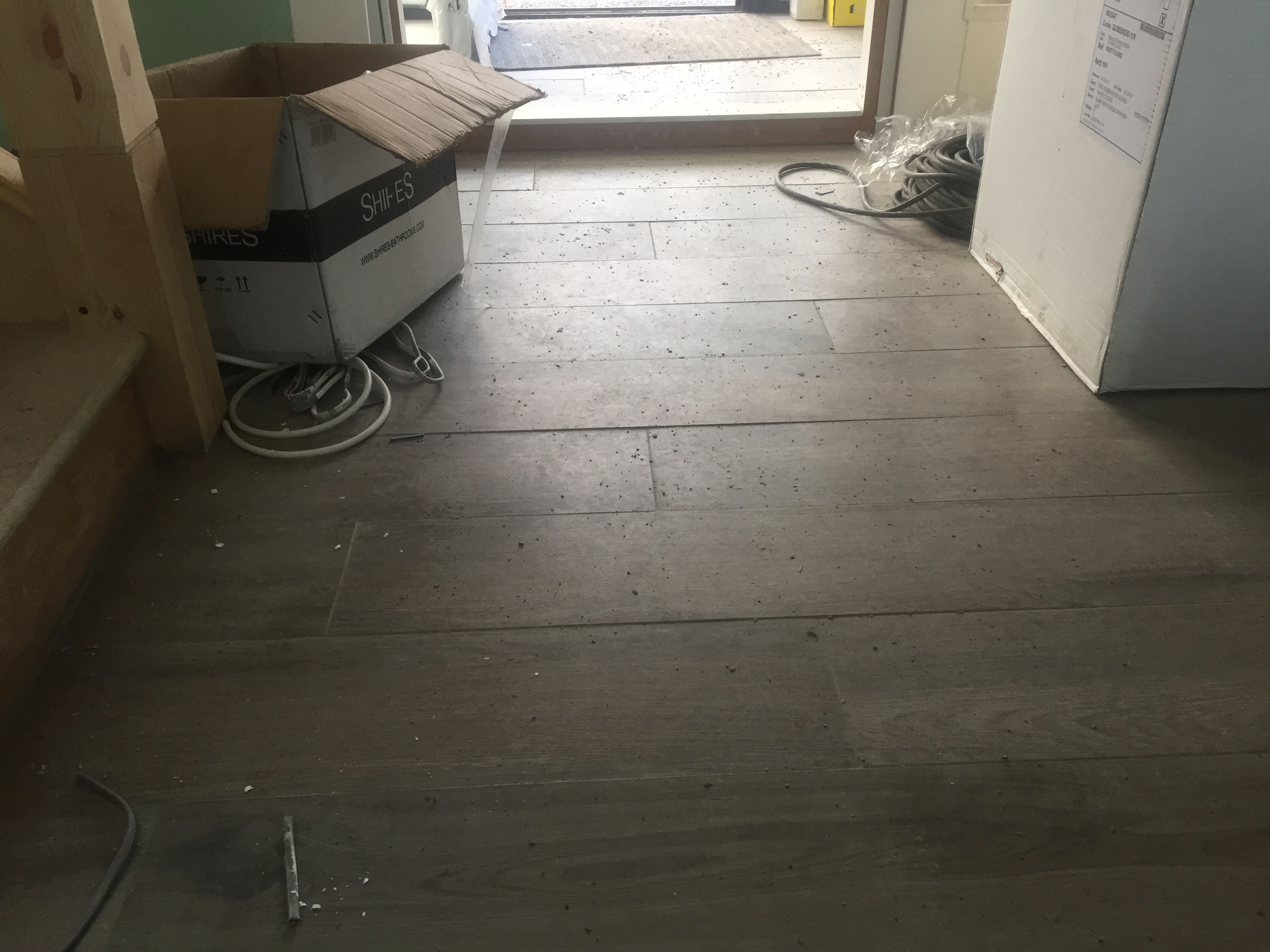

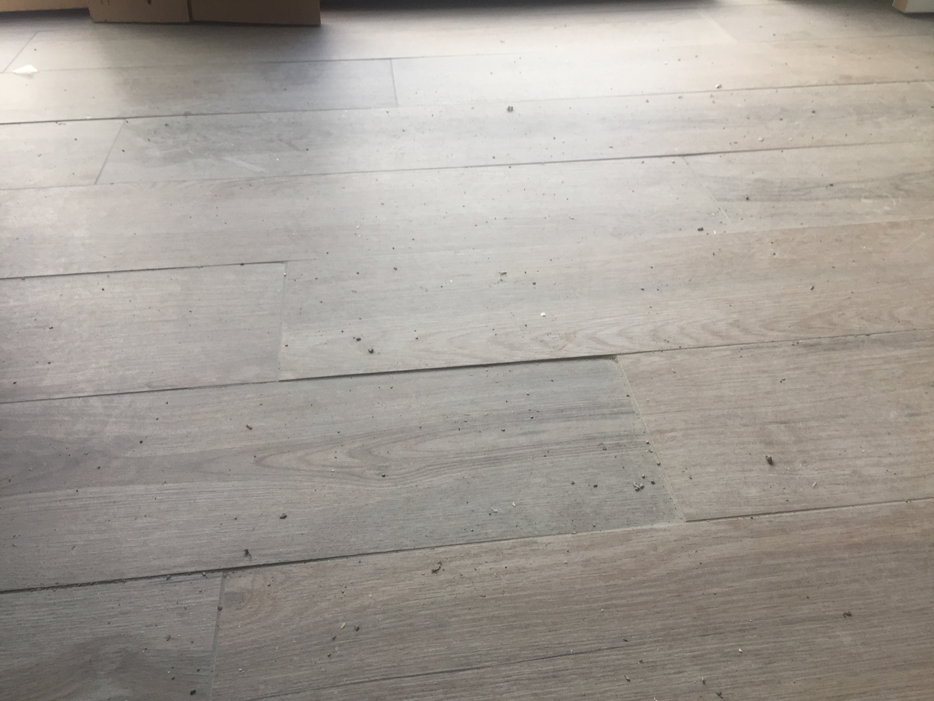

F06F665B-3F88-4667-A139-275E8CFE92EA.jpeg 59613AC0-A8BB-42B7-9228-8F2EF54D483D.jpeg 54270025-4366-421F-8F8F-E924FB1DB1B2.jpeg F84658FD-DFA0-445B-B669-F57029C84B39.jpeg 9E6CE6E8-9C1C-481B-9070-DCF9466CF10D.jpeg I’ve had arguments with ‘tilers’ who tell me that levelling clips are a gimmick and they’re not needed. Well look what happened to some plonker who said this to me. The floor without the clips is obvious and by pure coincidence I finished one yesterday were clips were used. I got a call by a plumber friend asking me to quote to finish the job that the ‘tiler’ who wouldn’t use clips got threw off, so I visited site yesterday to find this :eek:
I have to say that I have yet to find a bowed tile that hasn't benefited from levelling clips
How can you make a bowed tile make a flat floof ,impossible,we all know there are alot of rubbish tiles out there and a lot of customers buy them ,no clips whatsoever will make them flat
