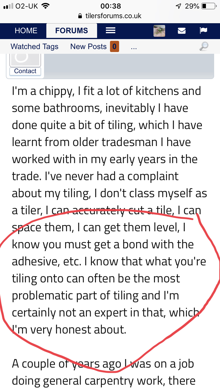

Not been rectified. He came to me about 6 months ago about it and basically looking at it then I could see it is riddled with problems, he wanted me to relay the loose ones and I basically said I would be doing the same again to relay so what's to stop it going pear shaped again, I basically told him the problem was probably bigger than simply relaying the loose ones.
We're at a situation where he's on about moving his family out of the house, the kitchen, skirting and all other fixtures removed, tiles and chipboard up and replace the lot. I'm thinking £10k guess. He also insists he will put it all back in the same way, same tiles onto chipboard, because the only cause of the problem is the amount of adhesive I put on (20mm).
I'm not rich £10k is unthinkable.
