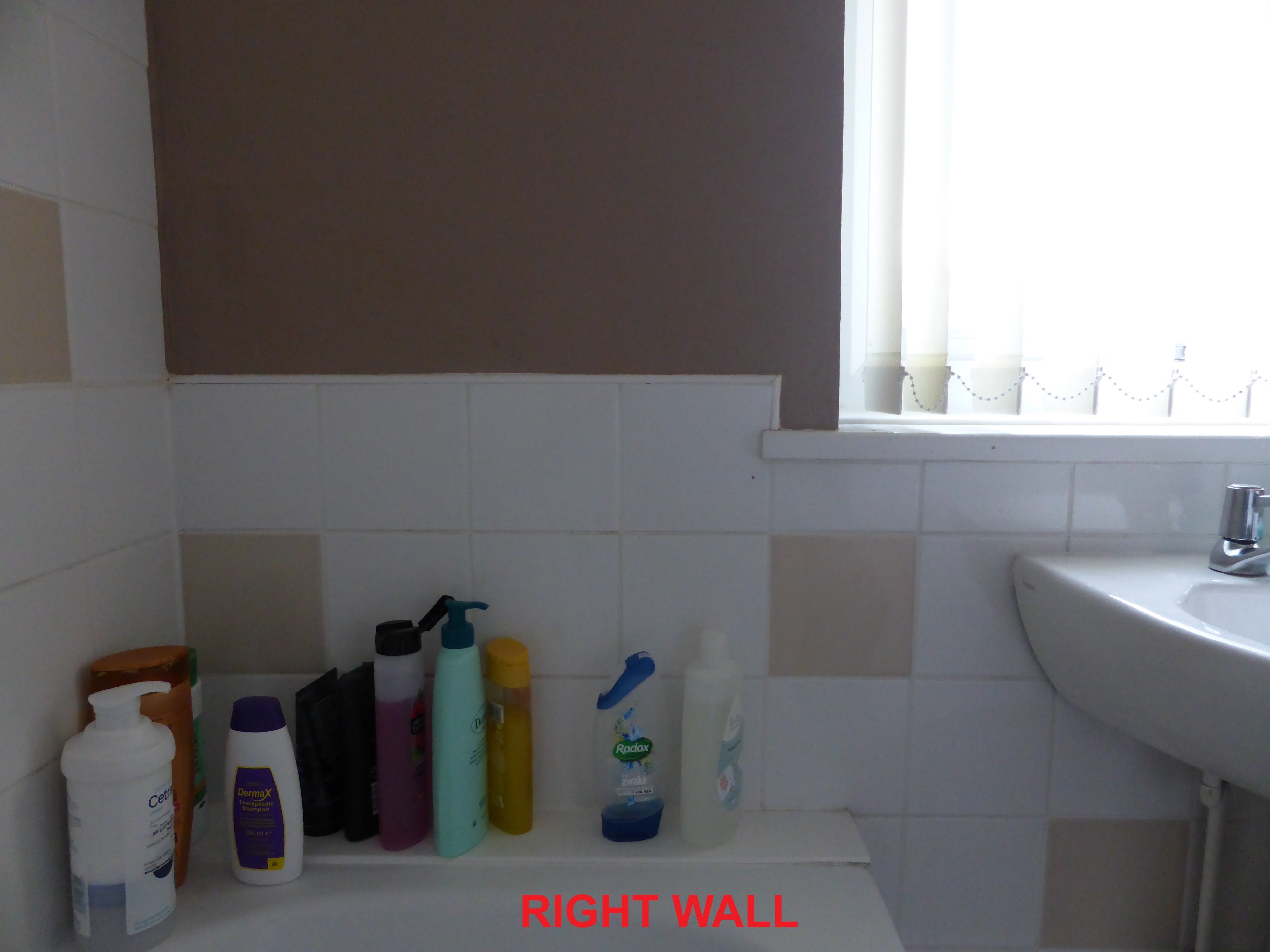

Hi all,
I am getting quotes in at the moment for my bathroom to be fully tiled, all walls top to bottom and floor.
So far the quotes are ranging from £590-690 but before any of them can do any work i need to remove the tiles.
So now the dreaded bit, what would be the best way?
All i can tell you is the following:
Left wall is plasterboard, behind that wall is a walk in cupboard.
Back wall is plasterboard, behind that wall is my next door neighbours house joint to mine.
Right wall is plasterboard, behind that wall is the front of my house.
Any ideas of the best way to remove the tiles without damaging the plasterboard to a extent that it will have to be replaced.
I was thinking of getting a cheap SDS drill but not to sure as i don't want to buy something for this sole purpose only to find out i will still have to replace all of the plasterboard.
Also attached some piccys of the tiled walls i need to remove.
Your thoughts are most welcome.
All the best
Jay
