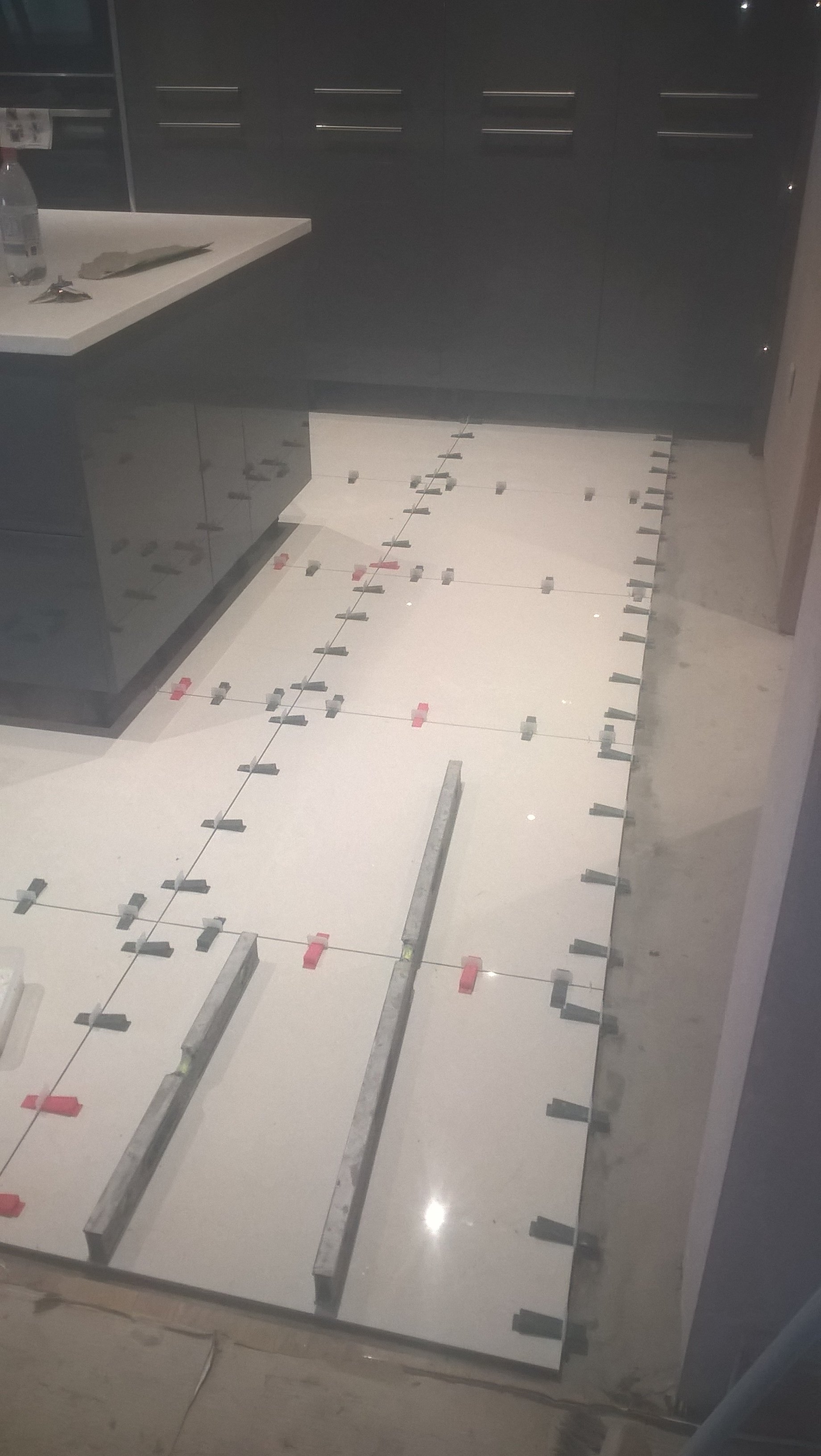

Just grouted a floor today with TM Jasmin, against my advice of it being too light a colour thats what she wanted, anyhow picked up a can of LTP grout sealer spray...is it any good, also is it as easy as it says on the tin, just spray and leaves no residue on the polished porc?

Cheers Paul these are the tiles if it helps...Simpolo, vitrified polished porc? WP_20170220_15_32_22_Pro.jpg
Have you had a good deal on wedge clips or something?
Funnily enough yes I have but mainly used so many as the tiles are 800's and they're having plinth lights across the floor which will illuminate the slightest of lips so just being over carefull 😉
