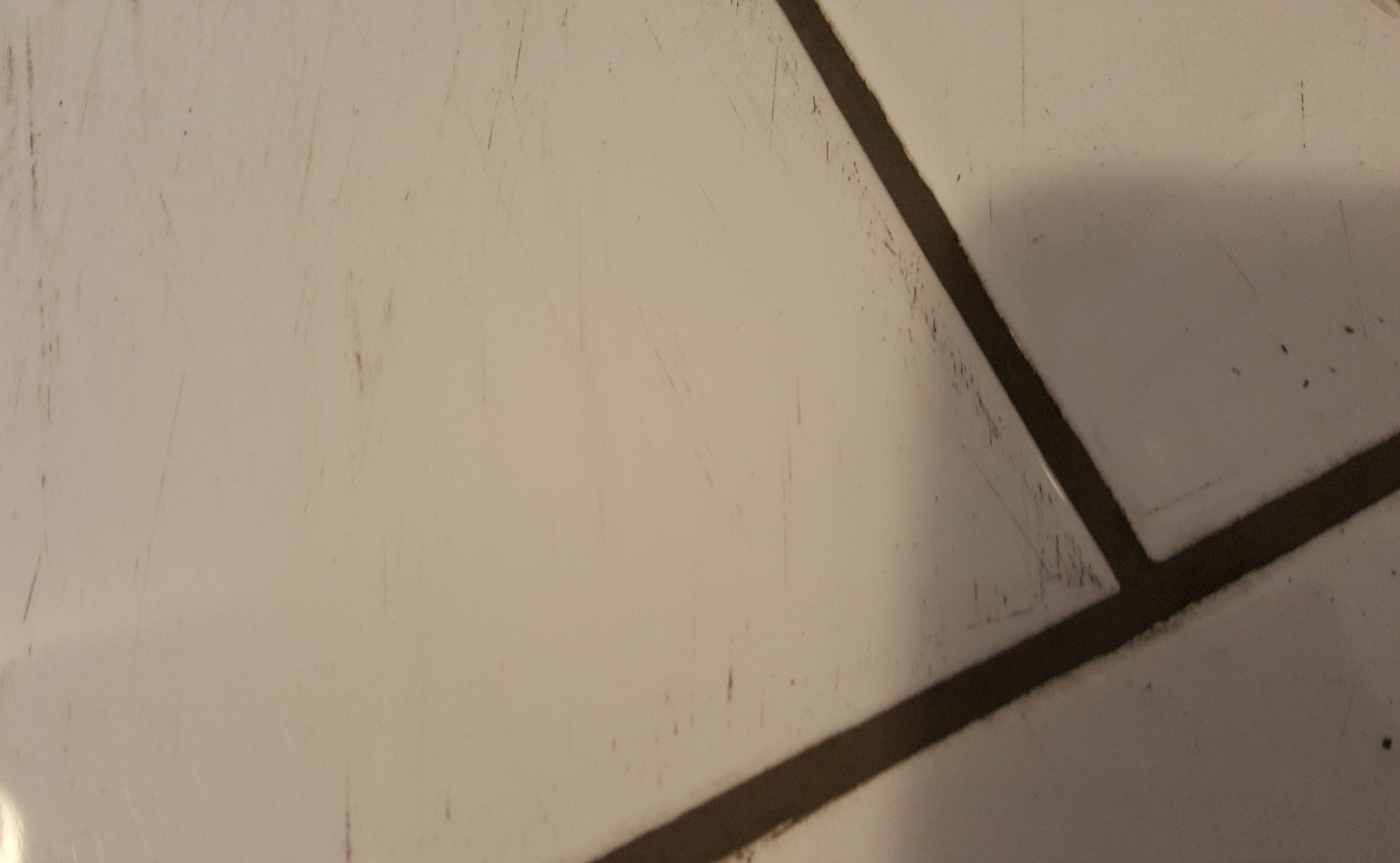

Anyone else used this grout before and had the same problem? Absolutely gutted, ruined all my hard work,time and money putting up tiles. Now have to take everything down. Nightmare. Any recommend grout that does not do this. I used ultracolour plus before and never had an issue, so don't know if its the ceramic tile or a combination of both.
Dumbo
Have you considered that the tiles were already scratched but didn' show until you got some dark pigment in . I have used a lot of Mapei ucp in fact I am using the 113 cement grey now. I have used the 114 anthracite before and not had this problem . I would probably point the finger at the tiles and not the grout . Maybe get a tile check it for scratches ( rubbing with a grubby hand normally works ) and then rub some grout on it and see if it scratches. I will be very interested to know the outcome .
No, that's the first thing I checked. Found a few people who had this same problem with anthracite. I used ultracolour plus grey grout before too no issue. I the process f removing them. :(
Personally I don’t beleive the grout has done that, I think they were already scratched prior
To grouting.
Maybe. Bit cant see with my eyes, unless grout brought them out. but heard a someone on here have the same problem in the past, also a couple reviews. I will be extra careful and inspect tiles individually next time.
As I said earlier pigment in grout got in scratches or as you say grout brought them out .

I've just used 114 UCP on white glazed tiles without any problems. As above, I think that scratches were probably there but not noticeable until the grout was applied.
