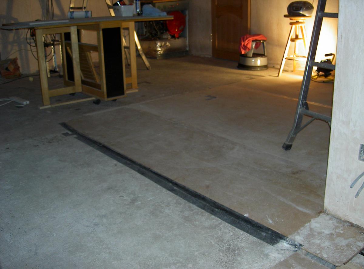

I'm now tackling the kitchen floor and would like some input as things are not straight forward... The kitchen is approx 5m x5m. 1/4 of the floor was floor boards. This has been ripped up, the joists replaced/strengthened and 25mm marine ply screwed down. The other 3/4 is concrete with I suspect, no insulation and has a slight gradient of 15mm. I've laid the height of the Ply to the highest part of the concrete floor. The plan is to tile the floor with a slate style tile (not chosen yet) and have electric UFH.
