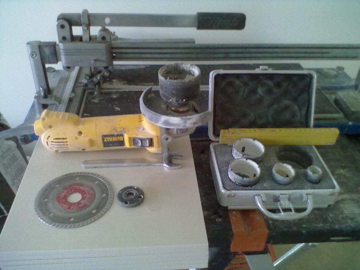

I use these, wear out quickly on hard tiles, for those we use the wet cutter but these are great on most tiles we use

On a more serious note I've never tried them Martin but I do like the porsadrill cores. Will have a look at the montolit ones.
