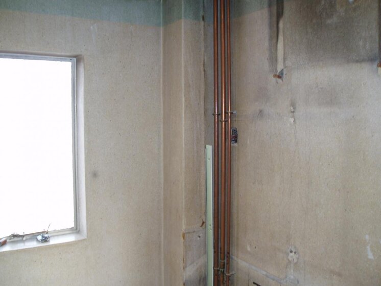

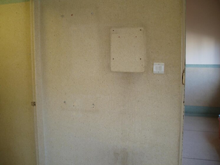

Started another terrazzo restoration in Fulham on Thursday,
thought i,d share some photo progress. the job consists of 3 ladies toilets for the lbhf (hammersmith & fulham) social services.
the work process i,m doing is complete strip of terrazzo walls & floor,
wet diamond polish to a 400 grt finish then a 400 resin bond pad finish on floors
some minor repairs where any fixtures removed.
