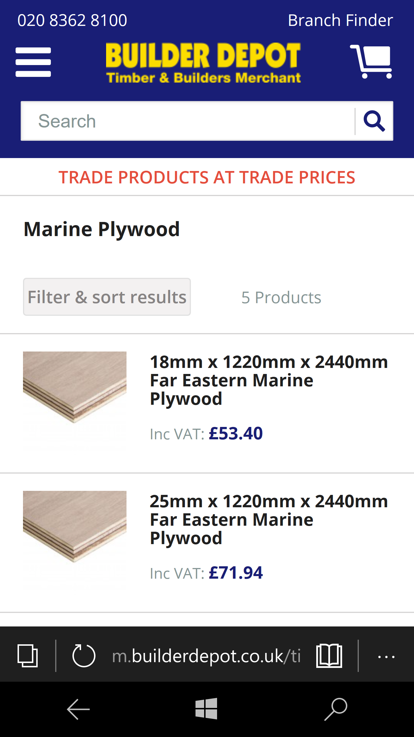

£20 for marine ply! Can I have some too? 😀
Ive estimated the price but I reckon itll be about £22 plus the VAT 8x4 sheets of 18mm marine ply from my supplier.
I do know for some reason the 22mm jumps hugely in price... I think that was about £45 a sheet... I think its cos 22mm is classed as structural ply
dam good price if it is
I get good quality far eastern Marine ply for 28 a sheet at local timber merchant. And they cut it for free too!
nice to know Im buying well... mind you ive spent nearly £30k with my timber merchant in the last 18 months so I would expect good prices... I have no idea where they source their timber but where Ive needed C16 they have always supplied C24, their fence panels are really cheap but use 18mm feather edged board as opposed to 10mm which is standard for the likes of wickes etc... all in all they are a pretty god supplier
