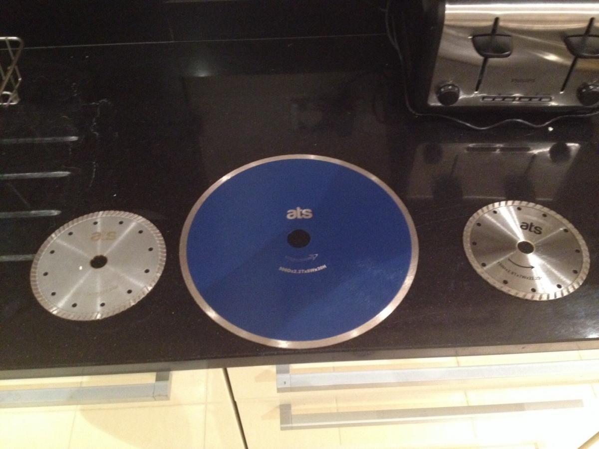

Today, I received the two cutting discs to try out on mistral solid surface. They are going to be used in a standard makita track saw.
also going to try them on tiles.
Just need to work out which one is which??? ( obviously the 300mm is for my wet saw) maybe Allan will tell me if he sees this thread.

The blade on the left (160mm) is a modified Porcelain turbo blade. We sell this a Pro blade for Bushboard and Max Top to be used in a Festool TS55 Track saw or similar.
The blade on the right is a general purpose fine finish turbo blade. This we sell as an economy blade for Bushboard etc.
These are good for stone in a grinder and we sell a number of these to landscapers at 230mm diameter.
If you want to try the Makita on tiles, use the 160mm version.
I'm not sure how any of these blades will deal with high resin content Solid surface so it will be interesting to see how you get on with that.

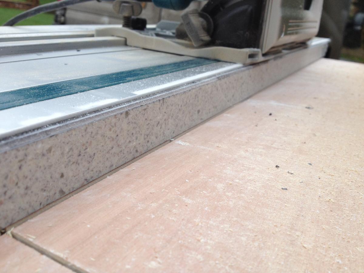

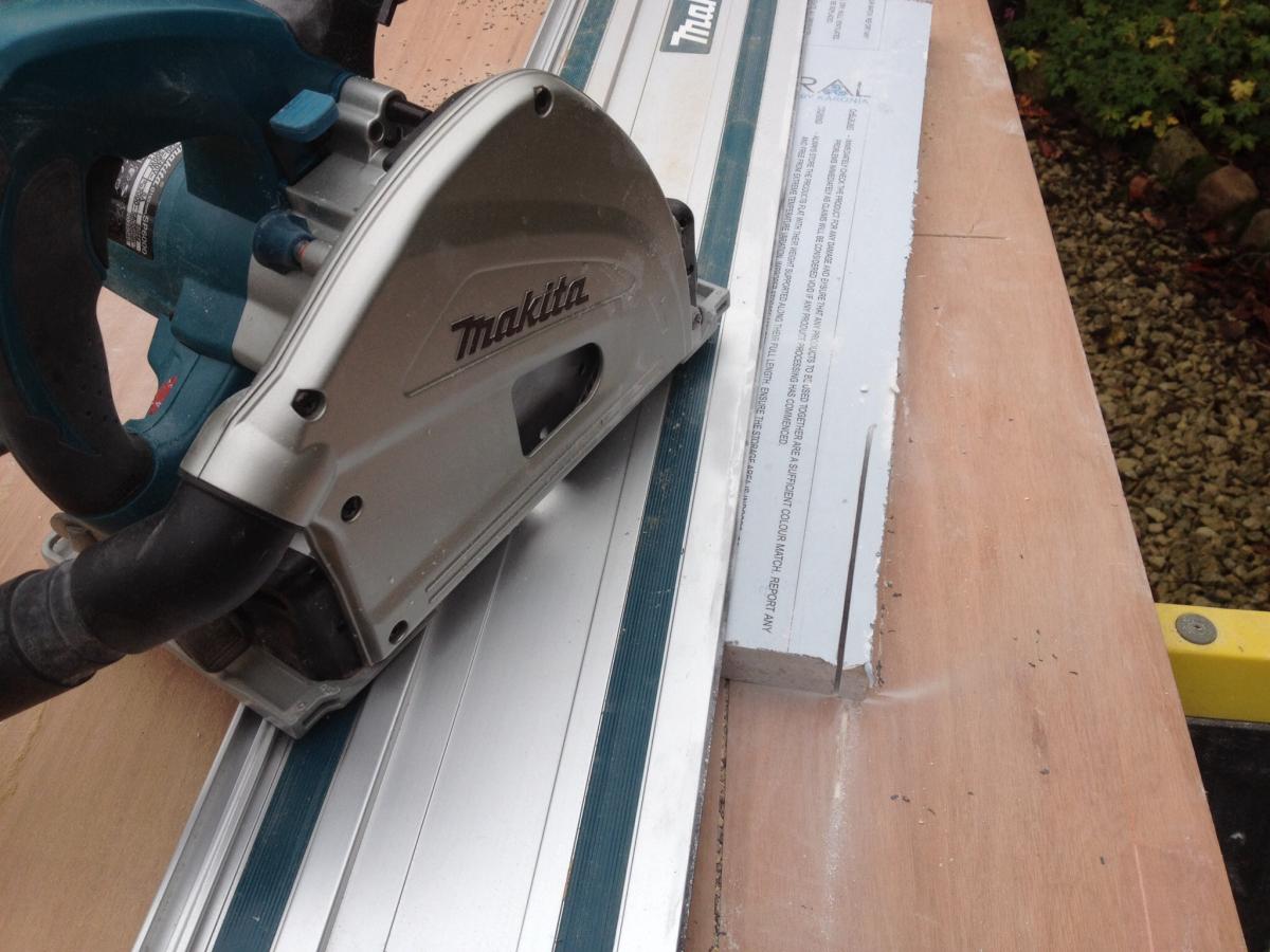

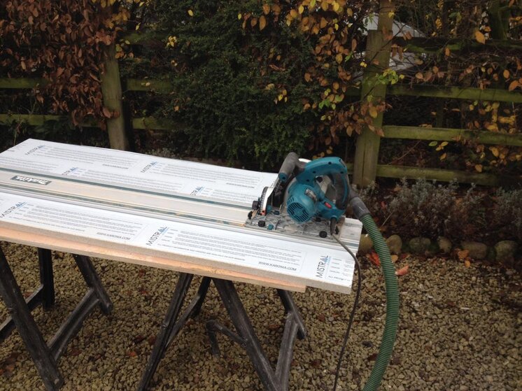

Well, tested the discs today. Good and bad news.
all the blades were brand new. A festool dust extractor was used with the saw.
1st was cutting mistral board with tct blade ( as usual with this product)
fairly easy to cut, with a few cutting marks to the end.

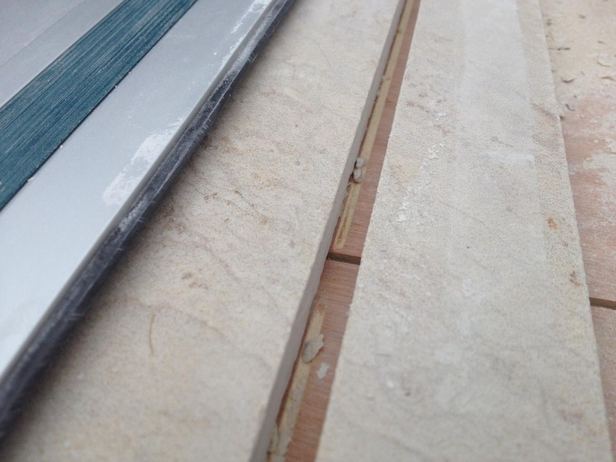

Next was the pro blade, as Allan expected after an inch or two it started to clog, the saw also tried to lift out.
but, tried fitting a porcelain tile and it was brilliant. I in from the far side first to prevent chip out. At first tried two passes, one half way and then fully through. Got to say it's not far off a wet saw cut.
Last one was the turbo blade.
this did cut the mistral board, but was very slow. Tried it on porcelain and was ok. But not as good as the pro blade.
In summary. I will be sticking with a tct blade for the mistral board. But I think using this track saw with the pro blade and dust collection will be in some cases better than setting up a wet saw. If you cut through in one pass, there isn't much dust.
I think this will come in handy when straight cuts are needed in large tiles.
hope this is of some help to the members.
