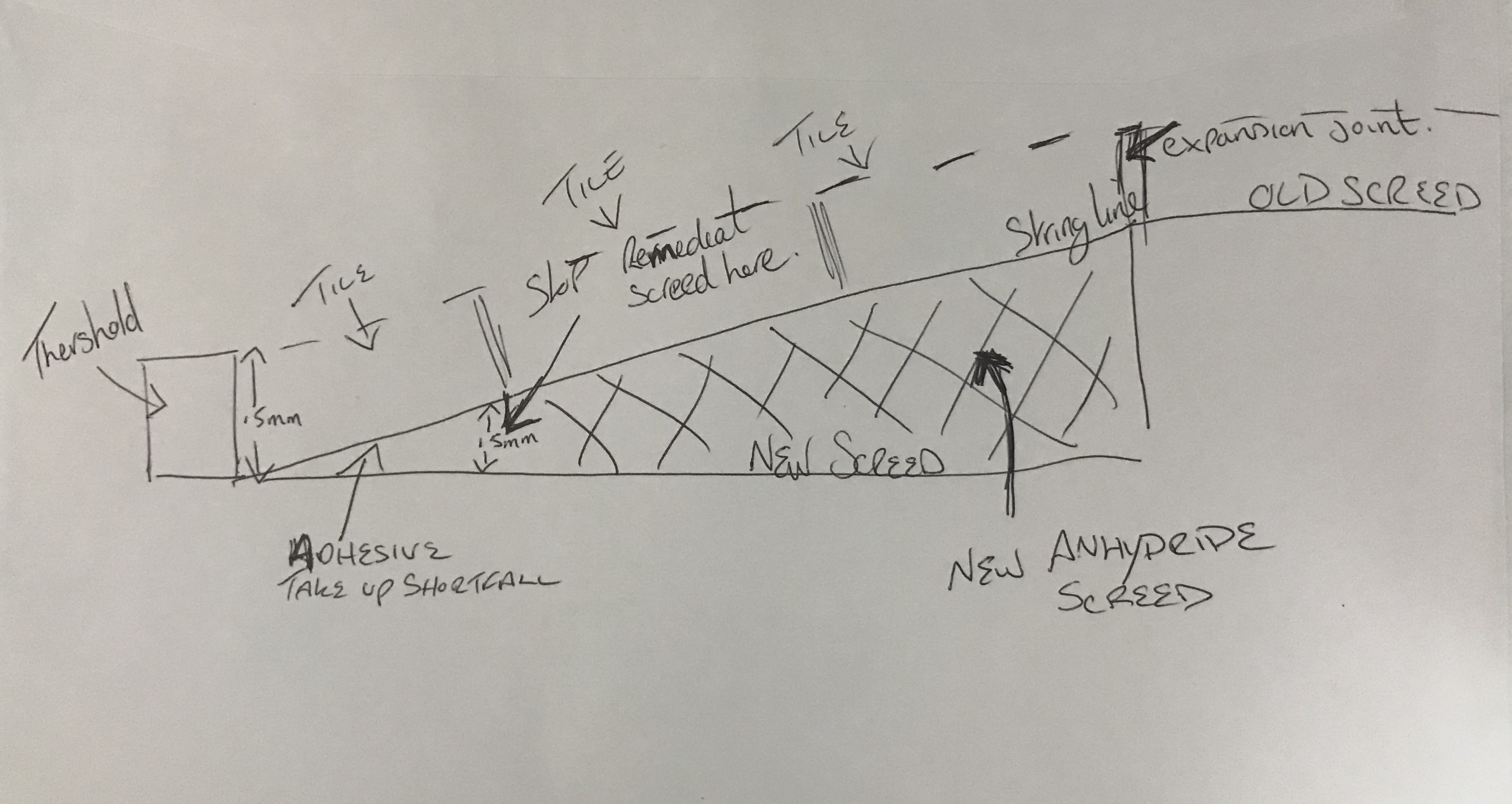

40mm where the new meets the old and 25mm max at the doors. 15mm at the doors doesn't give you much to play with once you have 10mm tile plus adhesive so you'll need to be careful. I think you'd lose the other 15mm over a 5m span without noticing.
