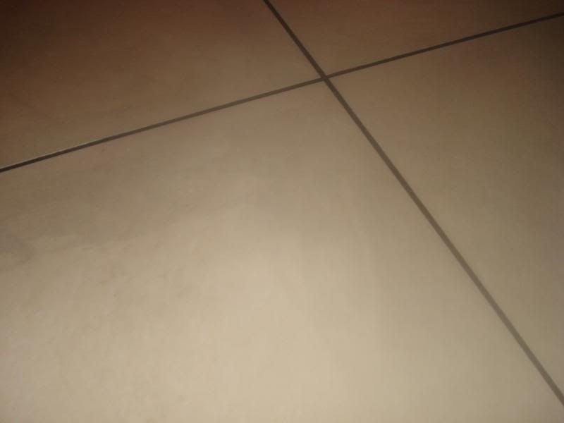

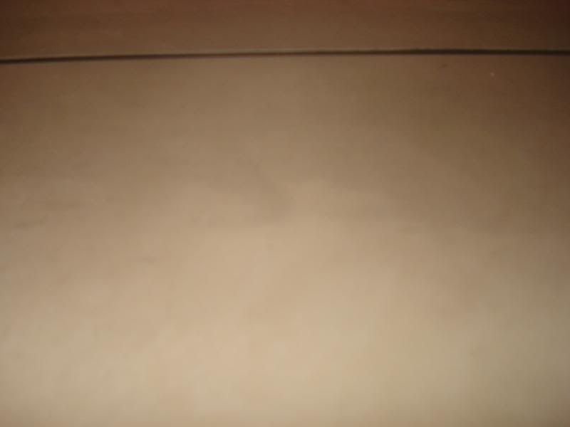

Sorry to hear your dilemma, did you seal them before fixing edges as well as face? some of this stuff can take in a stain from the joint, if edges are not sealed, causing a picture frame effect. there are some products that could help. Maybe some pics for more detail:thumbsup:

Cheers Dave will do, just trying to put pictures on via photo bucket what code do you use on here?

Ok the pouring of grout was because we used a squiggy (sp??) can you advise another way please as we still have 3/4 of the floor to finish....
As i thought.. Try one of the products above and then come back to us after you have tried it..:thumbsup:
