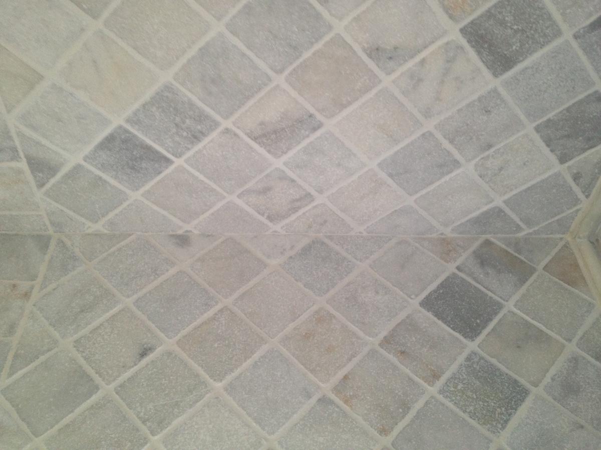

My last post questioned a large extra charge for creating a diamond tile pattern.

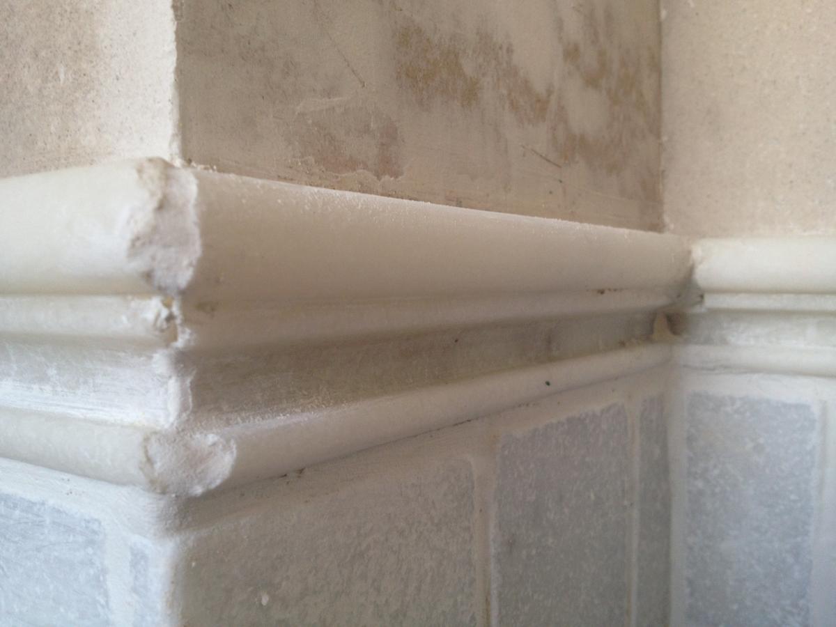

This morning I've had my first chance to look at the job properly and I would like your opinions please.
I'm not happy with the failure to wrap the diamond pattern around the corners but that aside it looks fine from a distance.
However on closer inspection the jagged and untidy joins in the bull nose dado where it goes around a corner don't look pretty at all.
I understand it may be difficult to cut neat 45 degree angles in marble but is this finish acceptable? The cut angled dado sections seem to have lots broken off and the damage filled with grout. One corner is actually so jagged it's razor sharp.

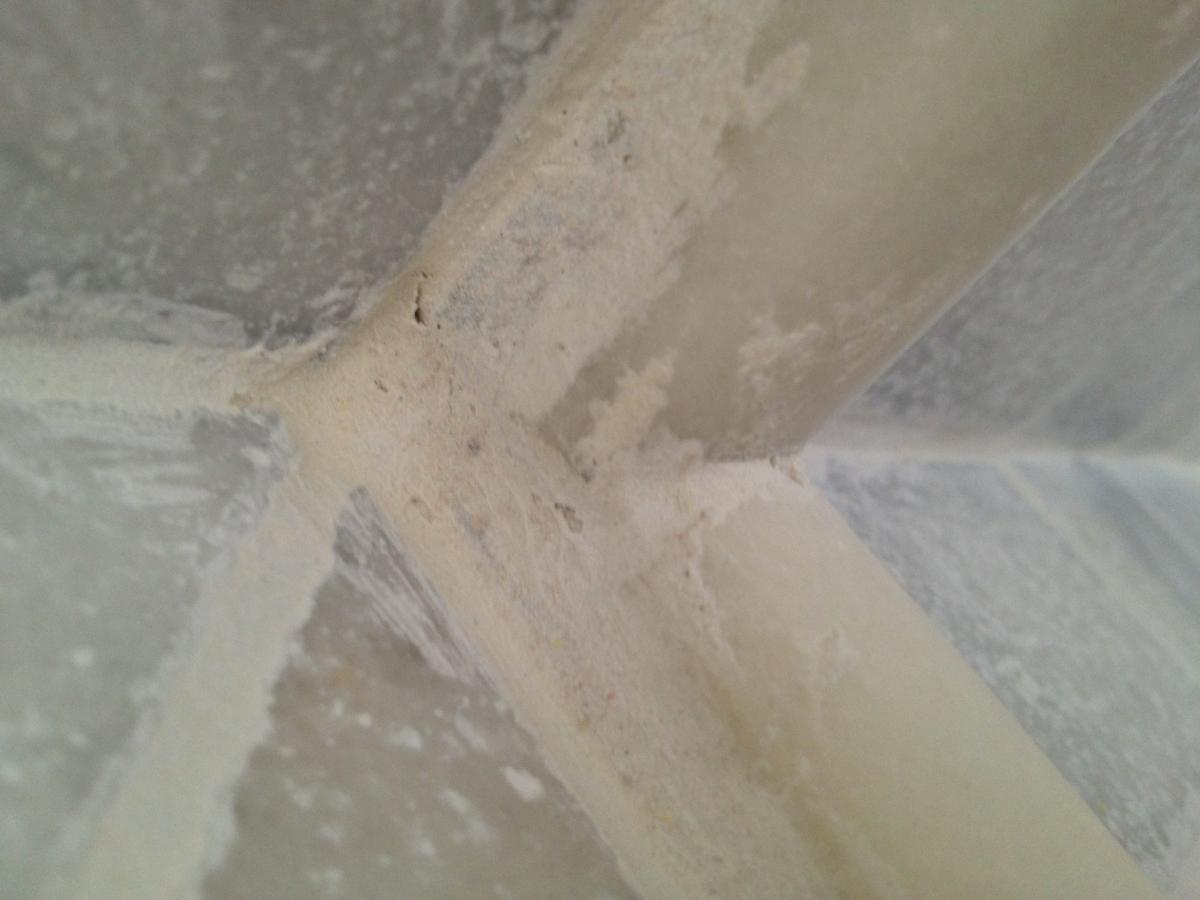

There are quite a few gaps in the grout which won't help the water resistance.
There is also lots of excess grout which isn't coming off.
Am I being picky or is this a good overall job?
Your opinions would be appreciated.
Thanks

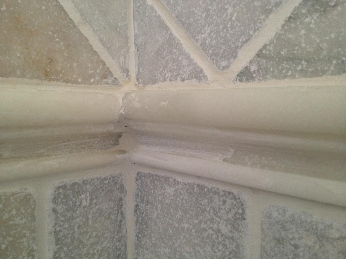

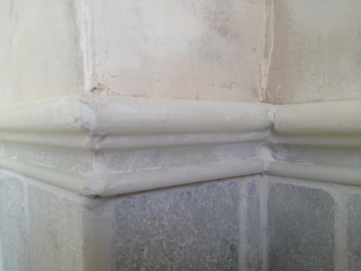

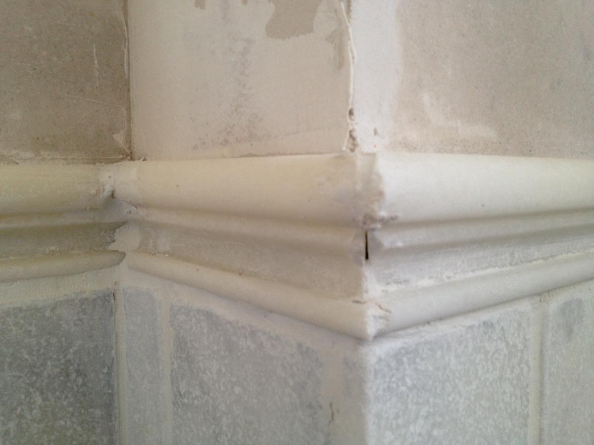

tuthai
As I feared.
In the corners he seems to have cut square(ish) notches out of the dado to slot the other piece in.
I'm no tiler but surely a straight 45 degree cut would give a perfect neat 90 degree turn with no need to fill the damage with grout?
Is straight 45 degree cut normal?
It seems much harder to try and cut a notch doesn't it?

I doubt you'll get them off in one piece to be honest.
With each picture you post it gets worse. I know somebody said in the other thread that people shouldn't pull apart the standard of work when you were just asking about the extra cost and you were happy with the work. But to be honest I'm glad some did comment as that work is well below par and for the money you have paid you should be expecting an A1 finish and that isn't it!

he aint mitered the internals at all,he has cut a bit of the top profile and tried to slip the other in,a bit like doing a internal on skirting with a coping saw ,its horrendous, and the external,erm,its horrendous .
i think the builder will know this as well,just tell him,if you get on he will understand
