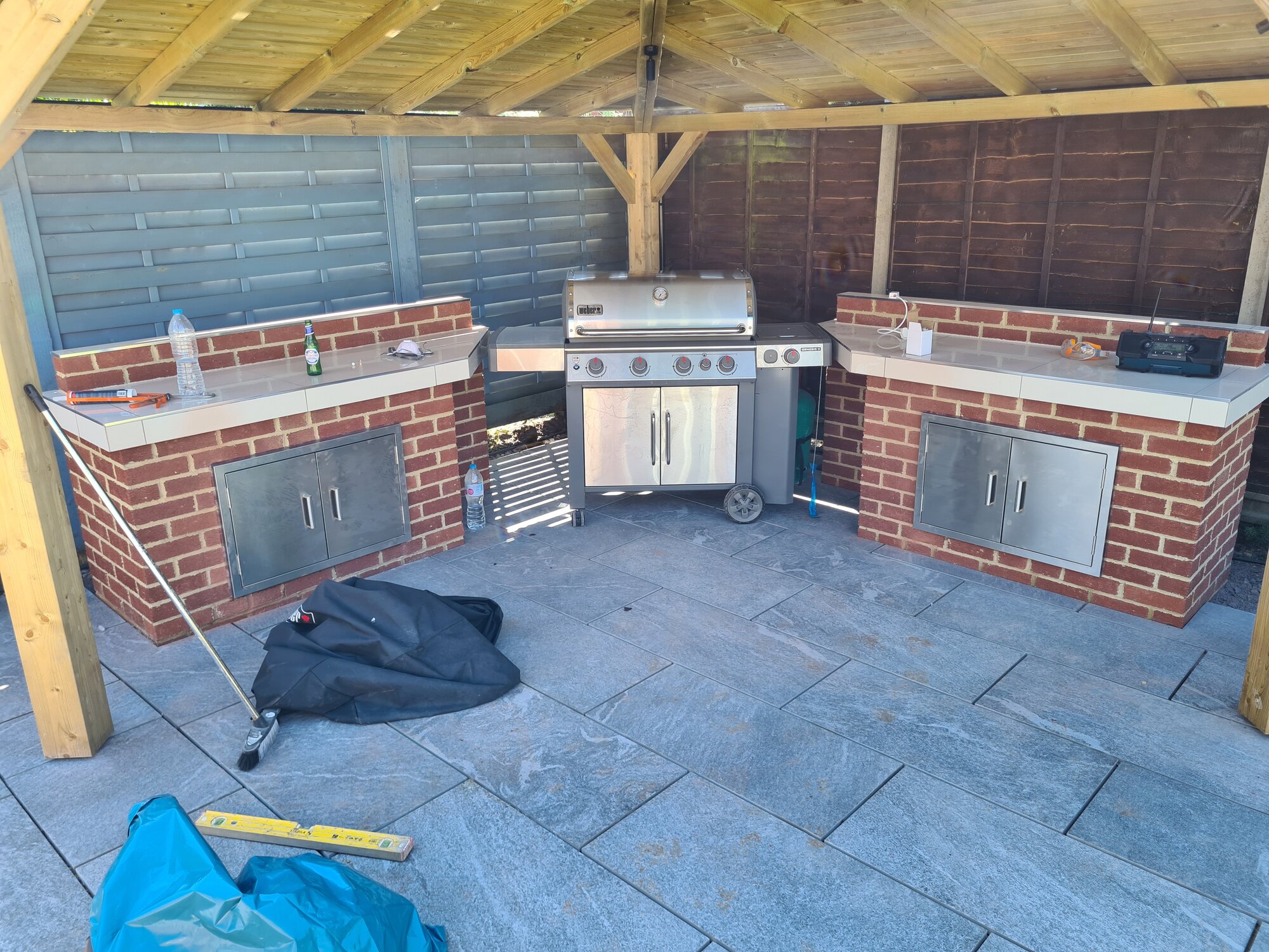

I have two counters under a gazeebo, brick walls with a concrete top.
I pre-cast the concrete 100mm thick, and then bedded this onto the brickwork, this was then tiled with porcelain tiles on the top and sides.
I looked at a polished concrete counter top, but this would mean shuttering and pouring the concrete in-situ, whihc is a lot of work, and then even more work involved in polishing it. I too looked at granite as an option, but, worte it off for the same reasons that you did
Thank you so much for your response. I understand what you did. I also thought about a concrete top, but between building the frame, getting the bubbles out and then polishing the top, the idea was trashed. Thank you for your assistance. I'd love to show you my counter tops, but I'm sure it would be at least 1 month before I can finish. If I can find you on this site again, then I will.
