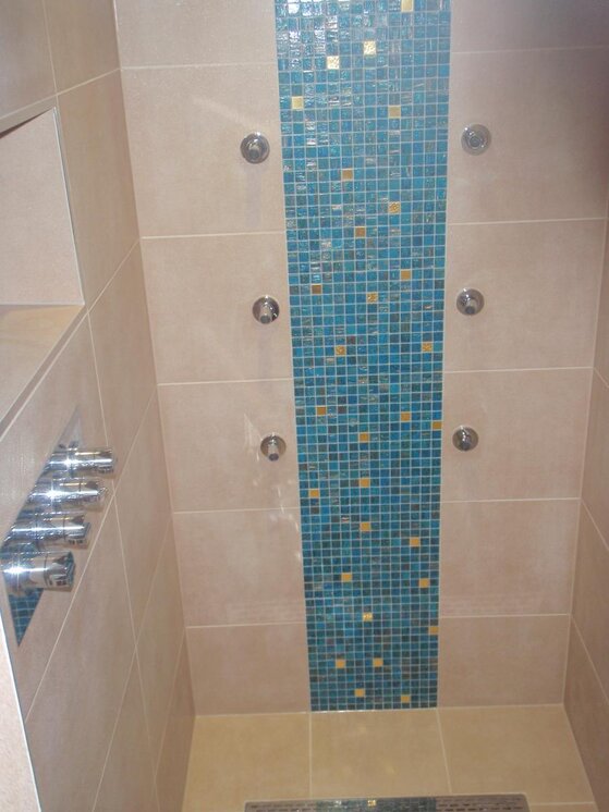

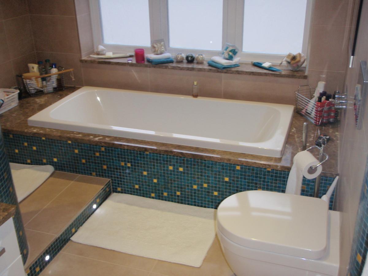

P2100029.jpgP2100031.jpgi never normaly use ply on walls but i used flexy ply for this glass mosaic fixed with opf rocksolid
