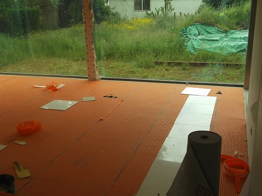

Thoughts on the set out for the glass room.

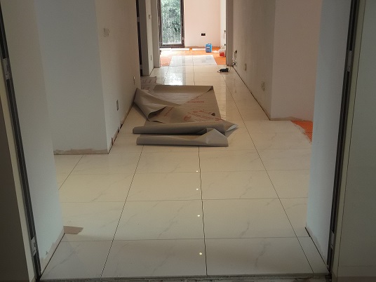

The tiles have been centred on a 20ft glass front entrance which then then runs through the hallway.
Any thoughts on wether to centre on the vertical post in the glass room or run the grout lines through from the hallway continuing into the glass room but that will off centre the room.
There is to be glass steps so there is a kind of break in the 2 rooms.
Cheers.
Kevin

you must follow the tiles you already have down if you want this to flow .as gary said then you have to work back to front i would probaly start full tile from the windows and work back if the windows are square as the step down will give you a 300 to 400mm look to were the next tile starts depending at what lenght you look at it from

The steps are not tiled and are glass so there is a type of break in the continunity of the grout lines. Either set out leaves a very good cut on the right side wall. Black ash skirting boards and a 150mm black ash border between the window and the tile. From the main door following through would look great though get to the top of the steps and the glass room looks to be crying out to be centred on the post. I suppose white grout will appear more subtle. I don't know what has happened to the addy looks like my 4 your old has ran threw it!
