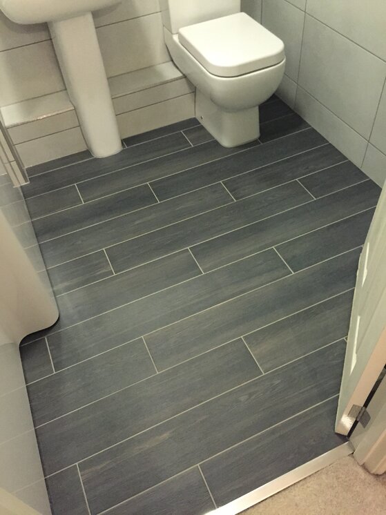

Here's one I've just done, used the offcut to start the next row, gives a nice staggered look.
In this case, it worked out that I had no wastage at all, because the longest pieces you see to the right hand side are full pieces. I did think about doing random bond, but there would have been more wastage and more work this way and as always, time was of the essence
Customer was more than happy though, and as you say, that's the main thing! 🙂
