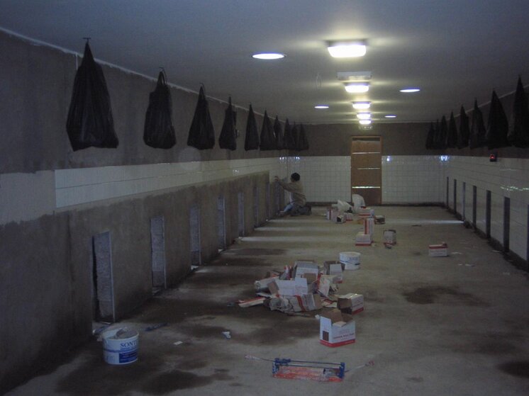

Having spent half my life reading this thread id like to add something , its crucial in my mind to use a quality laser (like the autocross laserliner or similar) especially when fitting large formats as the slightest out of level can cause big problems especially over larger areas, even with a good spirit level you can be out .. heres a pic of me using one in a floor area of 100m2 , the laser is on the right of the pic on the wall . the datum matched up 100% over the area , try that with a spirit level.. any way good luck tileboy and one last piece of advice try and hook up with an experienced fixer its the best way to learn.. :thumbsup:

What is that room used for Andy? keeping animals? looks very interesting
dog kennels !! and it was blimmin freeziing , the wind howled through the apertures for the outside runs.
there was 80m2 of white 6x6 wall tiles and 100m2 of floor tiles which the bloke got for £5m2 , they were different sizes tho hence the brickbond pattern. took 2 of us 5days and it took us one day to grout the floor , forgot to bring my kd washboy too so that was a bit of a chore , it was a nice little cash earner though!! :thumbsup:
