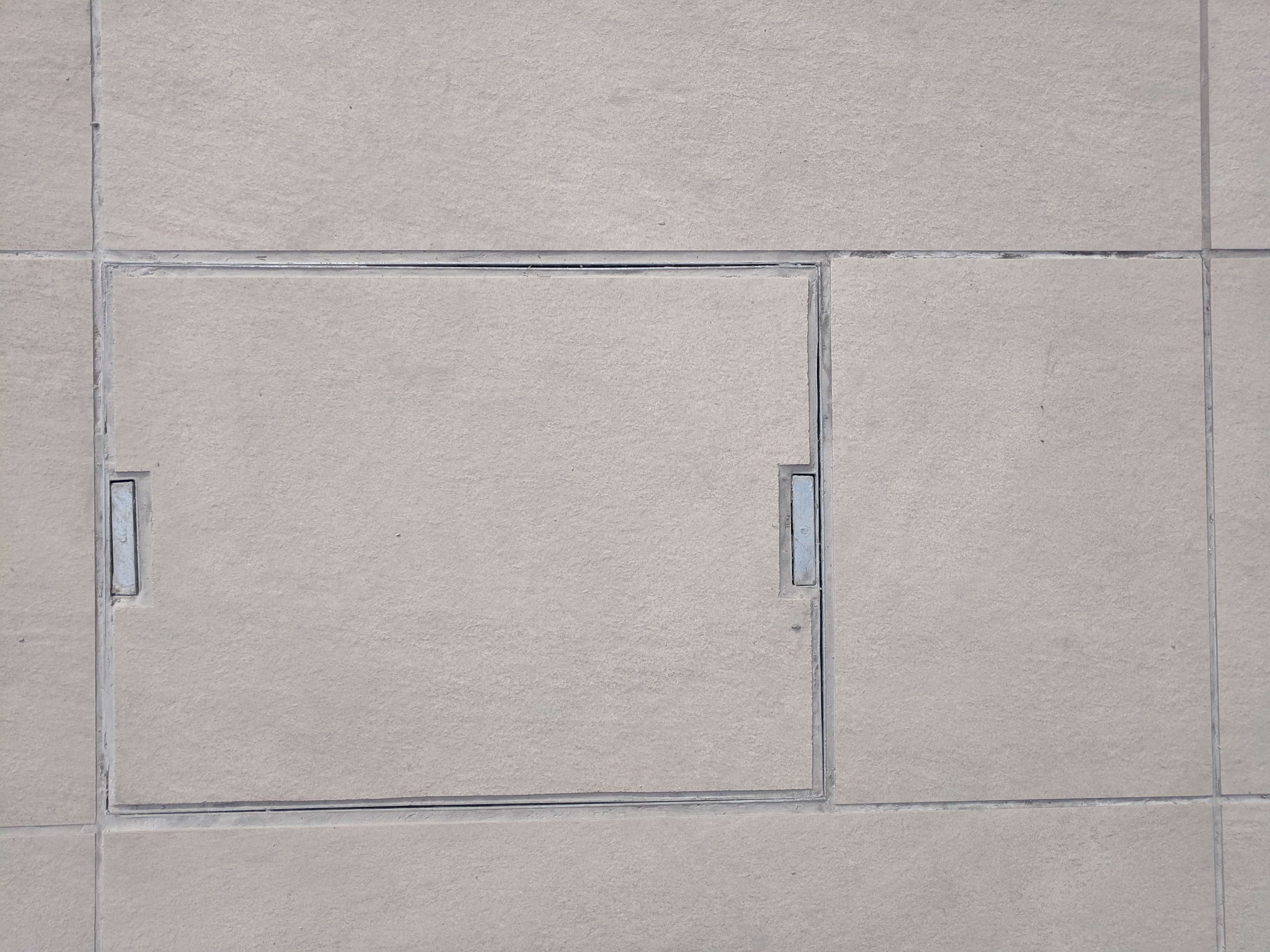

Concerns:
  • Unacceptable lipping
  • I requested 2mm spacing, they changed to 5mm (due to lipping) without consulting me

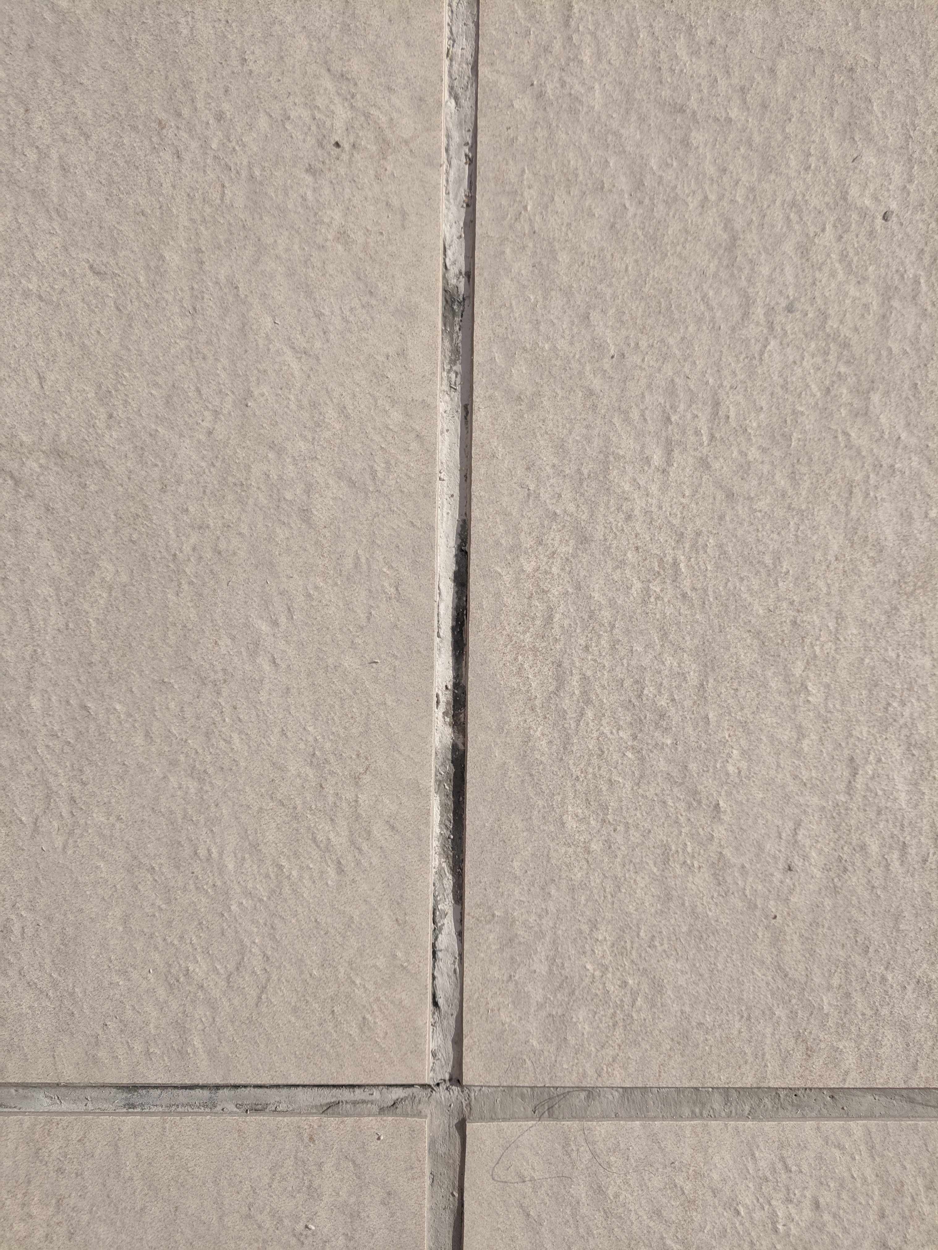

  • The grouting is horrendous. Discoloration, probably due to over-washing according to grout rep. Extremely lumpy and uneven. Already cracking.
  • When replacing chipped tiles, they laid them loose on dry cement with no adhesive, only grout to hold them

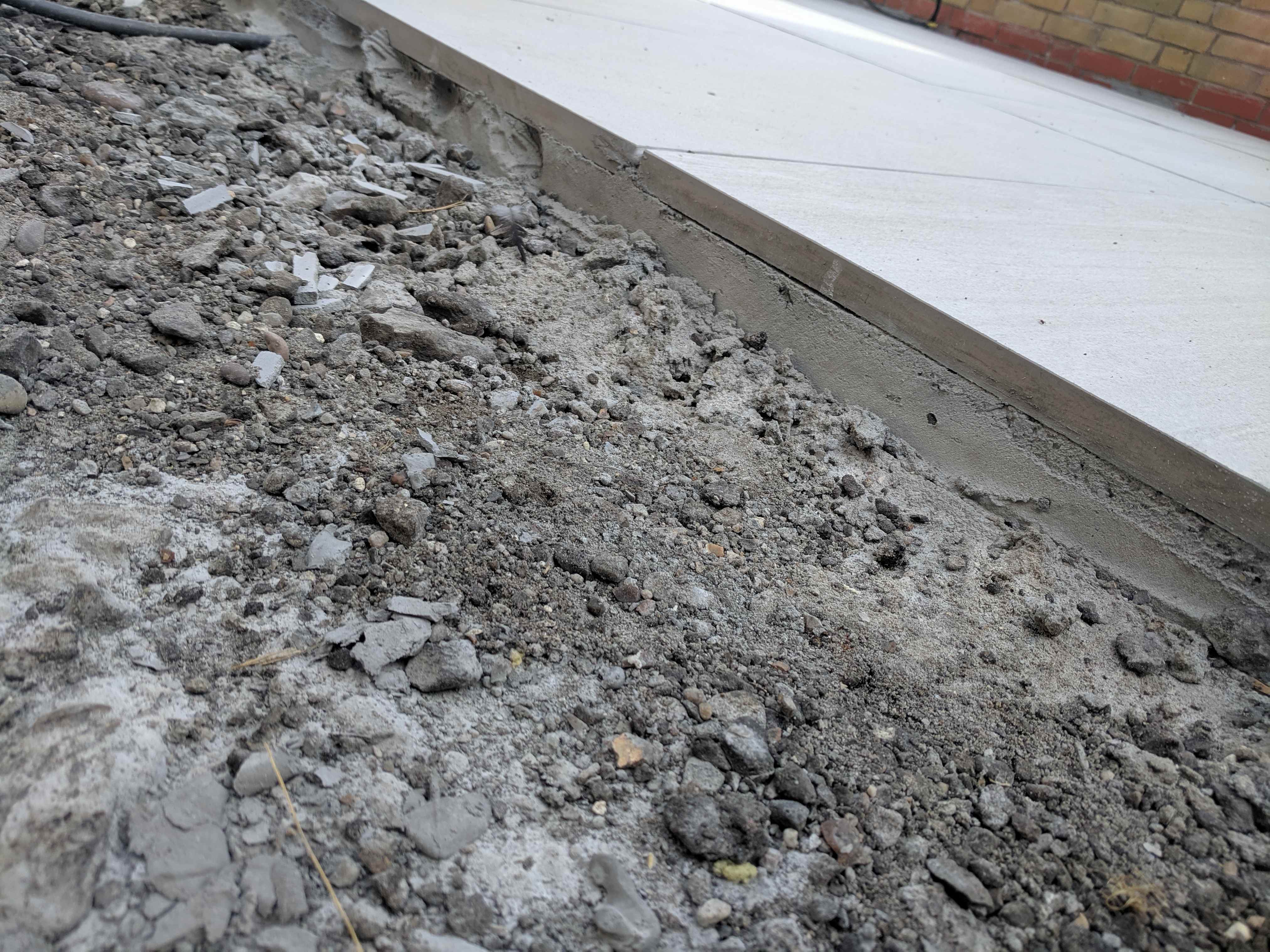

  • Installed on a wet bed of cement without back buttering, adhesive or admix. Many areas sound hollow. Grout rep says patio will fail due to water ingress.
The advice from the Larsen rep was to pull it all up and start again.
Thanks very much for your help.

Hi Ray,
Here are a few.
The Larsen rep wasn't able to identify the correct grout colour because it's so much lighter than expected.
My main concern is the high risk of patio failure due to poor adhesion.
I'd asked them to repoint some areas an they damaged some tile edges as shown in one of the pics.

Look like a total rip out.
Any hairline cracks, loose sounding tiles with freeze thaw action will ‘pop’ after 1st cold weather.
Don’t understand where Larsen adhesive is used or was that the binding to a sand/cement base - what’s under the tiles?
i think most of the tiles will come up and be able to be used again if you cut through the grout joints so you should be able to save your tiles,
for out door tiling i would of done in a sand cement and lime mix on a 50mm bed with a 8mm comb of tile master ultimate to the back of the tile this is the way my m8 dose it and have yet to see any of his tiles lift and hes a specialist patio tiler in stone and porcelaine.
he also preps the ground by putting a base of sharp sand lime and pea gravel again about 50mm deep and compressed using a wacker plate this he dose with a dry mix then sprinkles with water the lime makes the patio breatherble and grouts in chemical patio grout filler
