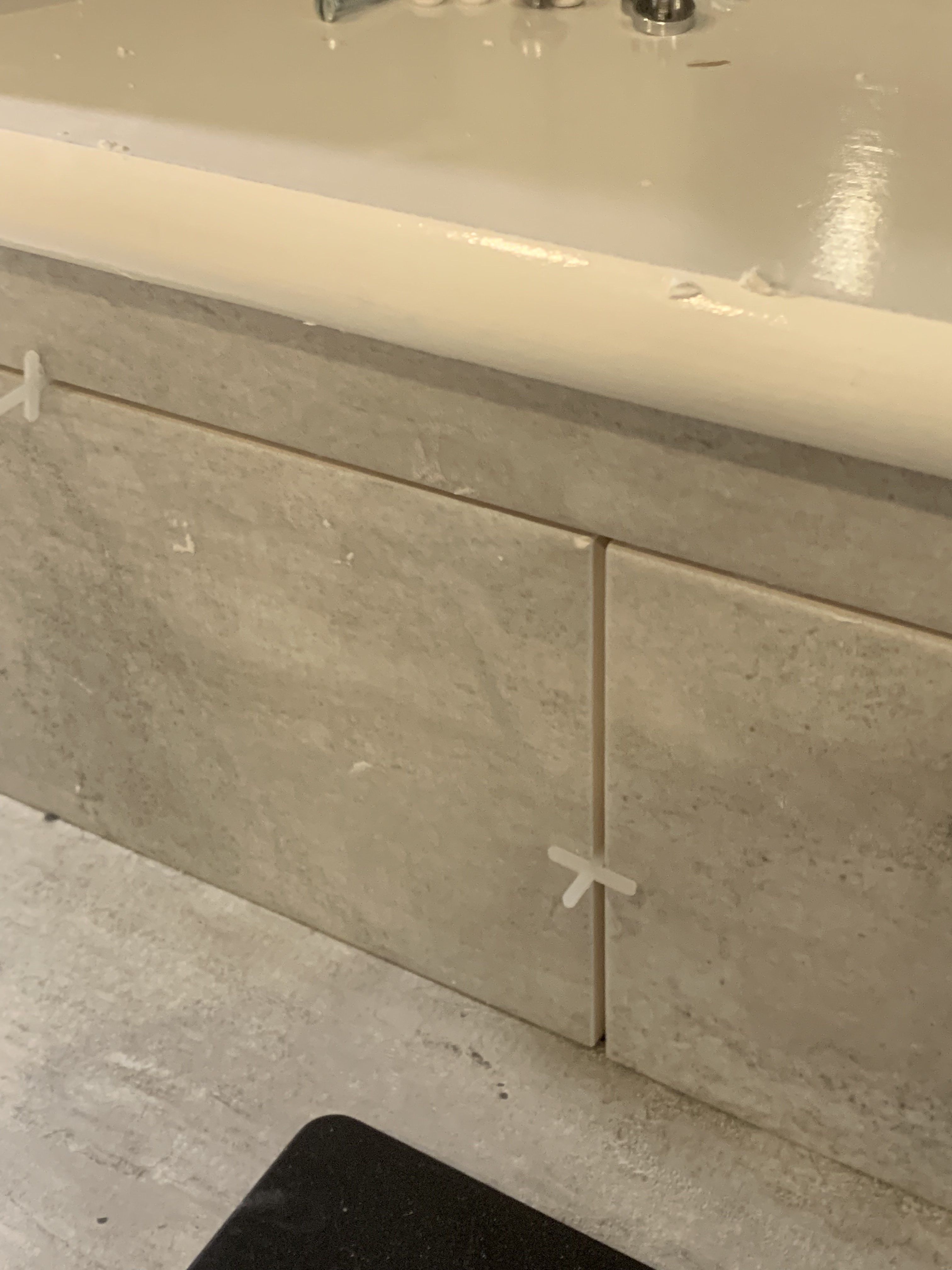

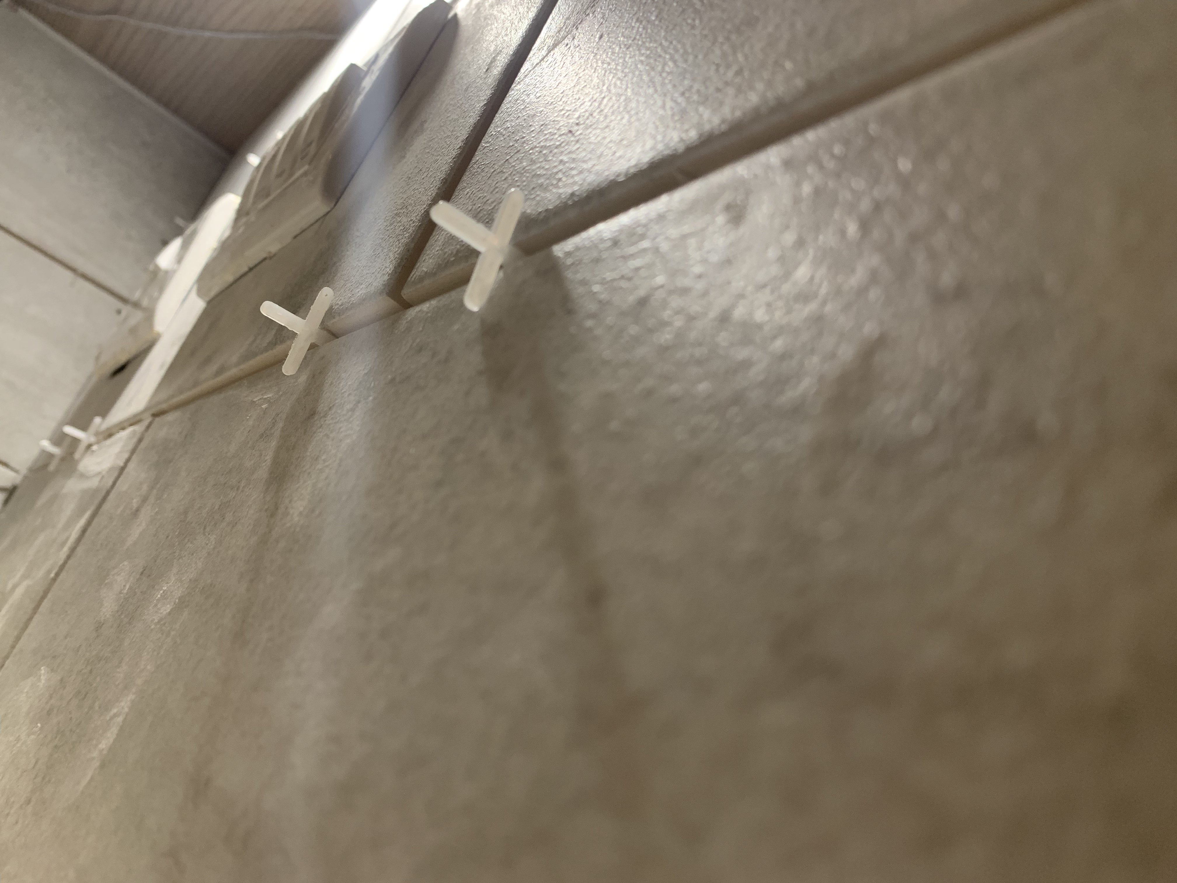

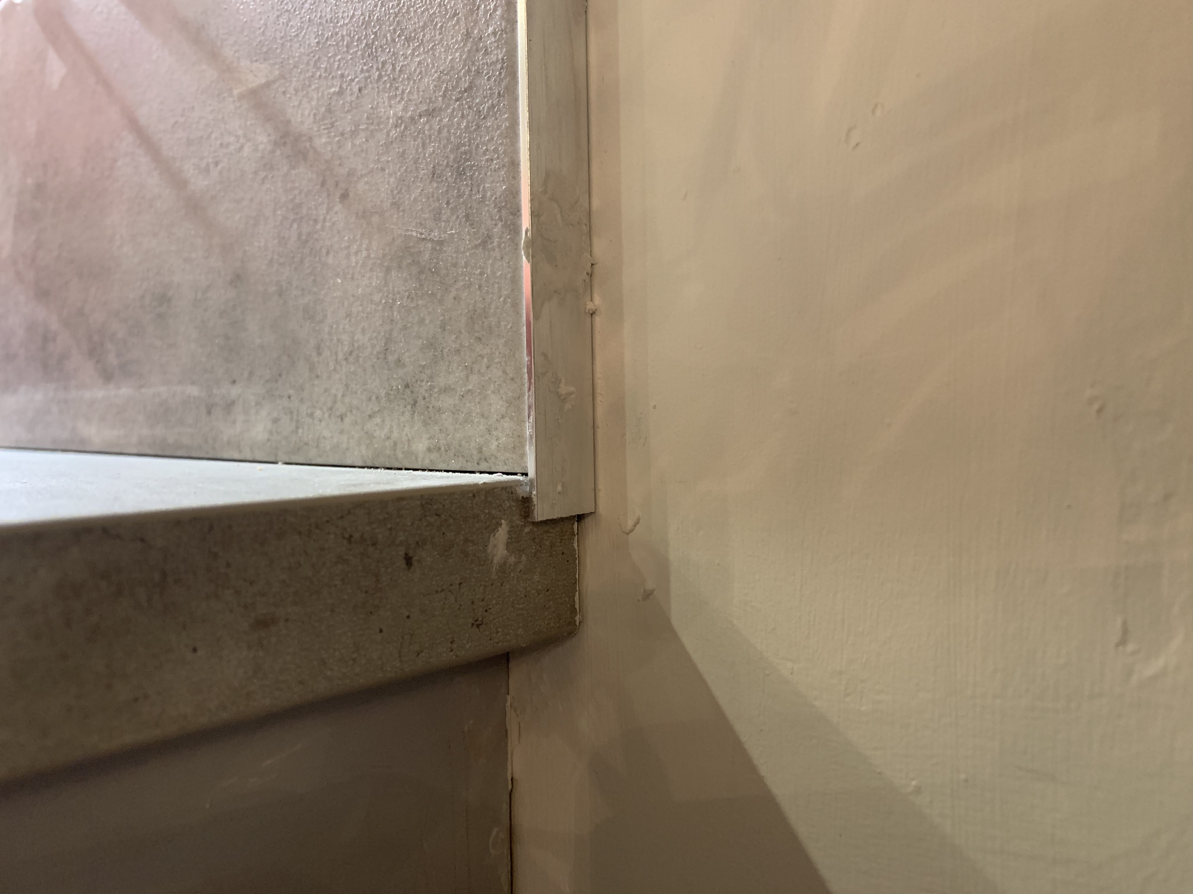

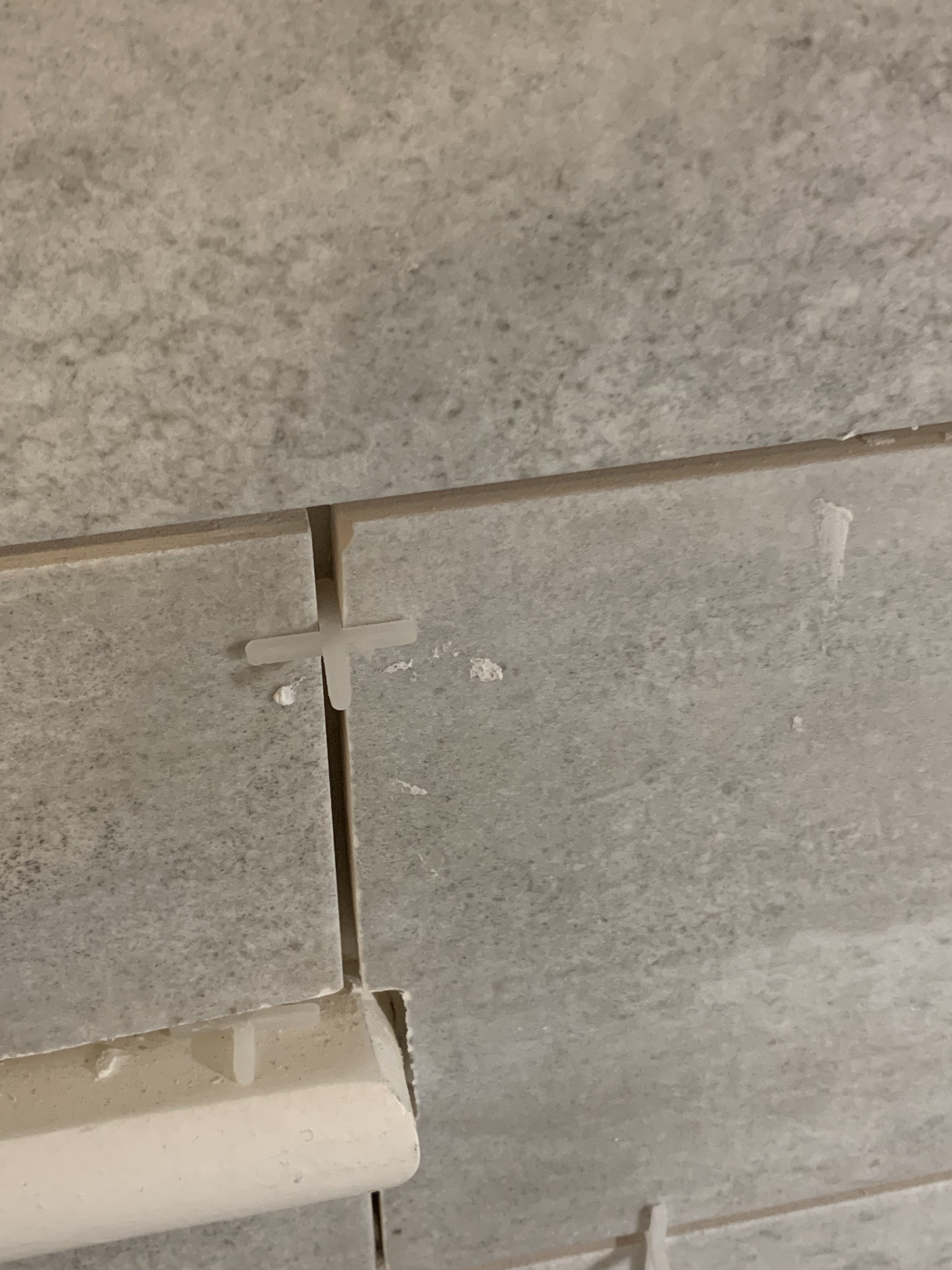

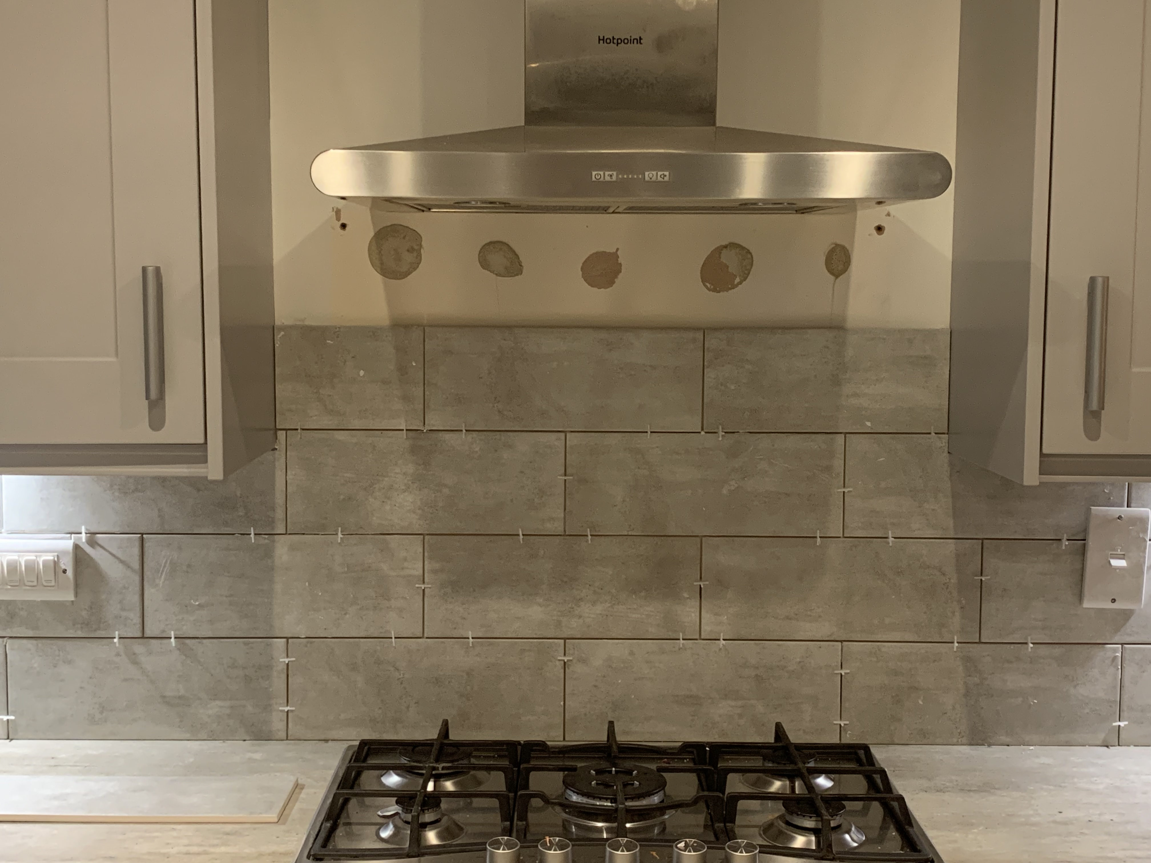

We are currently in the process of having our kitchen tiled and have some concerns about the standard of the tiling so far. The tiler is due back this morning but as of a few minutes we have asked him to stop any works until we can reach a solution regarding the concerns that we have raised to him.
We obtained a couple of quotes and both we near on identical and picked this tradesman as 1) we wanted other works in the house completed and 2) he has great reviews in our area (althoigh im beginning to feel people don’t write bad reviews these days). We were required to provide all materials and the quote was for labour only. He was at the property for 4 hours yesterday and is was due to return this morning to complete above the oven hood to the ceiling and the utility area.
Our areas of concern are:
1) Dot and Dab looks like it has been used to apply the tiles/adhesive. I believe this to be the incorrect way to apply the tiles and this method is also not the method detailed within the installation instructions on the adhesive.
2) tiles not flush to the wall/ adjoining tiles. Uneven surface which I feel could be down to the dot and dab installation.
3) Tiles cut to short around electrical sockets.
4) Installation of edging trim to a poor standard.
5) Poor finish to tiling cuts around under counter lighting.
6) 2x tiles with chipped corners.
7) One tile has been installed with cut edge within a tile run. This tile also does not have space for 3mm spacer.
8) tiling by oven hood has not started centrally with the oven hood/hob causing cuts to be off centre to the left.
Are our expectations to high? We have asked for a complete take-off and redo due to the amount of areas we are concerned about.
What are your thoughts?
3D20DB06-7559-46C1-A15D-4701A72D5F9B.jpeg 95DF384E-ADE6-428A-AFFB-5110EEE0F56F.jpeg 48585C03-4531-4586-B5EF-EAC8D48A2108.jpeg 4E16B159-F35D-465E-931A-138DFFAEEA19.jpeg 013D1EE2-F120-48E6-8586-F85AF8830B6F.jpeg 94A55C40-9408-4408-856E-28613070F8EA.jpeg F603C6EA-BF97-4445-B862-1218B1FA32AA.jpeg 60C39BD3-7656-419E-8723-FF1279E3CA12.jpeg ABBC4535-18BA-4E28-B736-15768C052D12.jpeg FBFF7117-A8D8-4D28-A480-D8BB885F2768.jpeg 440FE094-C72D-428B-926A-B56E58E680D5.jpeg 0BEC6655-9821-4595-9179-6D932A6D00ED.jpeg 10646D6A-3A43-49CF-B2AC-745417EC3062.jpeg CA7869D3-2159-4C05-A0E1-948A3E93CF29.jpeg
Cranbrook
You mention you chose him because you wanted other works done? Is he a general builder who does a number of trades or is he an actual tiler? I'm not suggesting there aren't builders around who are excellent tilers, but one thing I've noticed is that the majority of builders think that they can tile as it's 'easy' and then they produce work like this where the attention to detail is missed. And furthermore, it's usually these type of builders who undercut us tilers, and then more often than not, win the job. But as the old saying goes, you get what you pay for (most of the time)
He’s a handyman, so we were looking to get him to finish off the kitchen (glossing, tiling, sealant etc) We looked at previous pictures of his worked and all looked good. As the tiles were large and what we thought to be uncomplicated we weren’t expected any problems. I’m not a tiler but even I know some basics of what to do from an appearance point of view. He’s was £60 cheaper a than the tilers quote but we were providing materials whereas the tiler was providing adhesive etc so we thought the quote was a fair comparison
Waluigi
This sort of thing is quite typical these days. It’s not the worst I’ve seen but still shows a complete lack of conscience and the opposite of what a good Tiler strives for - perfection.
Either a general trade or very poor Tiler. It’s irrelenant really who did it, it’s not acceptable either way.
In answer to your original question; No you are not being picky.
acaciaguy
387
568
Warwickshire
Possibly. It depends how well adhered the paint is to wall. It is in effect the only thing holding the adhesive and tiles. If d and d was used I’d be a bit more concerned. Personally I never like to tile on to paint. Some do but only if they have tested soundness of the paint and provided some key such as sanding or wire brush to remove a proportion of the paint.
