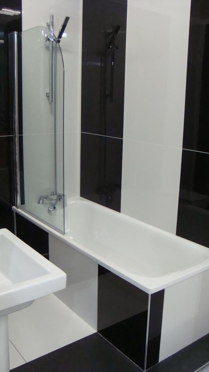

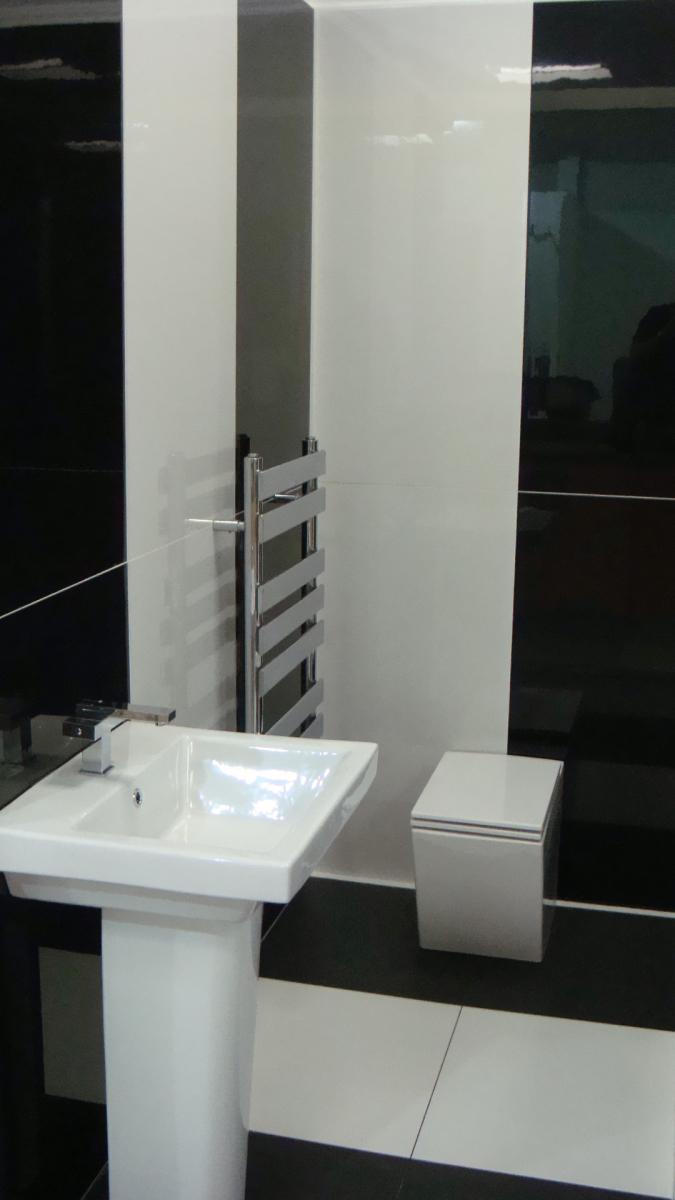

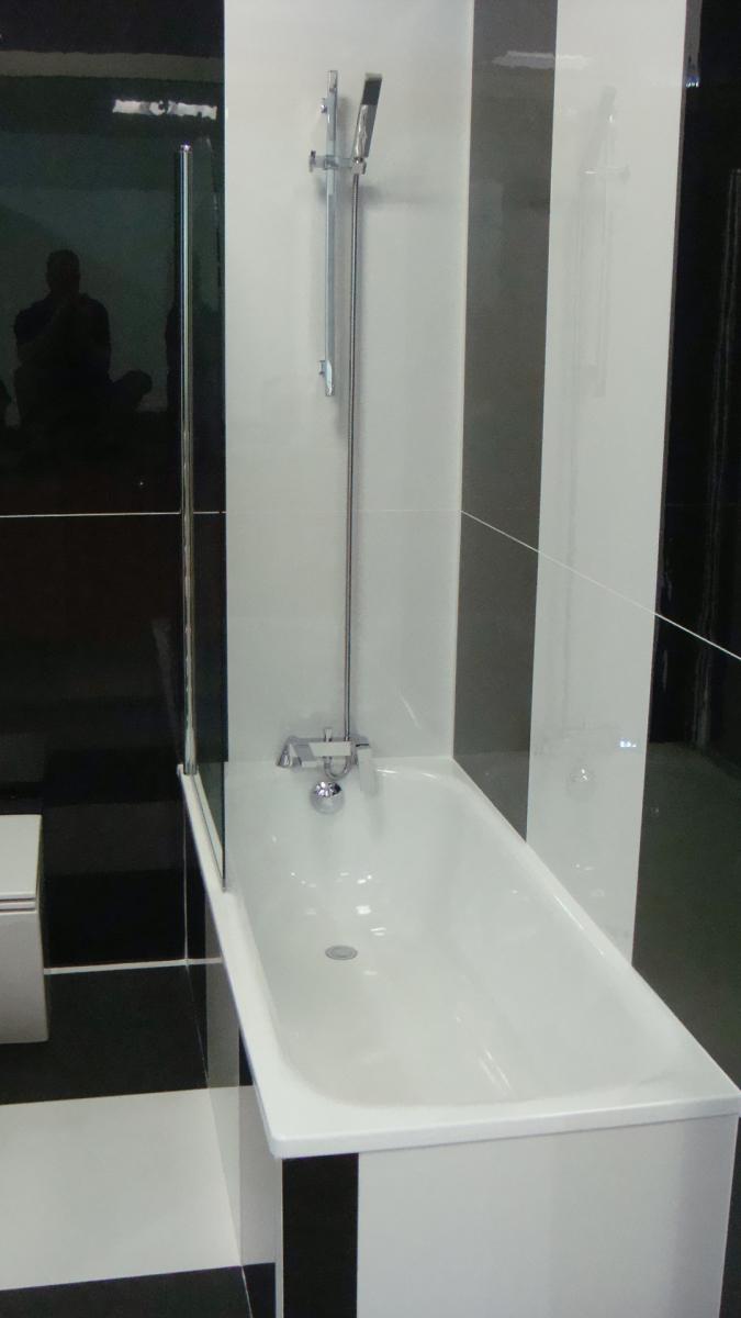

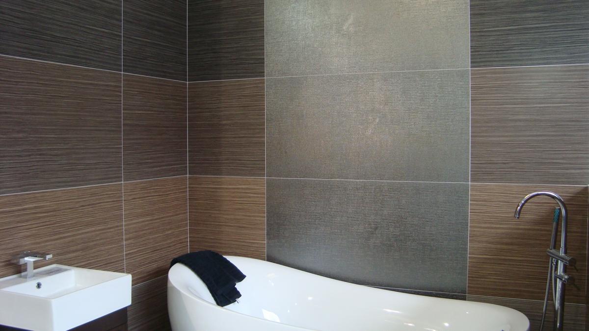

heres some pics of thin tiles in a small bathroom DSC03898.jpgDSC03899.jpgDSC03902.jpg
They do look huge next to a shower! Puts in in perspective that doesn't it.
Iv'e just done a job this week with the B&Q 4mm tiles , and to be fair they were really nice to work with :hurray:
