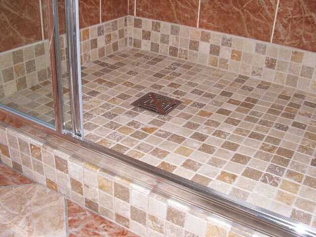

Here's one I did a couple of months ago - wet room floor.
The wall tiles were already on, just had to remove bottom course & tie in - so don't blame me for the nasty sliver cut on lhs.
Regards
