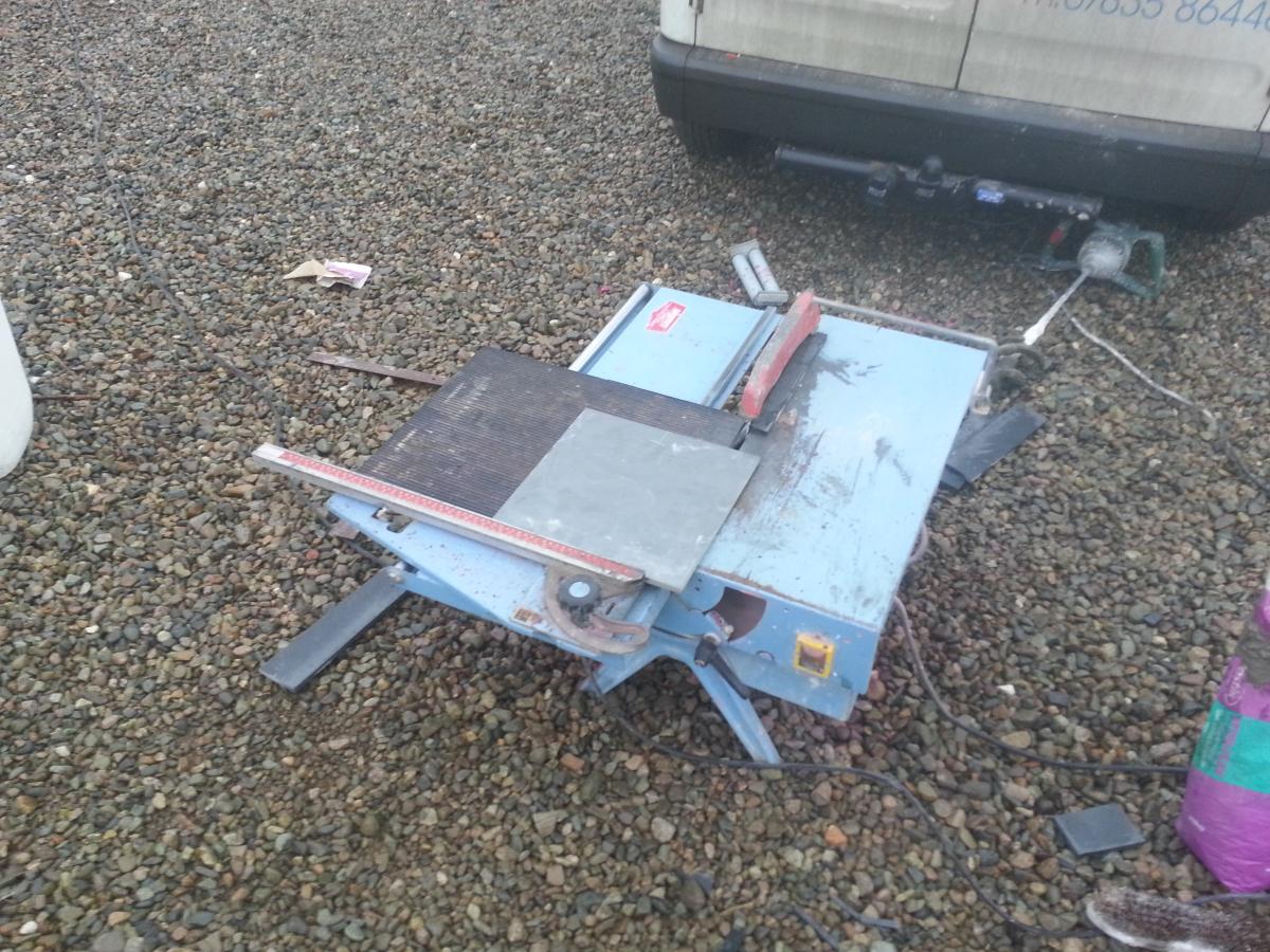

its a Rubi saw Jonny but after much research I dont think Rubi actually manufactured it as a lot of the early machines were made under liscense and branded rubi , I was told many years ago by a rubi rep i havent used this cutter on a job for over 3 years now , I still need a few new bits and it will be ready for work again
Spied a 10M on Gumtree and he accepted my cheeky offer after some hard negotiating. Gave it a day's work today to see what it could do but going to try and give it a tidy up over Christmas.
