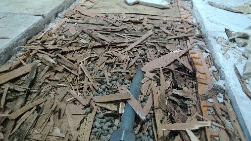

Brian, i have seen many floors and wall's which have failed on ply.
The tile often cracks over the joint in the ply if a good adhesive is used and the tile remains stuck to the wood.
The tile pops of the wood if the wrong adhesive is used.
If you are going to use Ardex adhesive, for instance, they say two layers of ply should be laid over each other with joints staggered and the backs and edges seal with polyurethane varnish.
Ply is not water proof and moves due to damp in building.
If ply is down and can not be replaced for, say, hardie board, that's why i use detra over the top.
A couple of pics of cracks in ply when tiles were stuck well to the wood, and what can happen when moisture gets into the ply, even with detra.
