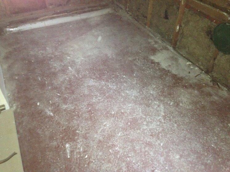

I have been asked to tile a floor in a bowling club toilet that I am a member of. In total the area comes to about 10 sqm.
The substrate is concrete however has been painted (several times) and then had some kind of epoxy resin put on top of the paint - we have no idea why! (see attached picture).

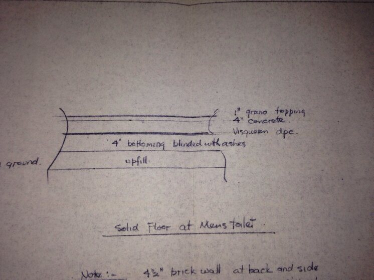

I have seen the original building plans from 1967/68 and the contrete floor us made up as follows (I’ve also taken a picture of the plan drawing) :
Upfill
4” bottoming blended with ashes
Visqueen DPC
4” concrete
1” grano topping
My first question is that I’m assuming the top layer(s) of epoxy and paint will need to be removed and taken back to the grano topping before any tiling can commence? If so, is it a case of plenty elbow grease or is there some kind of product that can assist with the removal?

I scraped a very small section with the end of a crow bar (was lying around from when they took out the existing fittings etc) and it came away with a bit of scraping back down to the grano. hopefully the rest of the floor will be the same. I would think a bit of a hoover and a prime will be in order after the paint layers have been removed.
