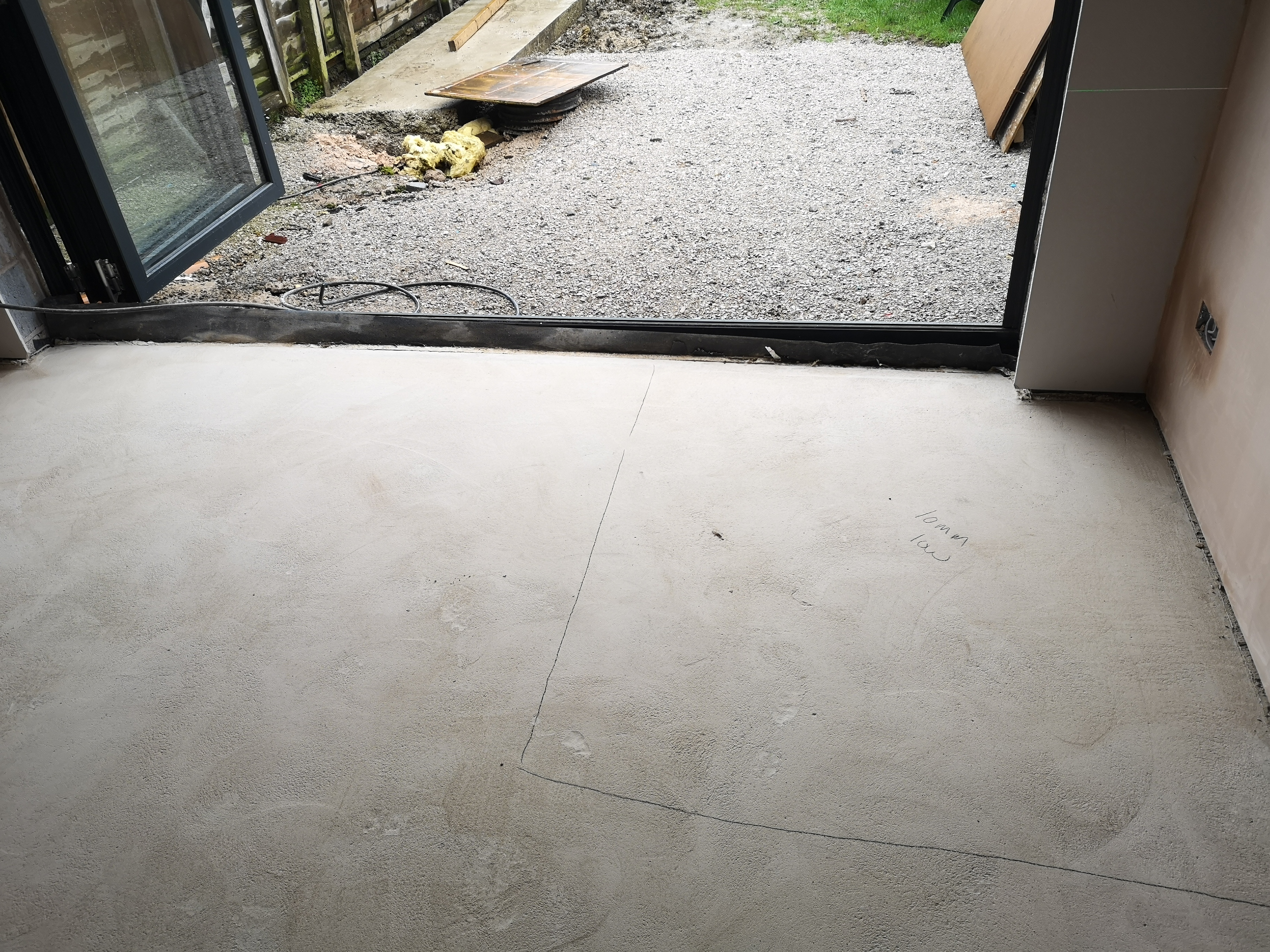

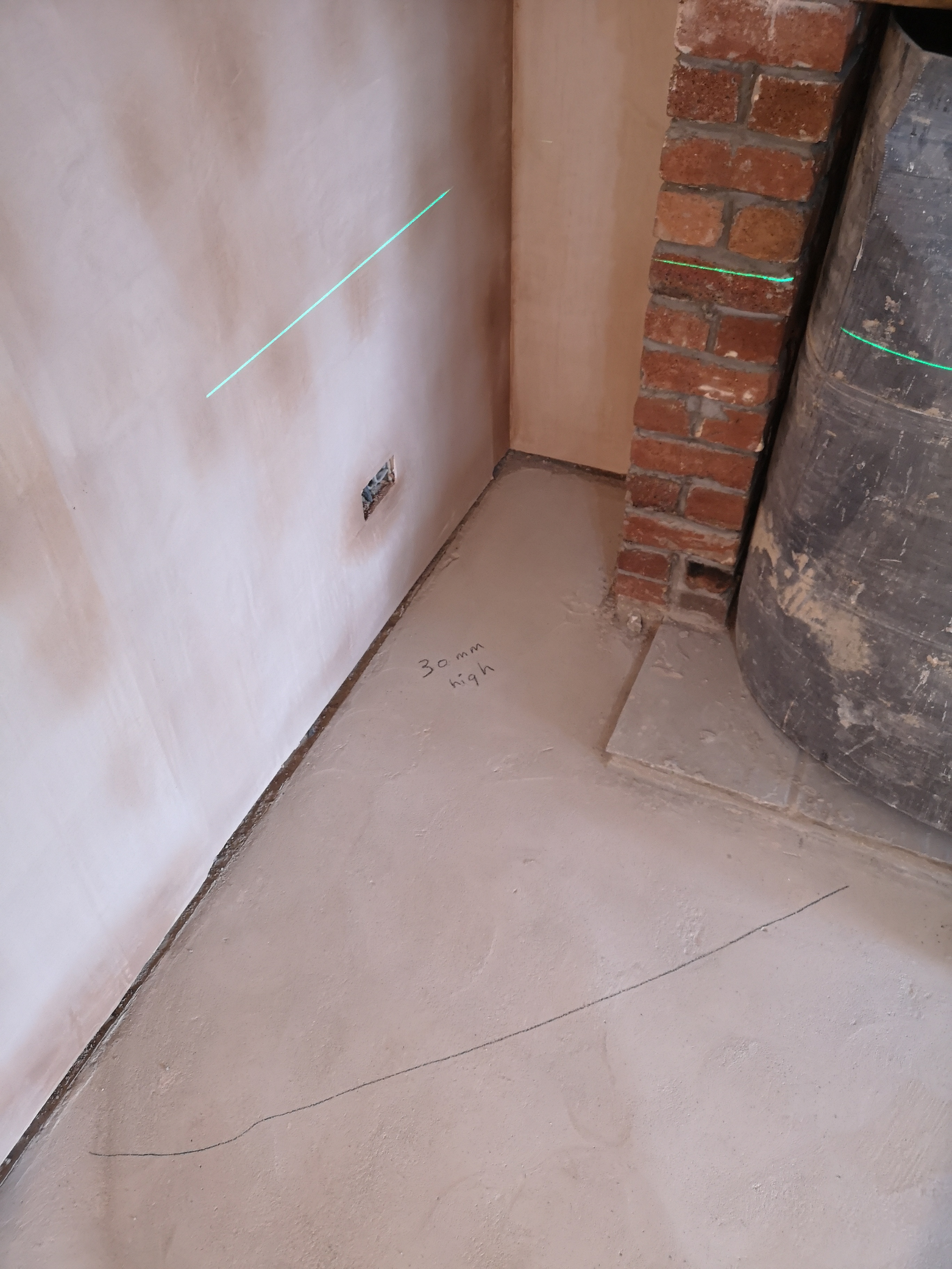

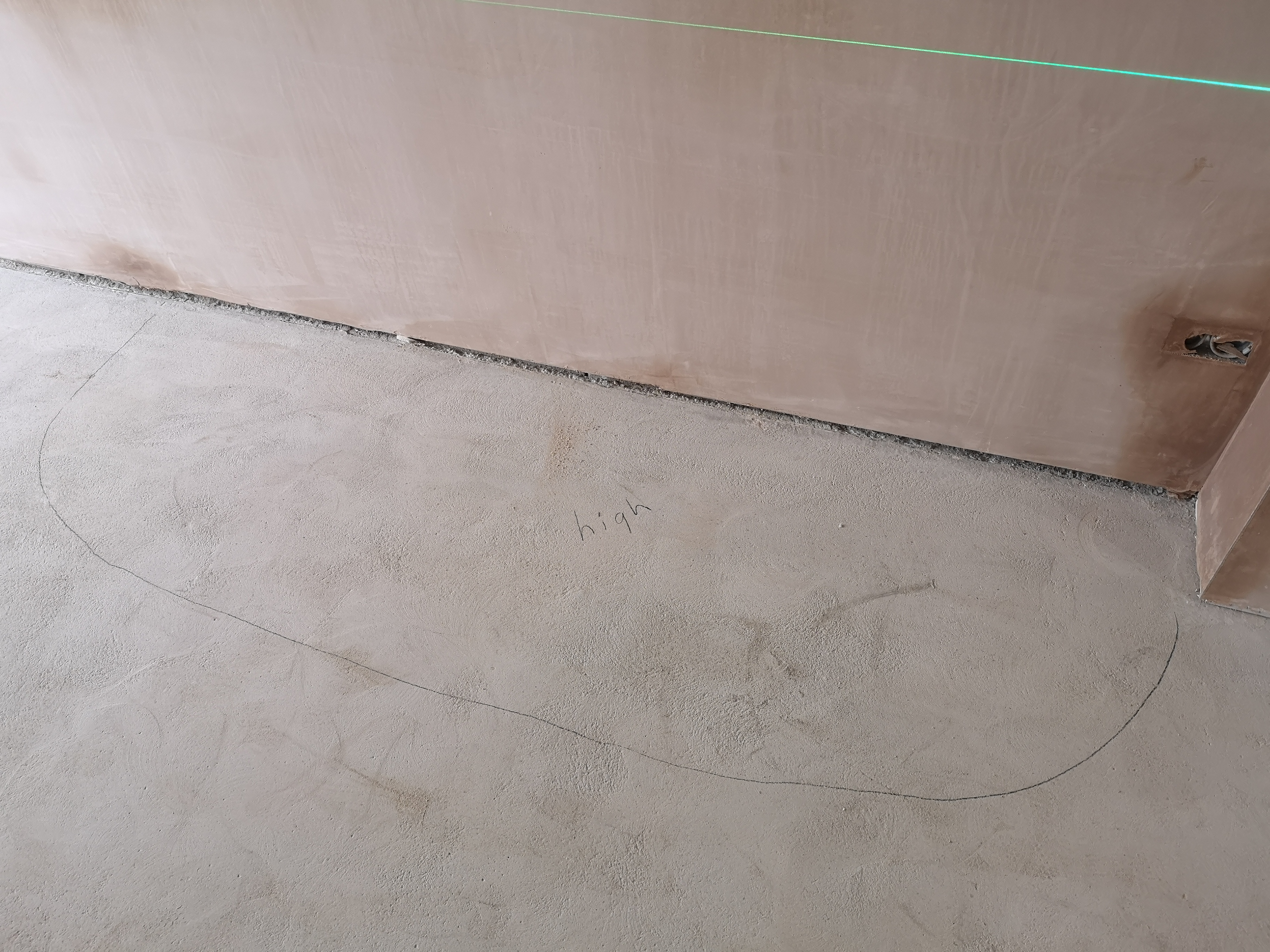

Been to remove laitance today on a floor for @Andystiletiling thought I'd survey it whilst I was there to give him a heads up on its condition. New anhydrite screed was high by nearly 50mm in one area, low by 10mm in others. Even had loads of boot prints in it !

Thanks for the heads up on the levels Andy, tile shop has been notified and a pallet of anhylevel will be on its way to site very soon and I'll sort it myself..hopefully to be claimed off the builder or screeders but if not customer will just have to suck it up..
