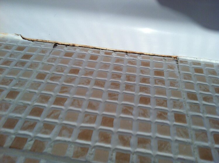

I would have issues with that mould in pic 4, how long has that Silicon been removed?
Try & cut out the grout with a stanley knife, be careful not to catch the edge of the tiles, Its a pig of a job, get out as much old grout as you can & make sure no old grout is standing proud then regrout.
It wont be a big grout line anyhow as the chances are these tiles will have been butt jointed(No NO) or a 1mm/2mm at most.

The Silicon has been removed for a couple of months. i keep meaning to resilicone but never seem to get round to it. Ill clean it up this weekend and do it. Is it just a case of scraping off Silicon and any Silicon sealant will do?

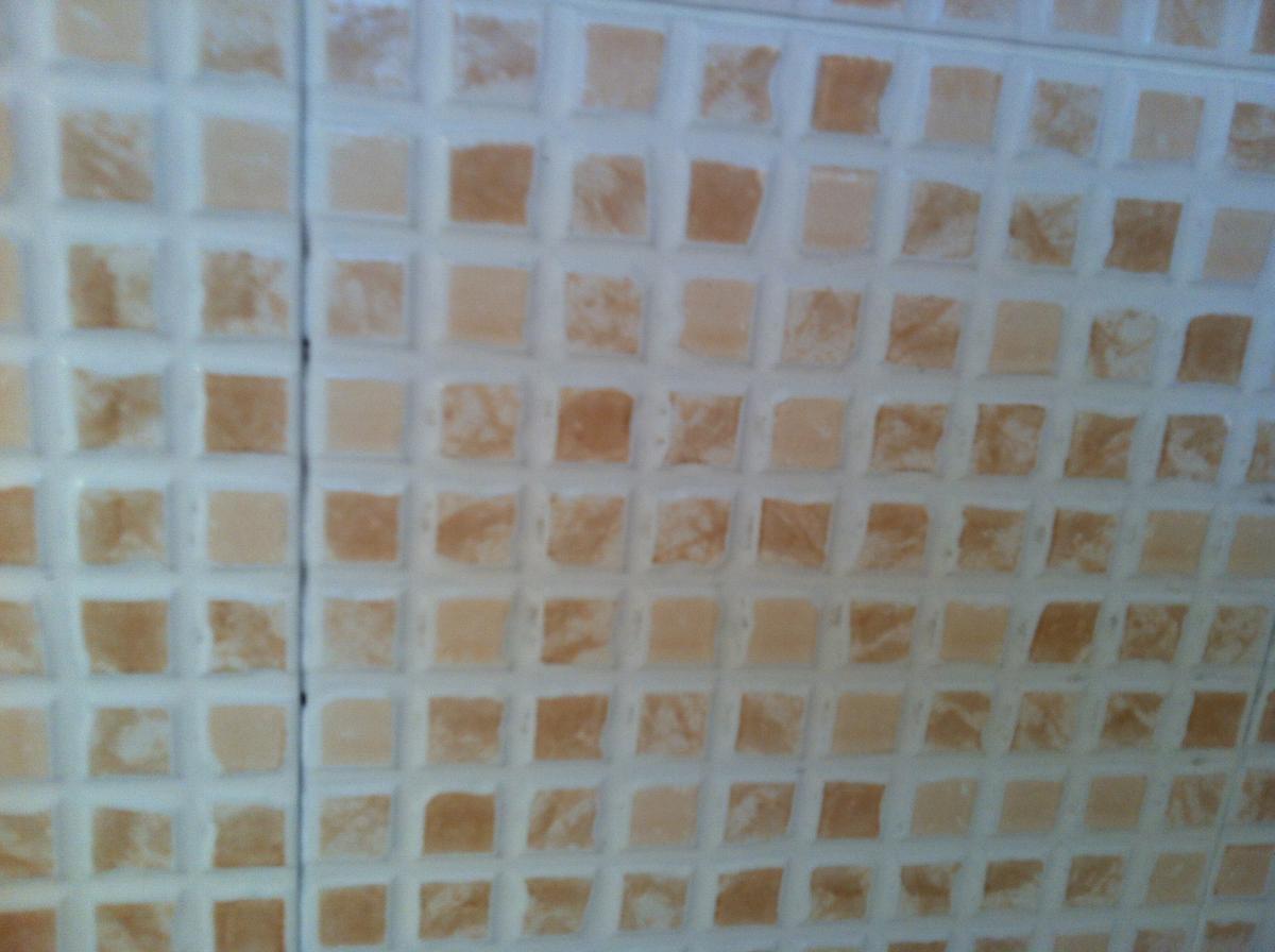

the tiles look like they have been fitted without spacers which could be the reason the grouts falling out , if you touch the grout up chances are it will just fall out again if theres not aleast a 2mm joint to work the grout into.
the Silicon round the tray needs to be removed completely befor its redone..

I couldn't say for certain but it looks to me from the images provided that spacers either weren't used or if they were they were only 1mm. These particular tiles are a good 8mm thick i think aren't they? (thicker than average certainly, because of the mosaic effect profile, any slimmer and the tile tille be weak where the "decorative" grout lines are)
I'll cut to the chase to avoid waffling as little man has had me up most the night and i'm dead on my feet.
(8mm depth + 6mm (min) adhesive) x 1mm grout width on a plasterboard wall = Never going to happen. I can't even see BAL microflex staying pretty in between those tiles. IMO i think you need to be looking at either re-tile, or if you want a temp measure take an angle grinder to the wall and cut the lines a bit wider to accomodate grout.
