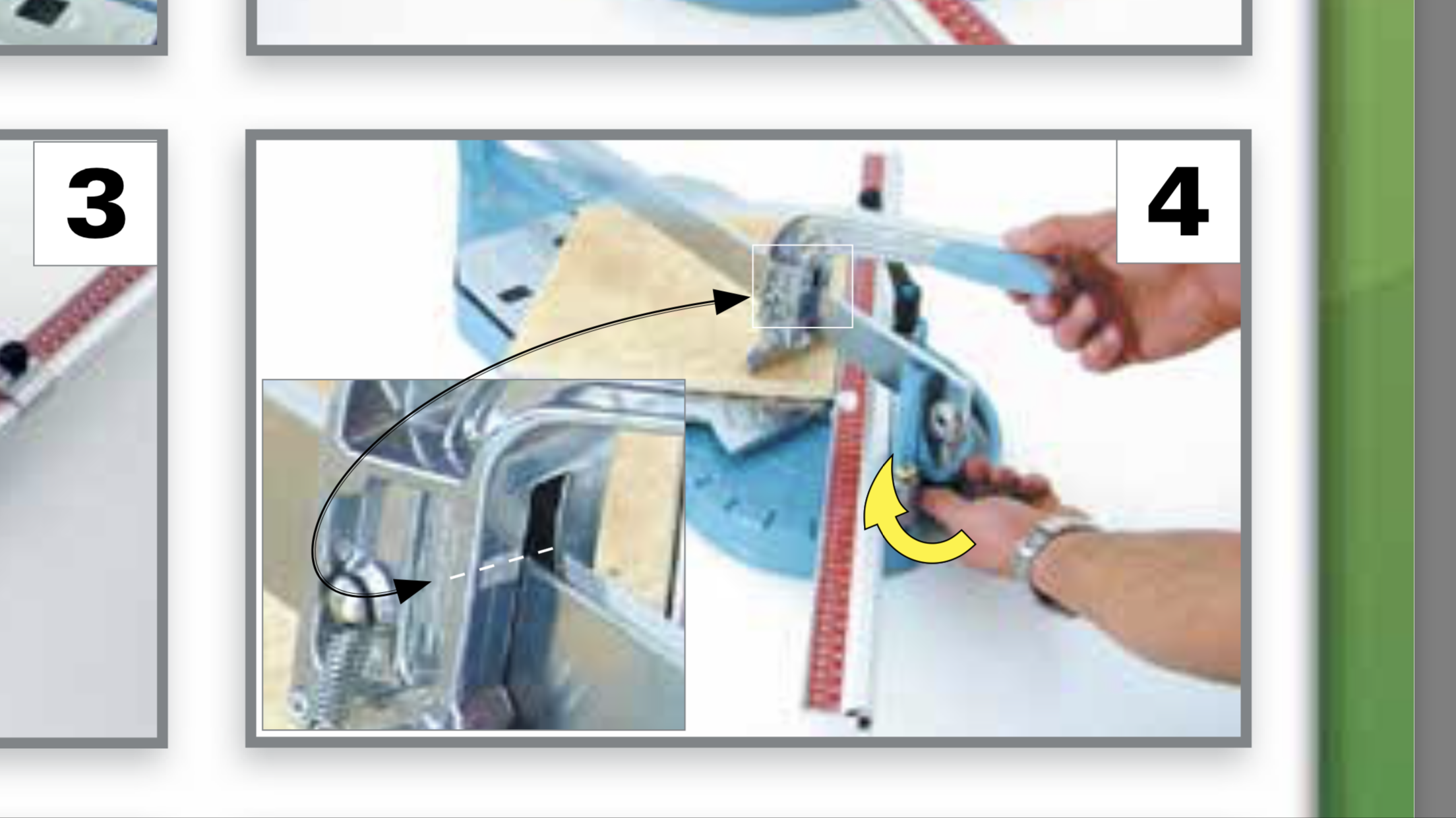

Have you been on the sigma thread I created? I can’t remember. The height adjustment has been mentioned a few times. Makes all the difference.
It looks like it.
I’ll be honest- I’ve not throughly read the instructions but I did adjust the height last week and it made all the difference. The cuts were far better. Give it a go.
It looks like it.
The manual isn't great. It's just a series of pictures. So I've adjusted the bar and every break is just breaking off the corner of the tile :/
Don’t forget to score back that first 15mm or whatever before you do your push score on the rest of the tile
Yup, been doing that every time. The manual also says to score the tile 2-3 times for tiles with rough surfaces (like the tiles I have) but it's just breaking off pieces of the slice I want to cut
