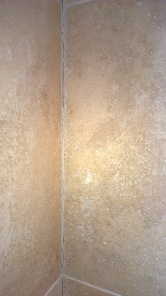

Oh dear. Sorry to have started an argument guys.
Anyway, I decided to spend half an hour trying to scrape it out last night with the thought that if it was too difficult I'd just give up and leave it. But it went pretty well so I spent an hour in the end and got most of it out and am pretty happy with it now.
As you say it probably wouldn't have made any difference, especially as I was going to go over it with Silicon regardless, but it's done now so I'm satisfied.

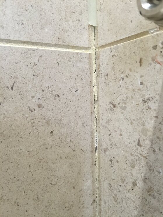

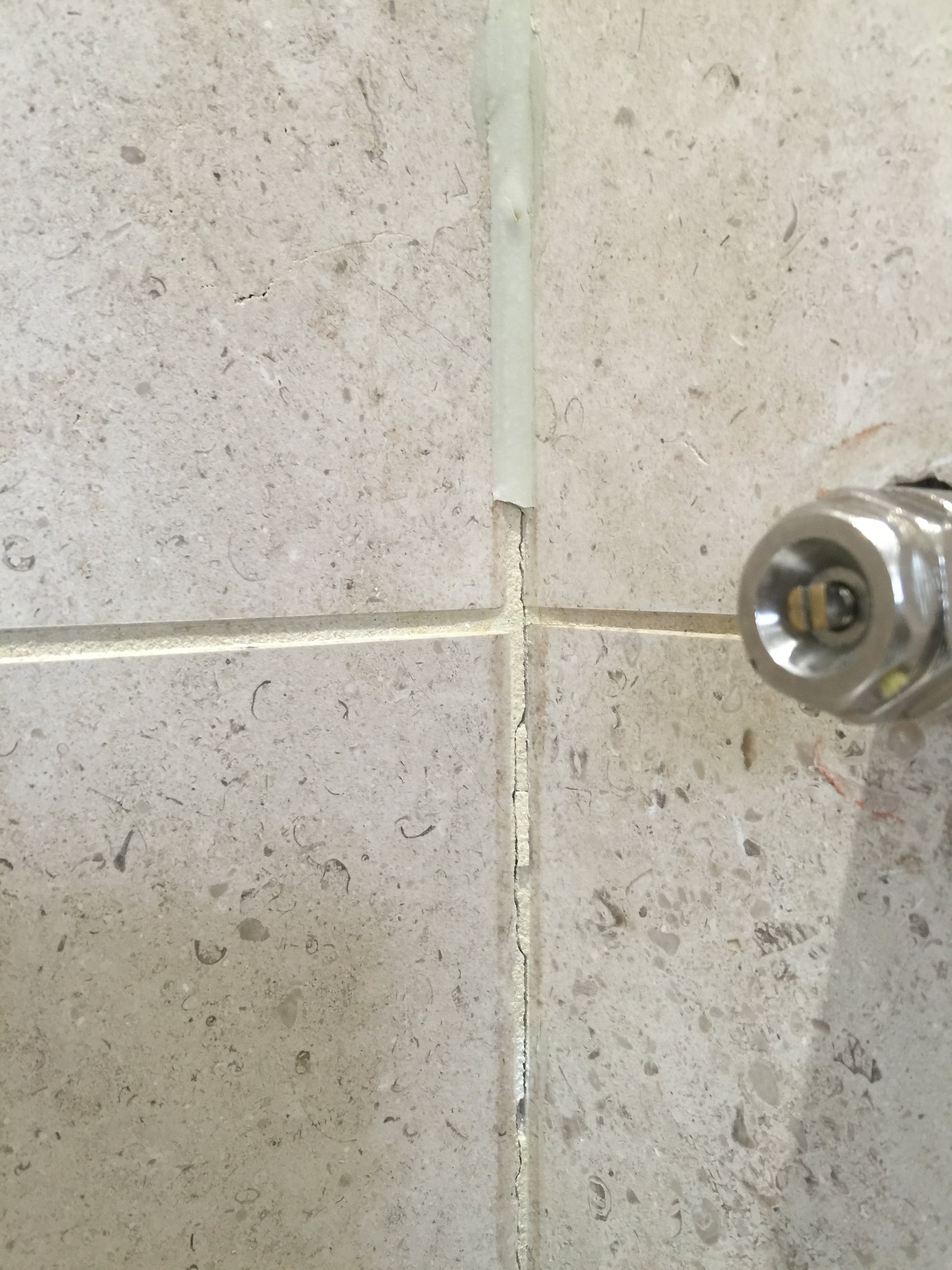

I hate to add more fuel to the fire too... but in my other bathroom it's grouted into the corners and has cracked (I didn't tile this one). See pic.
