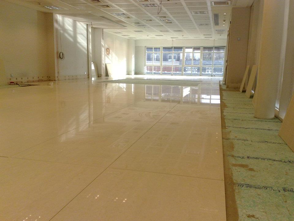

Looks like we have a winner. Can't see any reason that would not stick. Not sure a primer would be needed but I'd be guided by Ardex on that

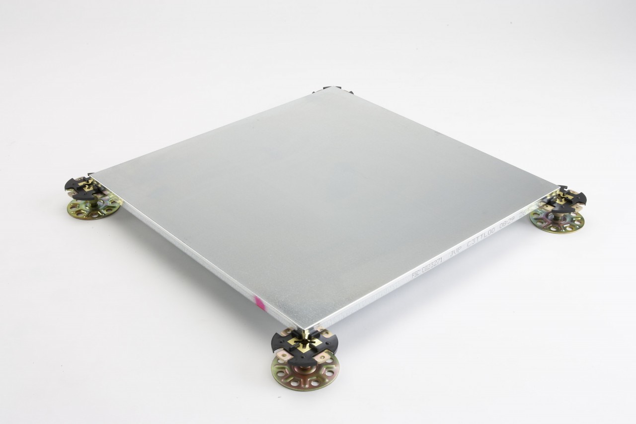

I think we talk about some product suitable to fix the tiles direct to the aluminium.

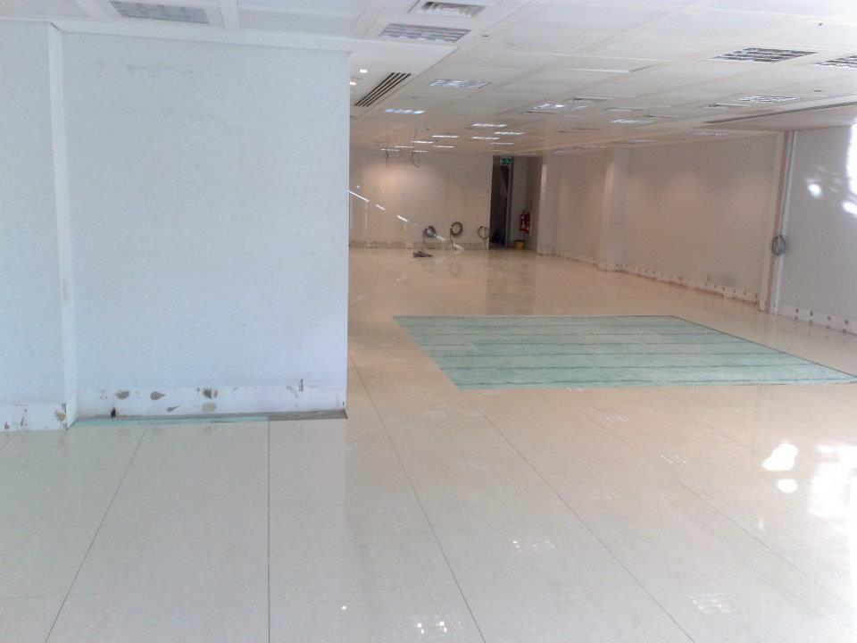

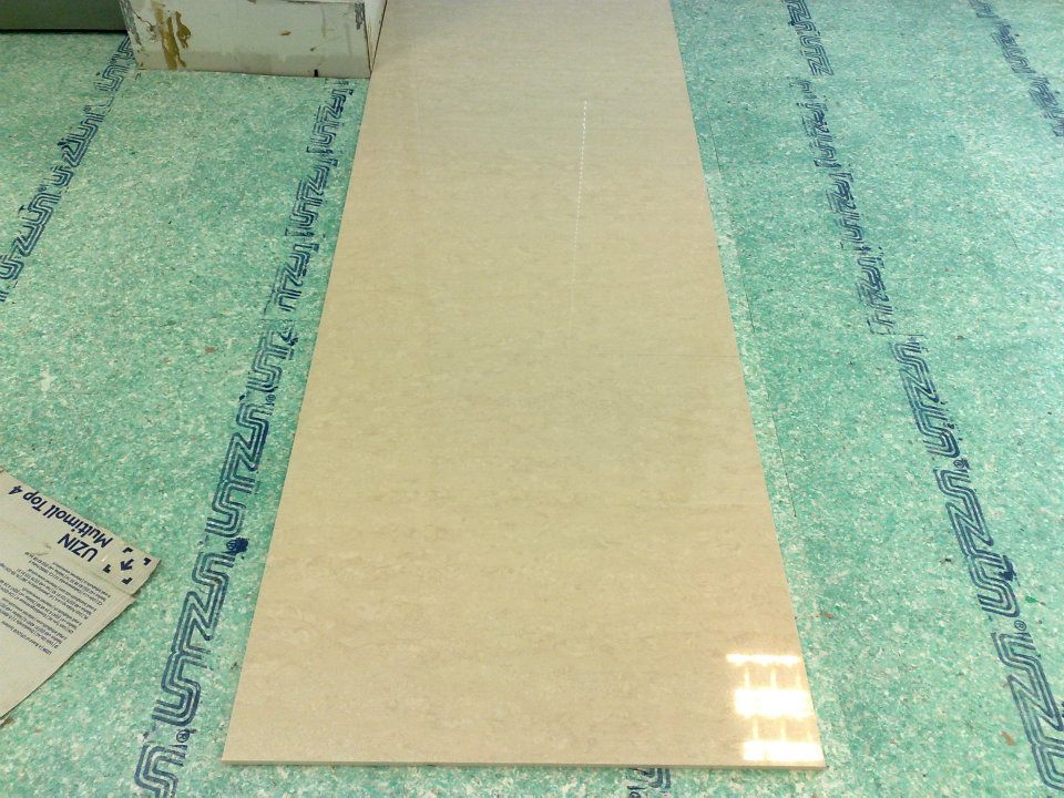

We do some office space over aluminium suspended floor but we use the panels from Uzin Multimoll Top 4 with KE 2000 S uzin 5.jpg uzin.jpg uzin 3.jpg uzin 4.jpg
