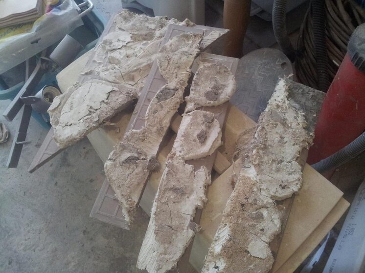

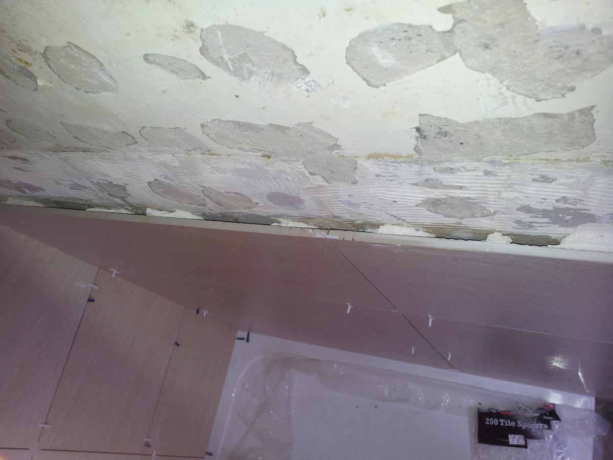

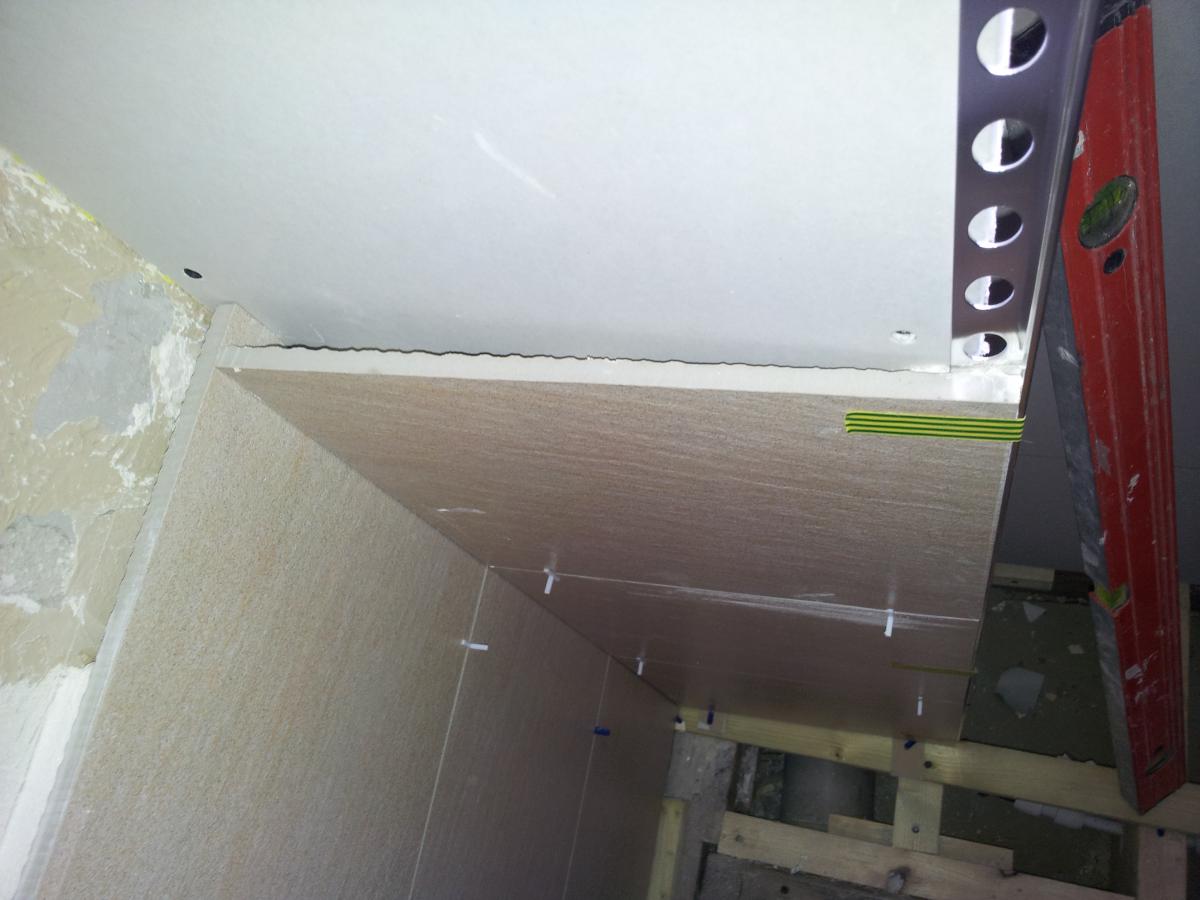

I recently told my Bathroom fitter to go away after I caught him Dot and Dabbing Tiles.
I am grateful for forums such as this for creating this awareness.
Attached pics of my bathroom, stopped and got rid on the spot!
Check out the Butting of Tiles.... what a joke. It's the old school mentality, they set in their ways and simply refuse to change.

is that paint he was tiling on to..looks very flakey.
It is the remains of Mortar on brick wall which appears to have some paint; I thought I removed all the flaky bits, but put my hand on it this morning and bits started flaking off again.

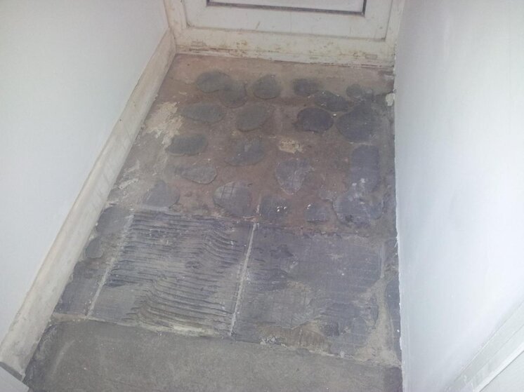

Got asked to do a little extra on a job today. Just a small entrance way. Tile over the tile they said !!! When I swept the rubbish off the tiles I could hear they were hollow. So pulled most up with my fingers and a gentle tap with a hammer got the other 2 that had been spread up..... Level floor tomorrow and then retile.
