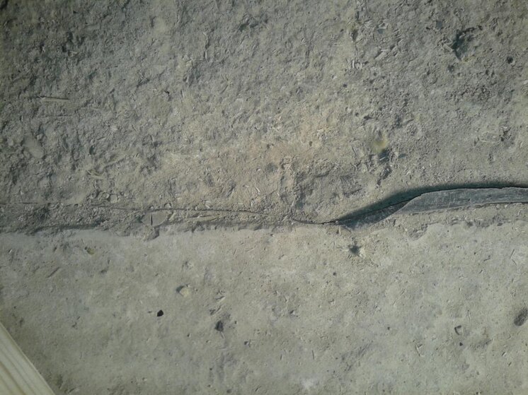

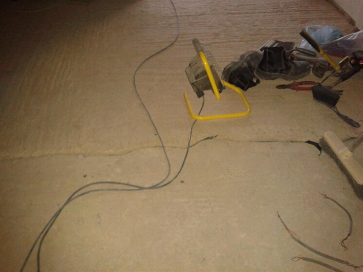

I need to prepare my kitchen floor so that it can take tumbled/chipped edge trav and need a little advise.
The area is approximately 5 x 4m2, and the current concrete slab is split into two parts. Each part of the slab was poured at different times (they were previously two separate rooms).
The slabs have been down at least 5 years, so are stable, and were previously screeded with sand/cement which came up with the previous floor tiles. The previous screed was about 50mm-70mm thick (head height is an issue is/was an issue in the room).
There is a 7-10mm different in height between the two slabs, but this varies along the full width of the join (4m wide).
My plan is to screen the whole lot in a single pour of F-Ball Stopgap 300HD SLC, and have calculated that 12 bags should do the job. The slab is quite level, it's just the height difference which will swallow quite a lot of the SLC. There is also a low point in one corner that will need probably 12mm-15mm.
I have taken some pics to try and show you the area, but they are only happy snaps - sorry about the poor quality.
Question is, is my plan to try and fill the area with Stopgap 300 and tile onto this a wise one, should I be concerned about the split in slab under the SLC moving and cracking tiles and finally, from your experience will this take more than 12 bags?
The materials involved are expensive and I want to get this one right.
Thanks in advance for your help :smilewinkgrin:

Repairr that chasm first before you lose a small herd of goats down it and they give you greif for years to come. That crack will reflect through whatp ever you put on top of it if you dont. A low viscosity resin stictch should do the trick.
Thanks for the reply.
The angle of the picture doesn't help, there isn't really a chasm, the two joints butt up against each other. There is just a height differential.
I haven't seen anything about a low viscosity resin stich in my research, is it quite common to use this method? I did consida Ditra matting as I have used this before, but at 20m2 it will add significant cost.

Is it not possible to have a grout line over the joint and use colour match silicon in the grout line as an expansion joint?

That looks like a crack and a half. It will need repairing if you are planning to slc over the top of the crack or as Mike has said a movement joint over the top of it.
It's not so much a 'crack', it's the join in the 2 substrates. They are stable and about 4-5" thick - just different heights.
There is no gap between the joints, the picture is very deceiving - apologies for the poor quality.
