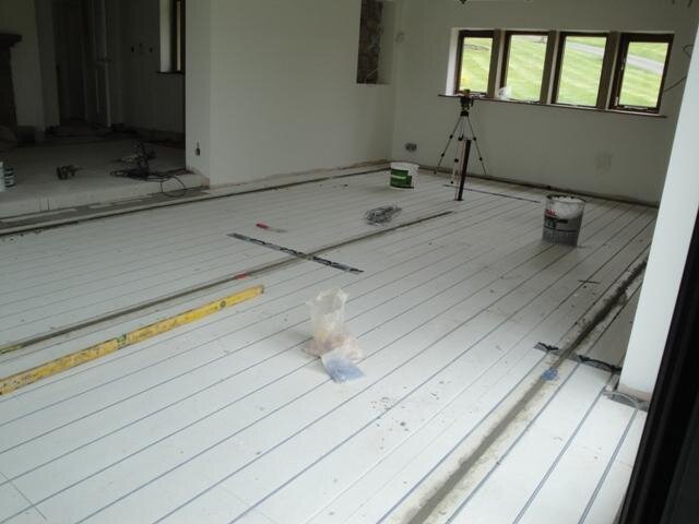

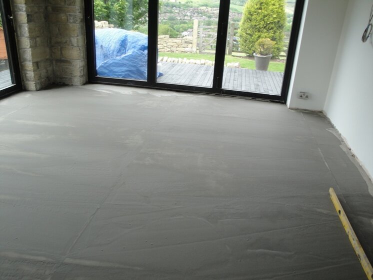

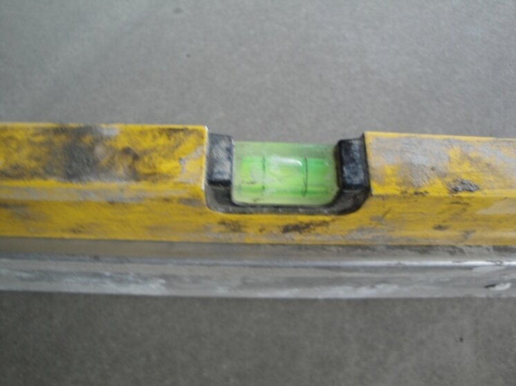

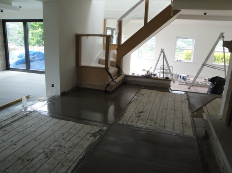

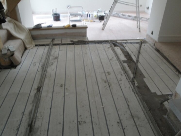

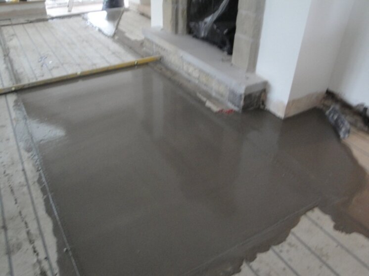

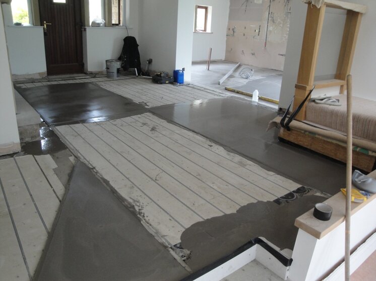

I am doing one atm, will get some pics on. This is the way I cope with bad floors, these are old pics, but give an idea of my method, Runners set with laser, formed with polymer sand/ cement/ sbr/ rapid set adhesive, concoction
