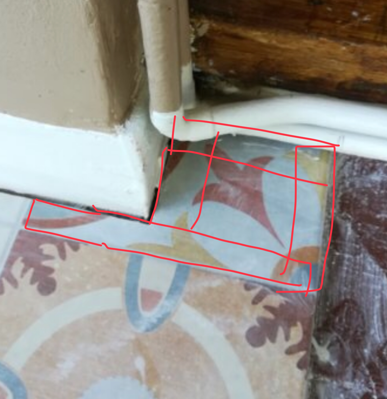

Awkward angles no right angles... Is there a better way than templates with paper
Simplest way for you to make a template is to cut thick cardboard in to inch strips, (tear up an old box or something) once you have thin strips, trace the outline of the space with your cardboard and either tape or use a glue gun to stick strips together.
You will then end up with the exact shape that the tile needs to be.
Something like this. As they’re small tiles, cardboard will be stiff enough, or anything you have to hand, just not paper.

I only dry lay and cut what area my bucket mix will lay, I lift each row of tiles in the same sequence with the tile I place on on top the one I will lay First off on that row, if that makes sense, you can get a number of angle finders which save making templates but for normal externals and internals just do as Plan tec says.
